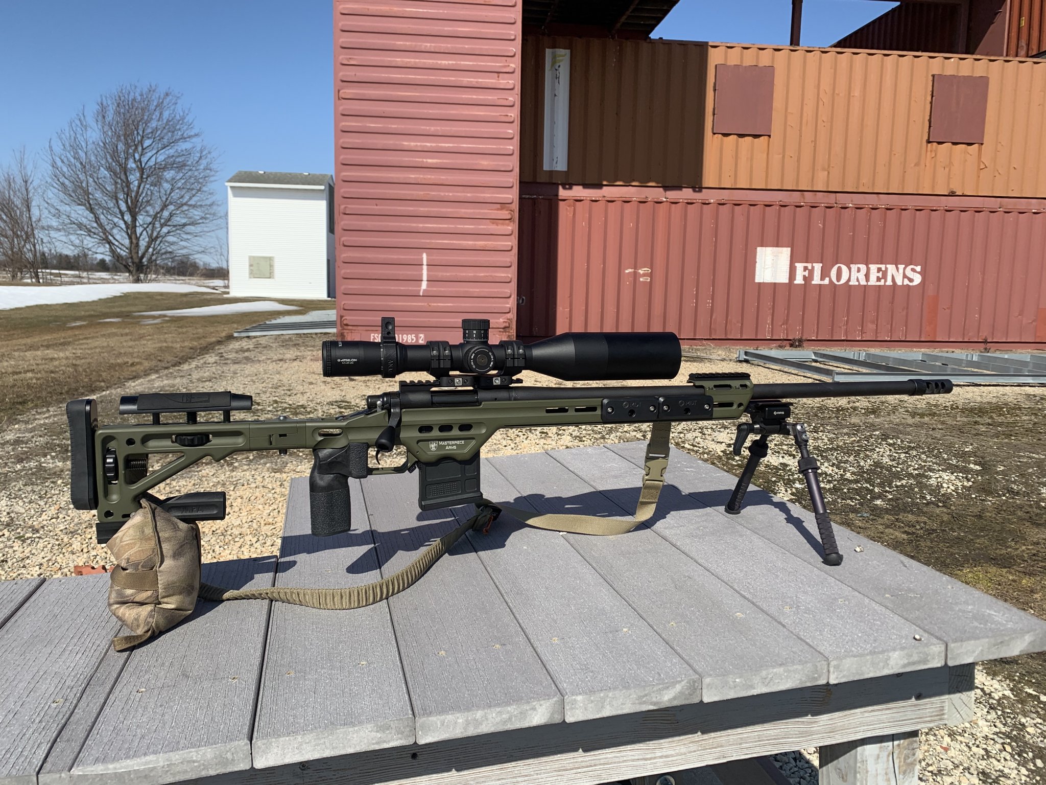

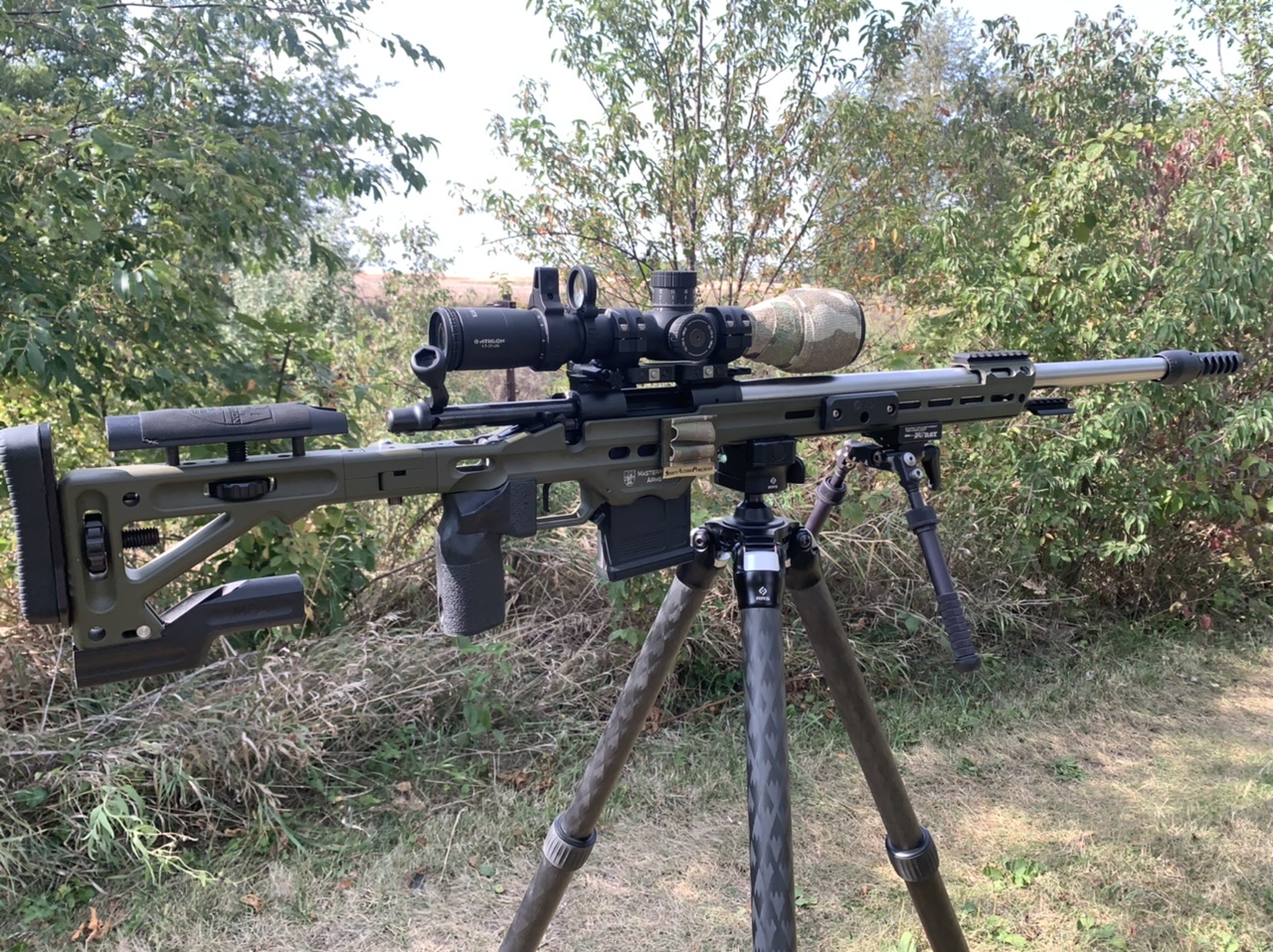

I've built a bunch of rifles using repurposed and worked-over factory Sendero, PSS, and Varmint barrels on 700 actions.
If you're wanting to verify true, I'd have it blueprinted. It's not that expensive, and if they're already working on the rifle, it won't add much to the cost, but will add peace of mind in the end knowing it's trued. 👍🏼
If you are reusing the factory barrel, have the lug shoulder trued in a lathe, and the threads chased. Have the bore hand-lapped. Have them cut a thread or 2 off the barrel, and then re-cut the chamber with a nice sharp fresh match reamer to verify spec and headspacing. Have them thread the barrel 5/8x24, and then cut an 11º recessed target crown. Make sure everything done to the barrel is done bore-centric. Spin it back onto the newly blueprinted action and check headspace.
I'd have them cut the bolt knob off and TIG weld a tactical bolt knob while they had it, but that's just me. Then have them cerakote the whole thing 1 matching finish. 👍🏼
If your smith charges you a lot to do all the barrel work on the factory barrel, then you might end up cheaper to buy a nice pre-fluted Bartlein 5R blank and start from there, get the action blueprinted, and then have the whole rifle cerakoted after reassembly.
My smith doesn't charge much at all, so for me, it's cheaper to get it all done than just the price of a new blank... So, we'll leave it at that. Haha But most folks will charge a fair bit for all that work. But it will make a factory barrel shoot nearly (and in some cases, just as good as) a top-tier aftermarket barrel, because at that point, you have done most of what is done to those aftermarket barrels that is NOT done to a factory barrel on a mass-produced rifle.
Those custom touches are what makes an aftermarket barrel higher-quality than most factory barrels. And a chunk of steel is a chunk of steel, and if the same processes are done to each, it should narrow the gap of performance significantly. Which has been my experience working-over factory Remington barrels and accurizing them.
Some folks will still be snobby about it and say, "It's still a shitty factory Remington barrel..." which, once fully worked-over, is NOT the truth. But it is what it is. The proof is in my groups. And that's all that matters to me. 👍🏼

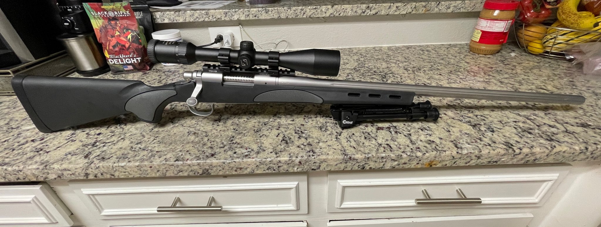

Which version do you have? If yours has the plastic stock I'd definitely change that out first.
I just picked one up off gunbroker for a steal. The older one, non-stainless version, in a factory tan HS precision stock.

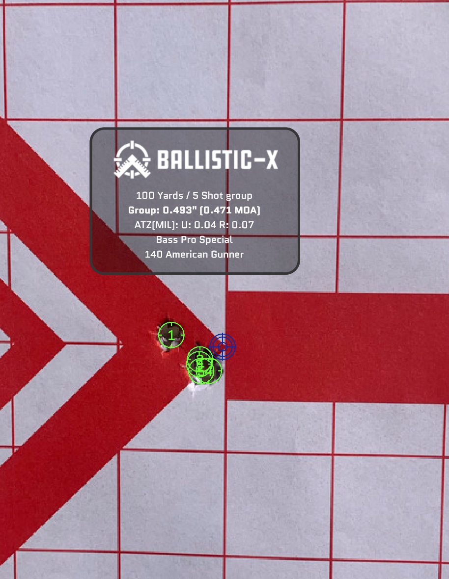

This started out as a Bass Pro Special Rem 700 Varmint with the flimsy stock. Got it on close out for ridiculous cheap. Dropped it into an MPA:
shot pretty well with the factory barrel after it was trued:
But like most projects it got a little out of hand. As it sits now:
I have shot it out to 1100yds, going to 1200 next weekend.
