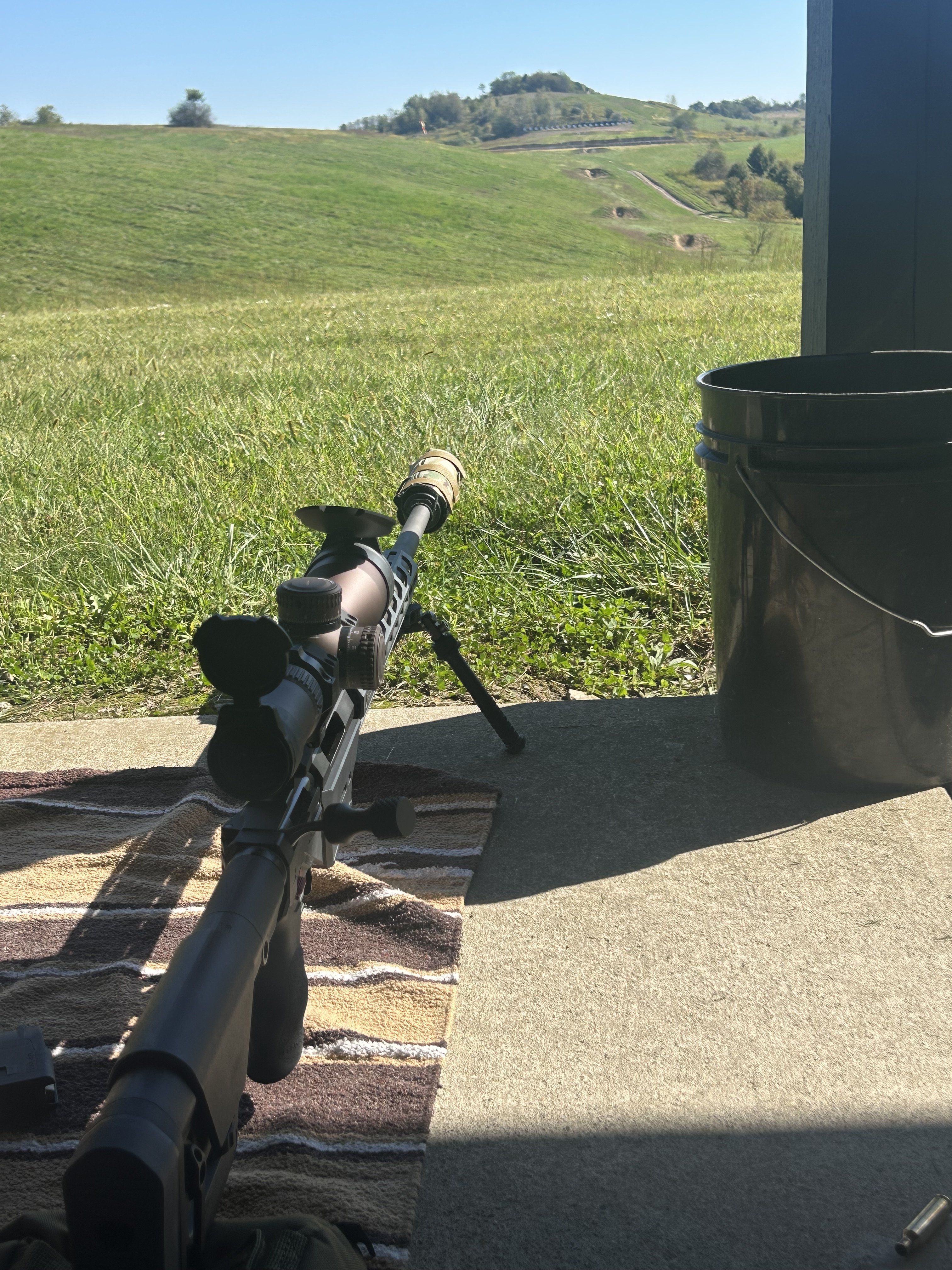

Absolutely love my Custom shop RPR in 6.5cm, it’s ridiculously accurate and have taken it out to a mile on multiple occasions. Ruger has also taken care of me in the past with other firearms in the warranty department with zero questions asked. You could also look at (alittle more expensive) the Seekins Havak HIT. They have a quick change barrel on them which looks super nice if you wanted to get the 6.5cm and then have a .223 barrel as well (but looking at more money). Seekins also has legendary customer service.
Food for thought, the RPR can take the same mags as most AR10 (in case you ever wanted to get one). I have a Seekins SP10 and can swap magazines back and forth between the two which at the end of the day isn’t a big cost savings but convenient.
