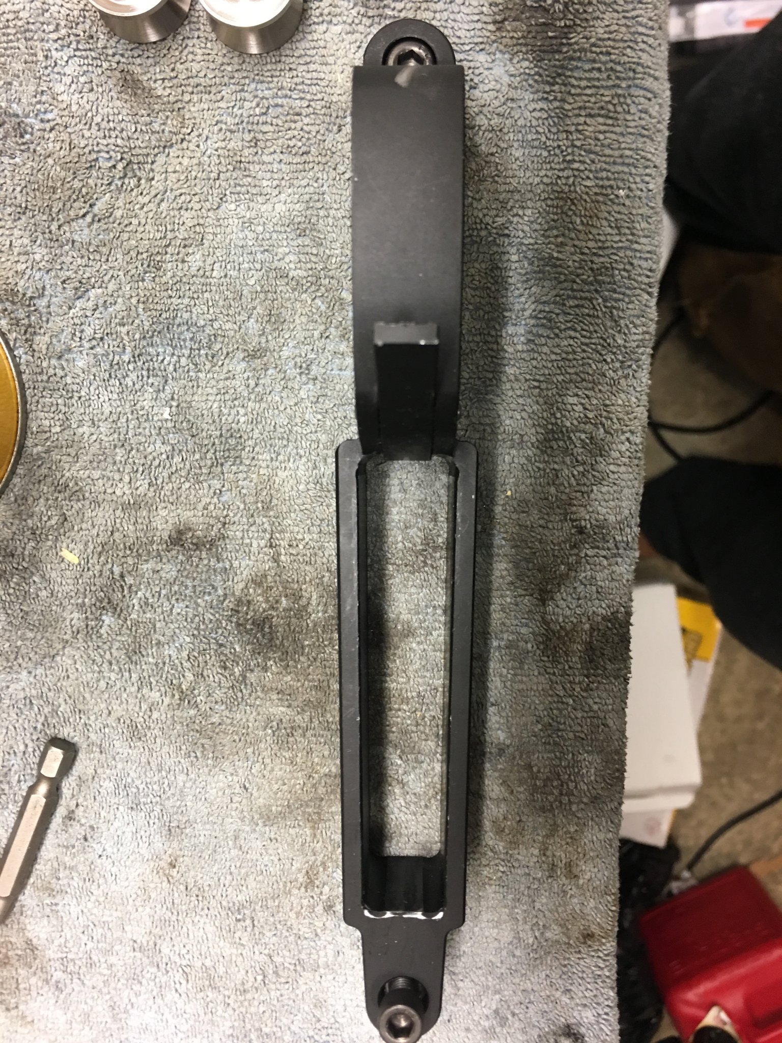

I have an atlas worx dbm that I inlet by hand for a LA HS precision. I had some trouble getting mags to work and ended up having to shorten the mag release on the inside by a touch. Just knocked a little off with a flat file and it was good to go. Definitely a decent budget friendly option in my opinion. Just be careful with inlet work. I used a Dremel and round file and the stock looks ugly. Functional but ugly. I keep meaning to go back and bed the dbm and paint the stock but it hasn’t happened yet. Good luck!

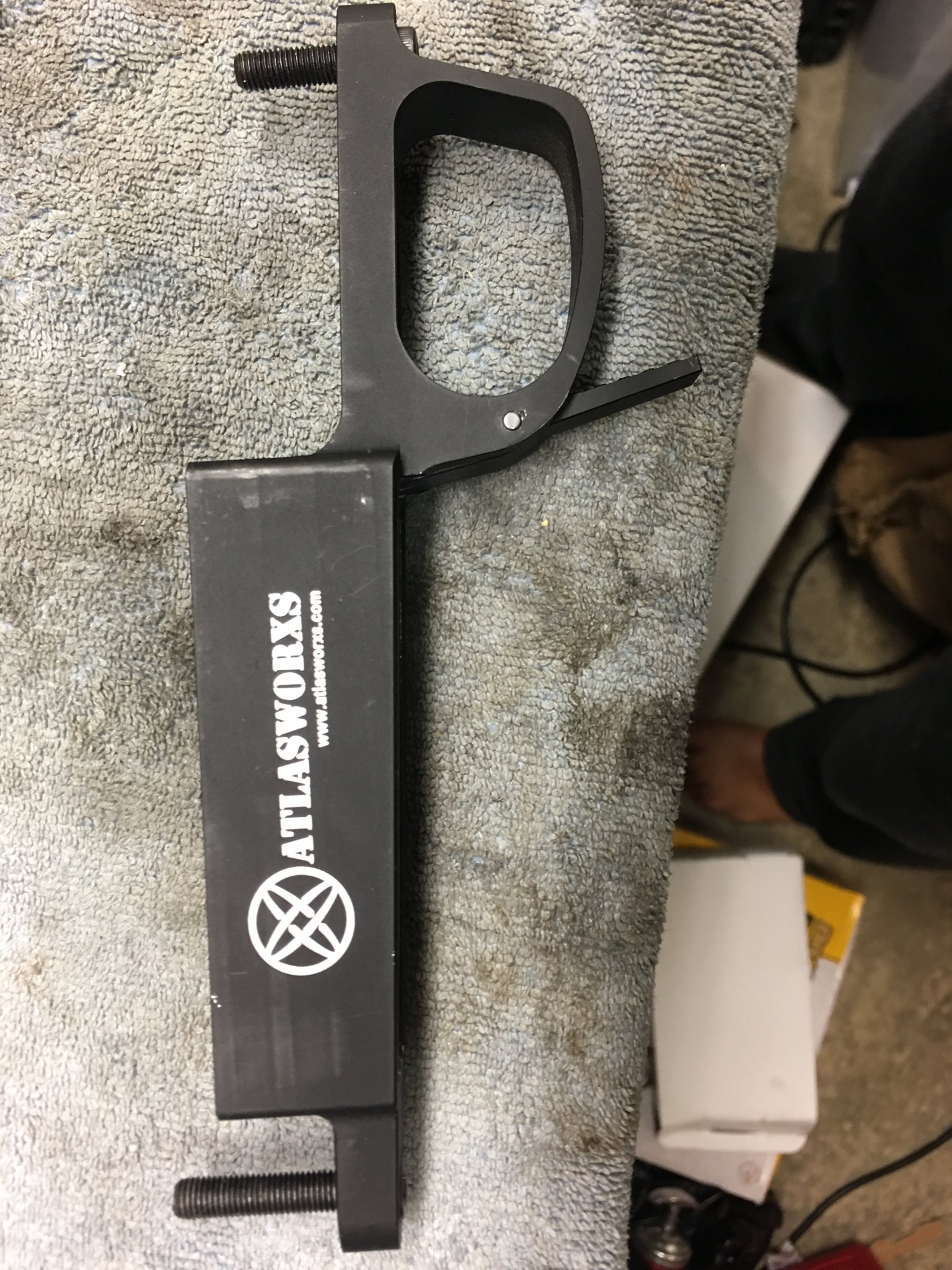

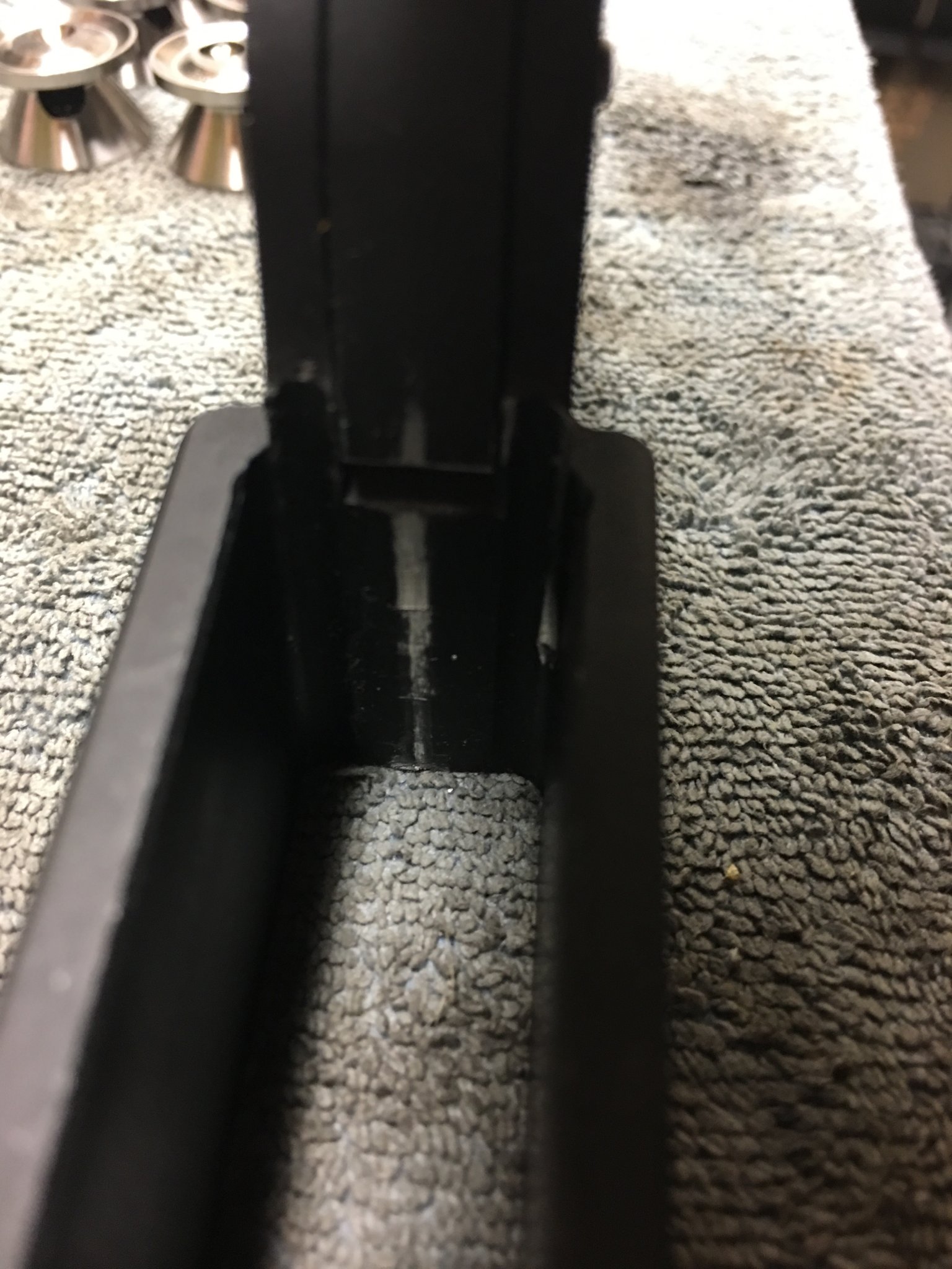

Here are some pictures of mine. If you look at the third picture you can see inside the mag well. That is where I trimmed the mag release.
Thanks for the pics mate , that’s the standard model so it’s good to know that it didn’t require much work, the elite should be a bit less hopefully
