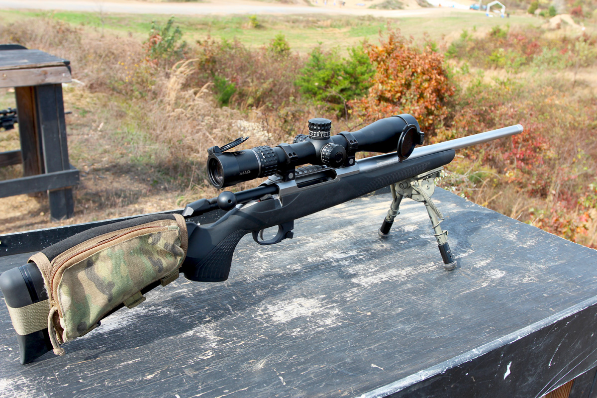

Looking to purchase a rifle for 600+ yards target shooting. I have the option to purchase a slightly used Remington 700P ($1100) 26" fluted barrel or new Savage 110 Precision MDT chassis 24" barrel ($1285) both in 308.
Which would be best for a beginner long range shooter? Thanks for all comments!
Coming from someone that's shot various Remingtons, Savages, Howa, FN's, etc...Tikka T3X is the way to go fo sho. It's a better gun out of the box overall in terms of quality, accuracy, trigger feel, the only downside is the non-existent customer service on Beretta's part. That being said, many smiths know how to work on them now and there are numerous aftermarket parts options now so I don't see that as a deal breaker.

I'm a die hard remington 700 fan. But your gonna have to dump money into it more then likely to make it shoot.
I've got a 700 Police model and I've had a 700 SPS varmint model.
They all have ridiculously long throats. I'm loading 178's at nearly 3 inches just to have a 20 thousands jump.
Get a tikka

My own experience only includes Remington, Savage, and Ruger.
The 700P was very good, but Remington quality was spotty.
The Savage 110 (over a decade past), was also excellent.
The Ruger 77 Mk II 308 was my most preferable.
My current goto LR 308 is a Savage 11VT with a Choate Stock, and adjustable cheek piece. The package scope and mounts were below par, and I replaced them. This rifle does all I ask of it.
Greg
Like others have said, Tikka over those two, better factory trigger, smooth bolt, barrels can be on the slower side but are accurate. I have three Tikka's, one savage and no remingtons.

One potential advantage of the Remington, or new Remarms Remington 700 is the feed ramp is already cutout for binderless AICS mags. I haven't confirmed it but a LRH member did. All the barrels are now 5R. A Varmint ADL is around $600, add a KRG Bravo for $400. And the new 308 Win barrels are 1-10" twist. It should come with the new Impact Timney trigger. My 7mm RM ADL did and it breaks at 3lbs 12oz.
Reactions: Dirty D
Almost a 4 lb trigger, my tikka's are about 2 lbs, with a spring change it's less if you want it lower. All my tikka's have bottom metal that uses AICS mags. Manners, XLR chassis, German Gun Stock.
So far the fastest 308 Win twist on a Tikka is 1-11". I'd rather have a 1-10" or faster. Also the closest barrel length to compare to the Remington (26") or Savage (24") is the Tikka T3 Super Varmint .308 win (23.7") which is $1499 @ Eurooptics. I could add a Geiselle trigger to the Remington and still be $200 cheaper.
What drove me away from considering a Tikka, and towards the Howa was:
1. Tikka requires a pin of some kind to disassemble:
2. Tikka has a removable bolt handle, which to me is just one more thing that can go wrong.
3. There are no Tikka stocks that I like, so no matter what I buy I am paying for something I don’t need.
4. Beretta customer service has a bad reputation.
YMMV.
-Stan
