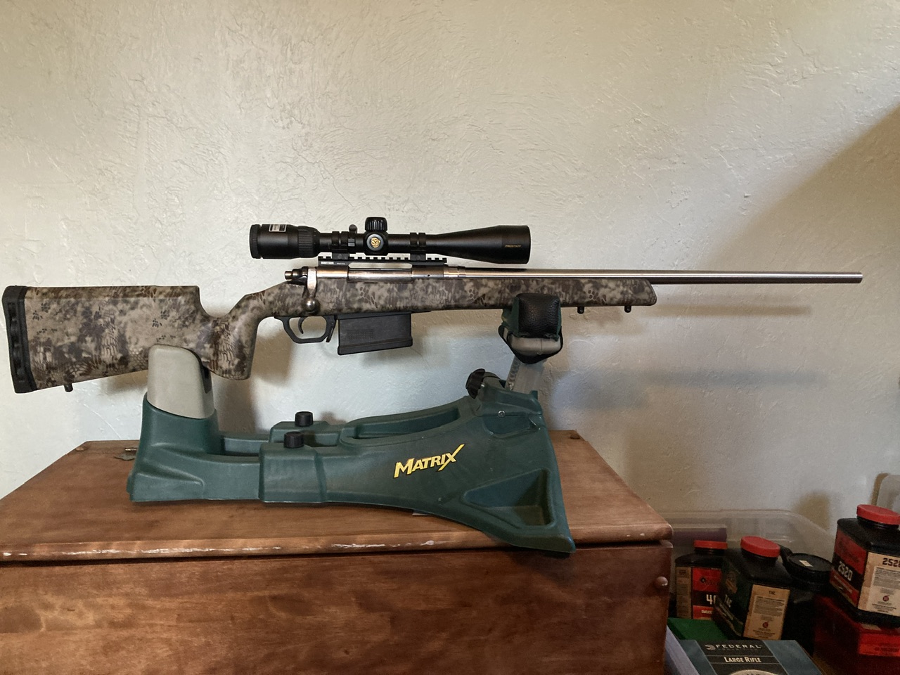

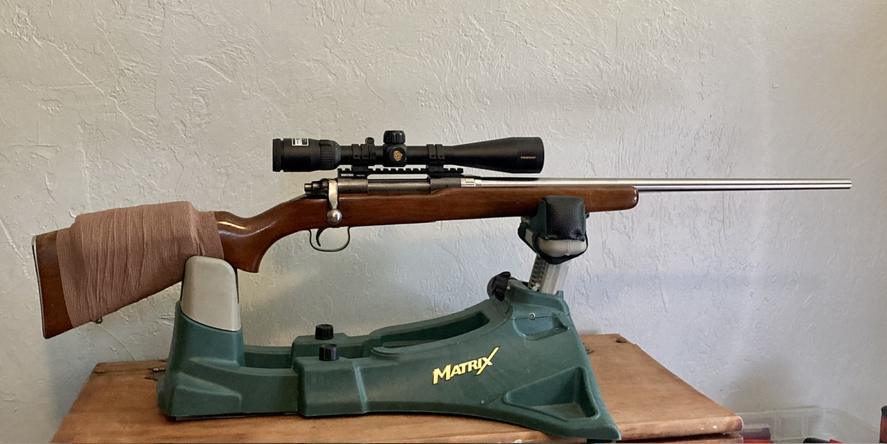

I have a Rem 721 action with Stocky’s REM 700 stock and Magpul magazine. I didn’t want to do that much inletting work on the original wood. It is easy enough to get a Rem 700 long action stock to fit the 721. As others mentioned, around the bolt handle needs some work.
Here is mine in two different configurations. I’ll be hunting with it next month with the wood stock , then put the other stock and magazine on the rest of the year for the range.
