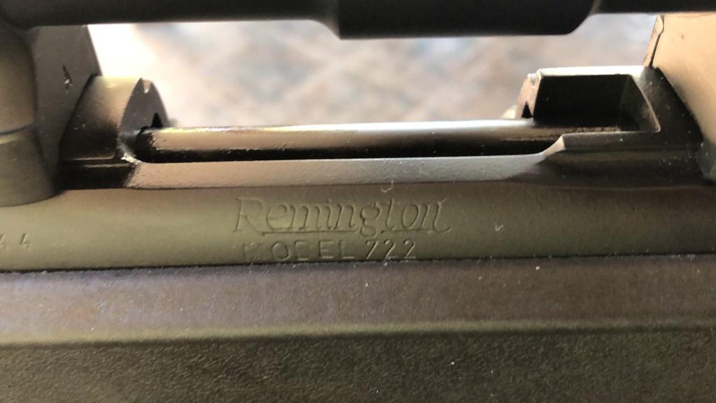

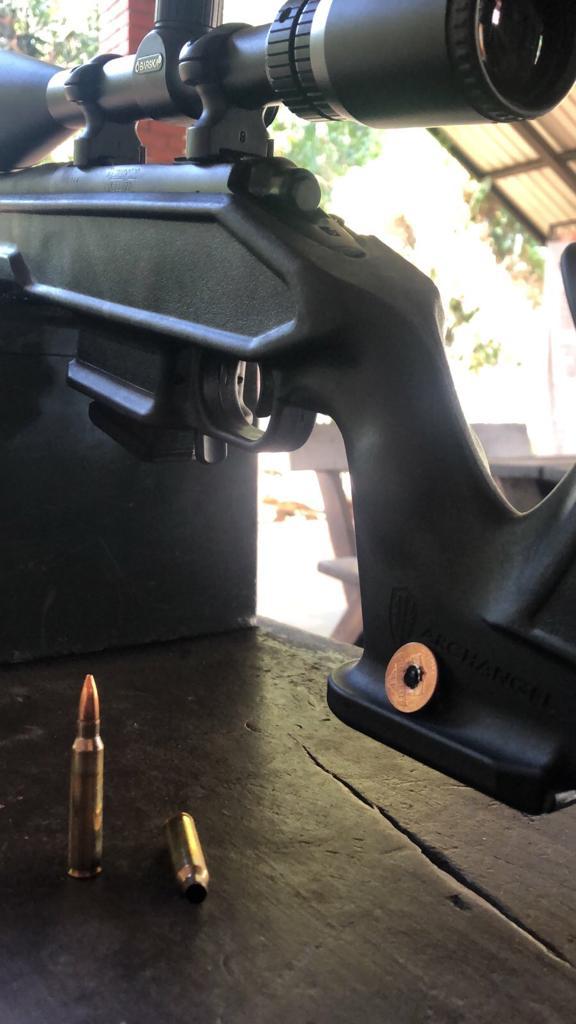

It is a very good action to build a long range 5.56 rifle, assuming your caliber is .222; you can convert it to .223 or 5.56.
Since you can install any Remington 700 .223 barrel on your Remington 722 .222 caliber, without further adjustments. It's easy to build a good precision rifle; It does not necessarily require the work of a gunsmith, although if you can afford it will guarantee better results.
The second thing to do is mill a good picatinny rail on the receiver of the action to improve accuracy.
The rest is just selecting the accessories of your preference.
