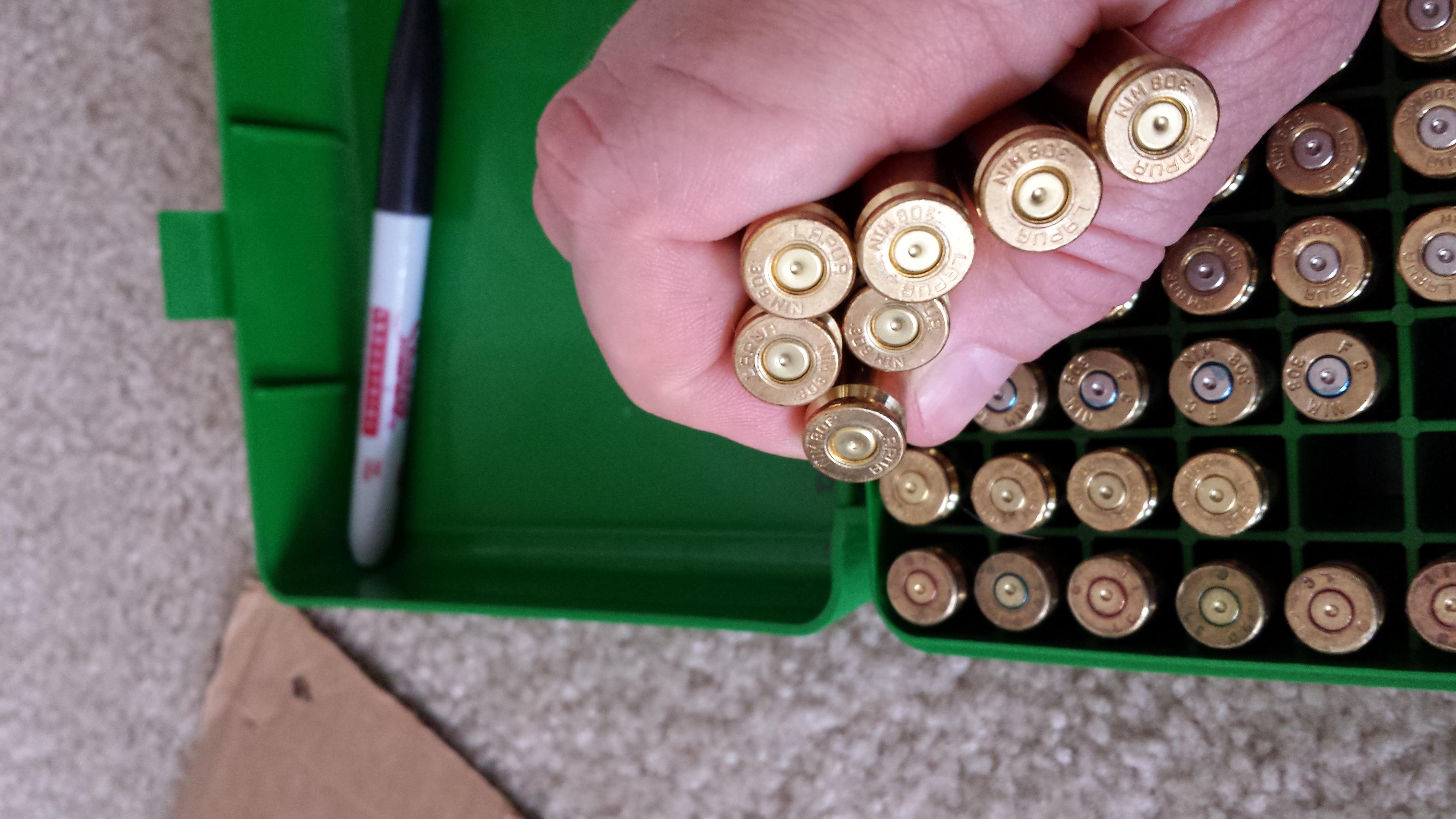

I usually buy CCI primers, but they were unavailable so I decided to give Remington a try. I loaded 50 rounds in my .260 and took them to the range. I had 3 misfires out of 50. Pretty good indentation on the primer too. Has anyone else had problems with Remington primers?

Hey buddy, be aware that your .260 has an adjustable firing pin.... I'd personally contact Marty at BO and ask him the exact dimension required for proper ignition. I had to play with mine once I put a Tubb speed lock spring kit in it (helped a little with the bolt uplift).... super easy to fix.
best of luck bud

I also picked these up from Scheels. Could be a bad batch?? I'm sure the QC on primers has gone down being that everyone is producing them as fast as possible.
-It is possible some Large RIFLE primers made to the Large PISTOL primer dimensions. That difference would make them shallow in the primer pocket.
-Another possibility is the primer pocket being over aggressively uniformed.
-If the case headspace is excessive that can result in misfires.
-The primer could be bad, but I would investigate the above causes before jumping to a bad primer.
I fully understand your point but I am leaning towards bad primers as I use these in a hunting rifle that I don't even bother uniforming primer pockets. Don't really see the point in wasting time in a gun that I don't shoot over 500 yards and holds about 3/4 moa.

To the OP, I've have the same problem. Loaded 200 rounds with Rem 9 1/2, and at least 20 did not go off. Loaded 200 the same way with CCI 200, and they all went off. I tossed the rest of my Remington primers in a box to be used in desperate times it need be.
As I mentioned earlier... if you'll measure the depth of the primer cup of the primers that did not fire, you'll probably find they're shallow. I wouldn't have my rifle altered unless or until I'd checked the primers. I went thru some CCI's that had this issue, and found 3 or 4 in a box of 100 from the same lot number that were about .005" thinner than the others. Large Rifle Primers that work are about .125" thick, and the ones that failed were .120"... a couple even .119"...
I measured a few of the primers. All were around the .125" range. I believe adjusting the firing pin will eliminate the misfires.

Just had 7 more duds. Box was stamped "2144". Primers measured about .130" deep. I keep them dry in a Tupperware box, I loaded 20 rounds about 3 months ago and only 13 of them fired in my R700. Good strikes, no issues with M80, FGMM, or Federal 210 primers in the same rifle.

This batch of primers has misfired in two different rifles, one R700 and one Savage 10FCP...both new within the past 6 months and both with less than 500 rounds. Did you look at the strikes? I am not an expert but they seem fairly deep to me. The same R700 has been setting off milsurp and Federal primers without any issues.
If it's happening in two different rifles it might be a bad batch of primers.....I've just never had problems with primers. I have some Remington primers, but I usually load CCI.
The primer strikes seemed deep enough to me, on my misfires, but they didn't go bang at times.
You mentioned putting some type of grease on your firing pin and inside of your bolt. Did both rifles have the same lube? Could there be a build up of this inside both bolts?

Some of the pix in this thread seem to depict what appears to be to be a light strike on the failed primers. Given that the others appear to have worked and show a more solid strike from the FP, I lean toward Dan's theory of primer mix-up. Today, I would believe that it is conceivable that some LR and LP primer got mixed in the same lot somehow and made it to the field. The mania to produce components may have led to who know what!

I don't buy the light strike theory. This is a 3-month old factory fresh R700 with no lube on the pin, fired in clean environments. The Savage that they misfired in was also new. These are clean strikes. You shouldn't have to hit them harder than that to get them to go.

Below is the photo of the OPs primers, the primer hits look a little wimpy and the red arrow shows the bolt left rub marks on the primer. This indicates the primers were not seated properly when they should be .006 to .008 below the surface.

What I see in common with the OP and dmike photos are weak hits and lapua brass.
Below is how a properly seated primer should look and the anvil under preload. (slight primer crush)

Look at the one in the middle, looks like the pin barely even hit. Almost looks like a shotgun firing pin indentation on the outside shells, I'd say its possible the primer pockets could be too deep and the firing pin may be pushing them in, but why the bolt rub marks on the red arrow one.
A shooting buddy and I have had similar misfires with Winchester LR primers (different lot numbers) in 308 cases (FGMM and LC cases). All misfires indicated strong firing pin strikes. Some of the ones that fired evidenced gas escaping between the primer and cartridge primer pocket, which led to some scoring of bolt faces. All were seated to a correct low depth with no resulting overpressured indications, and have occured in both Savage and M1A1 rifles. All primer pockets had been prepared using Sinclair depth cutting tools tools. We've all gotten rid of these Winchester LR primers, and for the most part have gone to CCI with no further problems.
