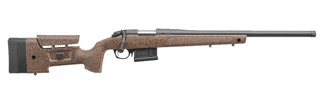

Get a Bergara HMR 308. Or a Terrain model if you don't like "tactical/Competition" stocks.
Highlights:
-Remington 700 footprint
-Remington 700 scope mounts
-Better than 700 action
-Better barrel
-700 aftermarket works for the Bergara
-1/10 twist for 308 and not the old AF 1/12 and 1/11.25
Retails around $1k most street or used prices are under $900 for the HMR. The terrain maybe a little more.

I definitely like the Bergara Wilderness pictured above, but would like to handle one. All up, it would be a heavy rifle, but I suppose no heavier than the route I'm currently going down.
Highlights:
-Better barrel

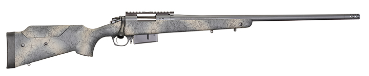

Do you know the barrel diameter for the Terrain Wilderness? Is the barrel thick enough to run a can?
Also, what about the Springfield Waypoint in 308? Whatever route I go, I'm eventually putting a can on it.
I don’t know the actual diameter of the wilderness. I have an HMR and I wouldn’t hesitate to run a can on it.

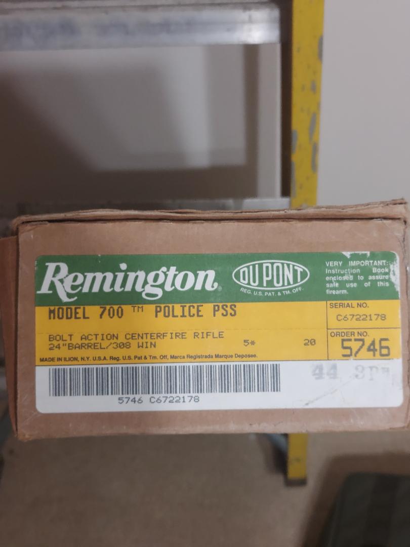

First if all, thanks for the add to the forum..
I have a Remington 700 PSS in .308 cal. that I purchased new on 8/22/1992 from The Traders in San Leandro, CA for the princely sum of $539.97. I also purchased a Leupold VX-III 3.5x10x Police Standard riflescope ($339.97) and Leupold rings ($46.00) for it at the same time. It got zero use during the last 30 years (except for an abbreviated 2 week US Army sniper course for CA Nasty Guard members).
I was recently doing an inventory of the bunker for future estate purposes when I came across it way in the back of the vault. Bored & needing a new project, I decided to give the PSS a modern day "tune-up", so I installed a Timney 533 2-stage trigger, had the barrel threaded for a AB Raptor suppressor and installed a Wayne 10 rd. detachable magazine. After completing those mods, my first trip to the range with my PSS in over 3 decades turned out to be a very enjoyable experience. It's quite the shooter, even with an old, cross eye dominant fart like myself behind the controls.
My question is a simple one. Most of the information that I find online from Remington says that the original Remington 700 PSS came with a 26" barrel, but as evidenced by the attached pictures of the box end and owner's information, mine came with a 24" barrel. Did the supposed 26" barrel model come along later in the production of the PSS, or is that just a typo on Remington's part? It really doesn't make any difference, as my PSS is currently 5'+ in length right now with the suppressor attached. I'd just like to know if the PSS was actually made in two barrel length or somebody mis-measured.
What say ye & thanks again for adding me to the forum...

That box is marked PSS not 700P.
It is hard to find much info on what was done at the factory, but a PSS (which stood for police sharp shooter or sniper special depending on who you believe), was not a rack grade rifle pulled off the assembly line. Some say it was semi custom from their custom shop, they have a well earned reputation.
The 700P, with the 26" barrel was nothing more than a 700 SPS Varmint, pulled off the regular production line, parkerized and put in an HS Precision stock. Later models had 40X triggers installed.
I'm sure the change happened around the time they were bought out by the freedom group and quality began to nosedive.
