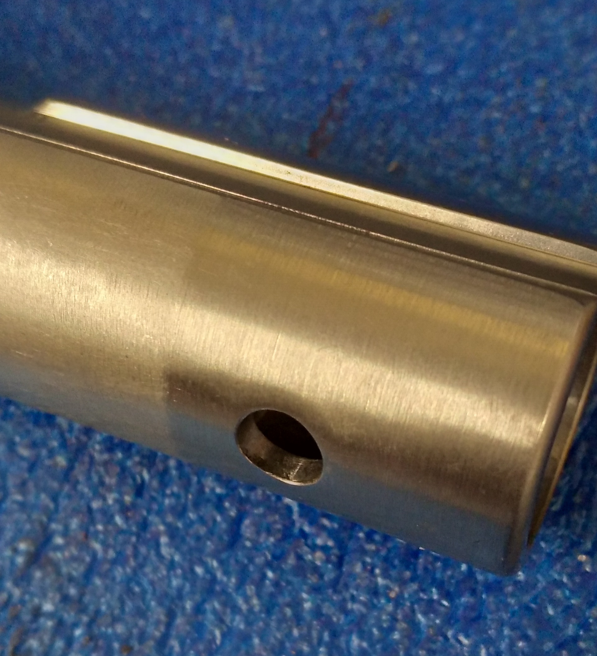

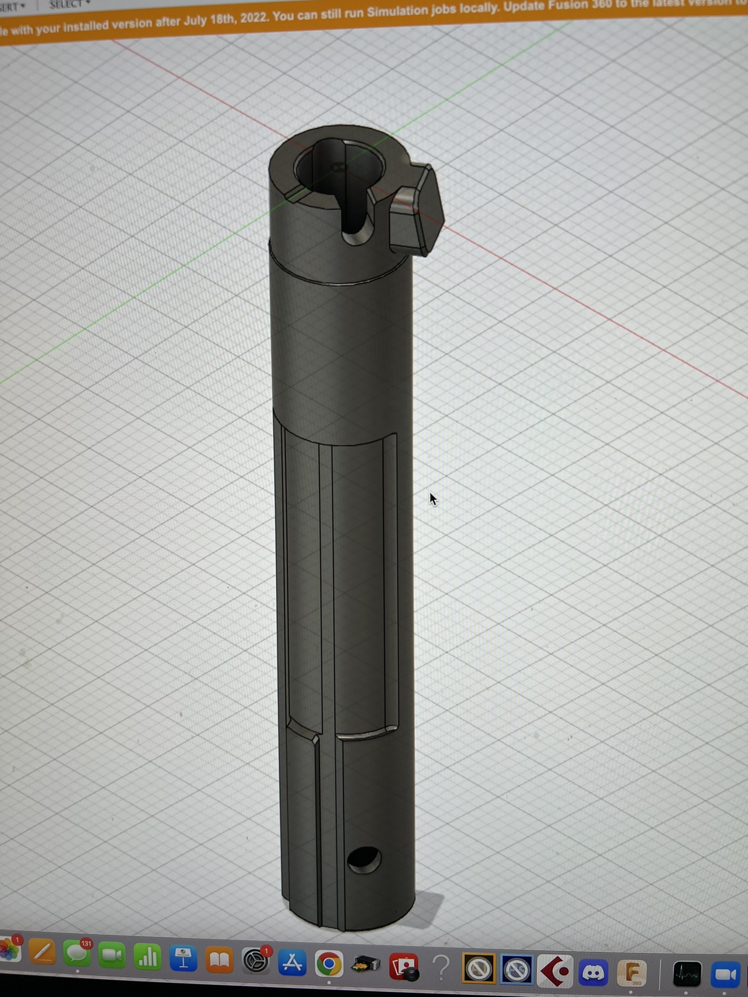

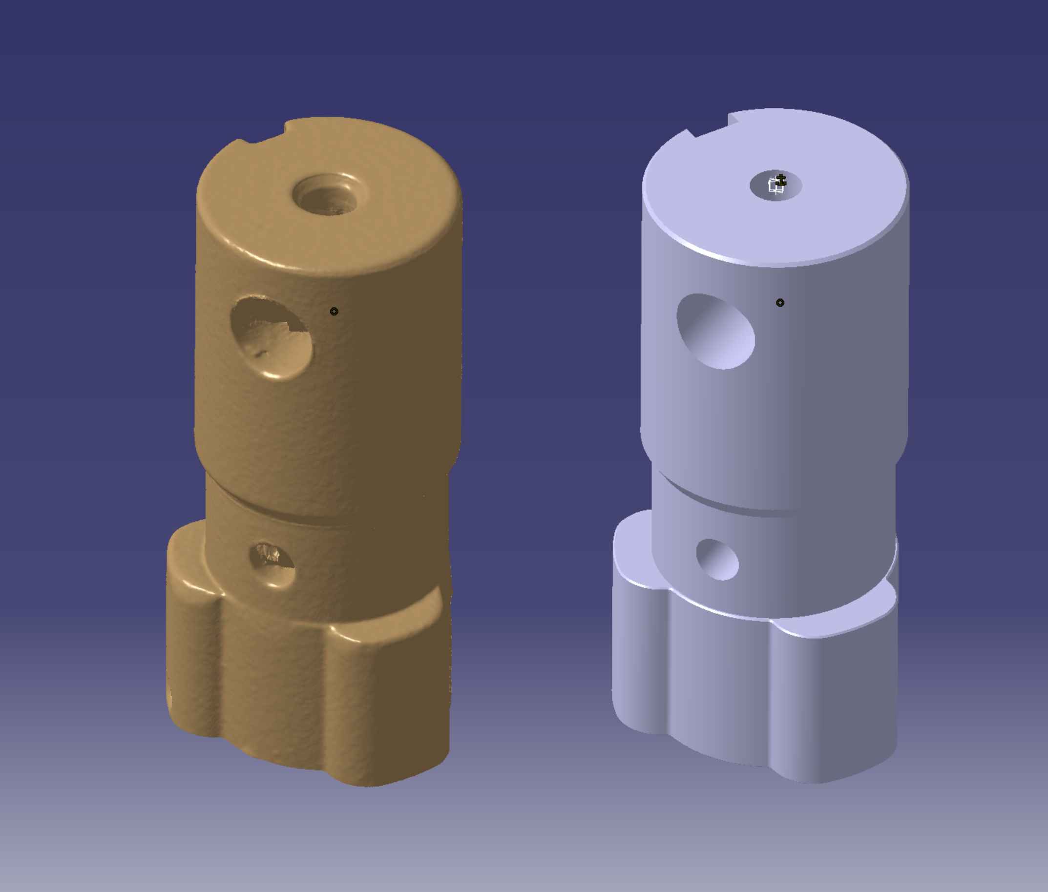

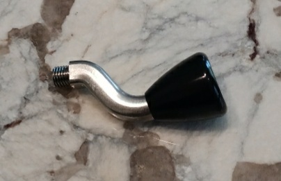

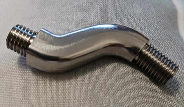

I wanted to let everyone know we are working to produce some of the missing MSR/PSR parts. These are awesome rifles, but it seems like there are more chassis’s and actions than bolt bodies and other small parts.
Currently we are working on the bolt stop, bolt body, and firing pin assembly.
If anyone has knowledge about the system,
experience or connections in producing a small run of parts like this please let me know.
Please comment with which parts you need as well as the quantity.
I will keep everyone updated with the progress here as well.
The parts will be marked to indicate that they are not factory original parts. But should function and appear like the factory parts.
When we get to production, Kace at Raider Outdoors will be handling distribution in a separate post. https://raideroutdoors.com/

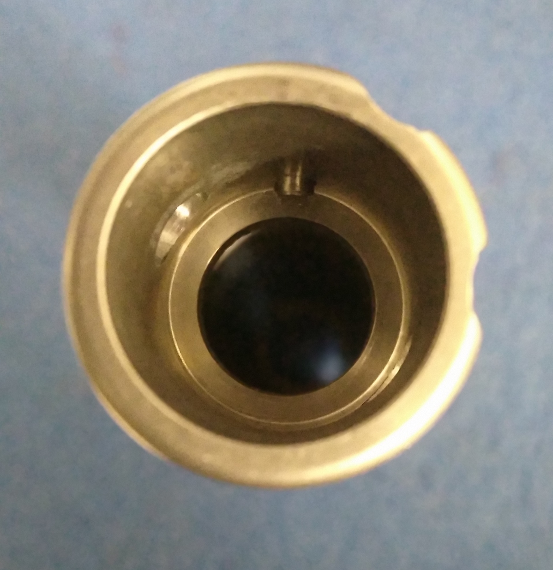

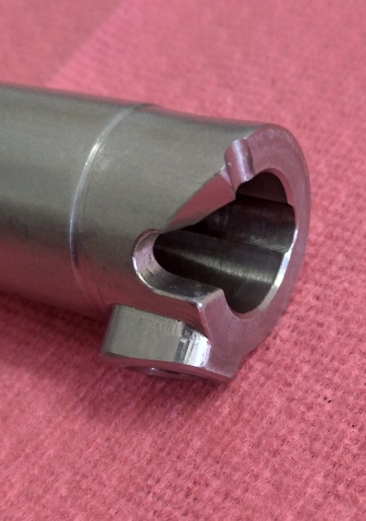

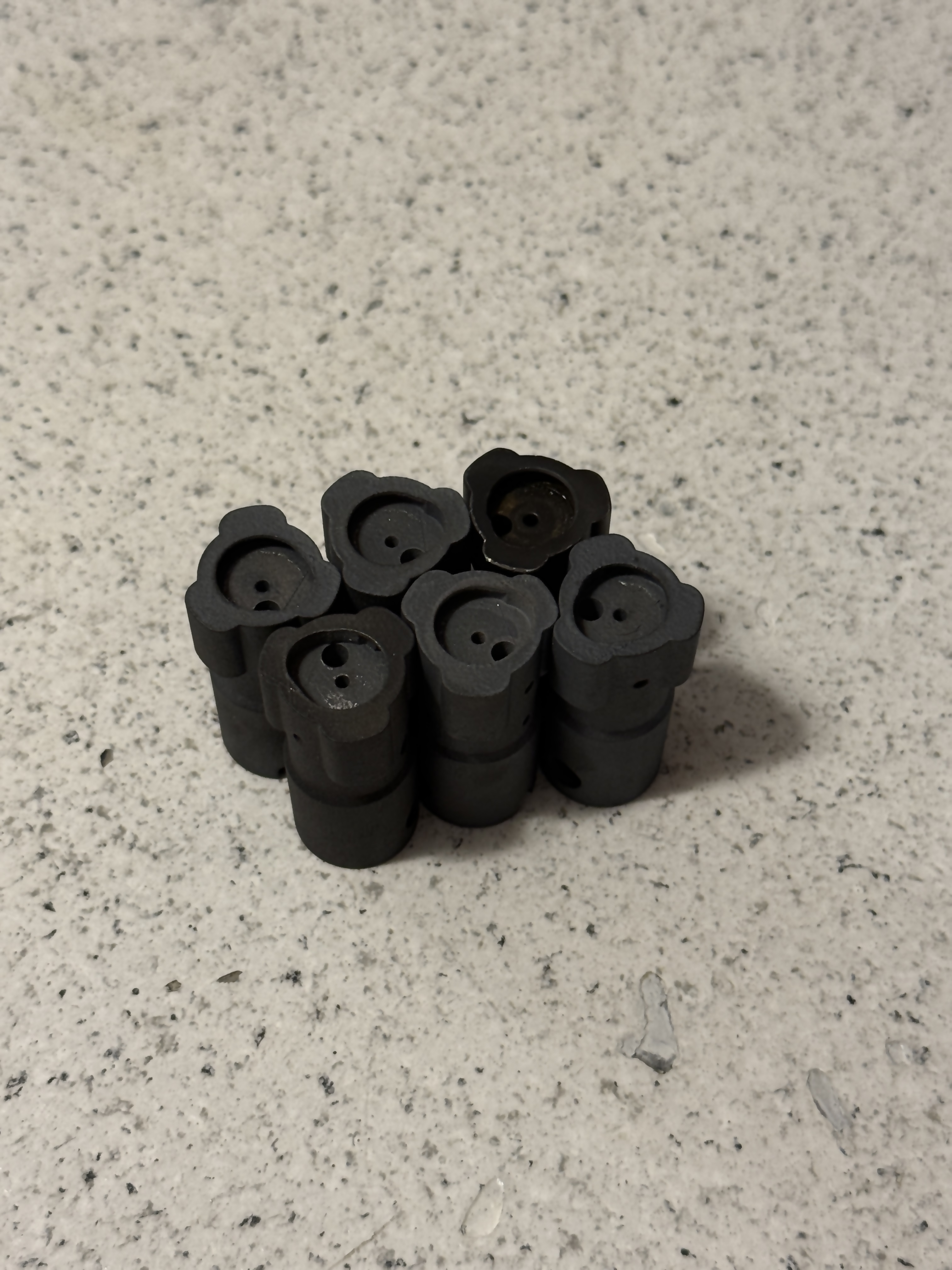

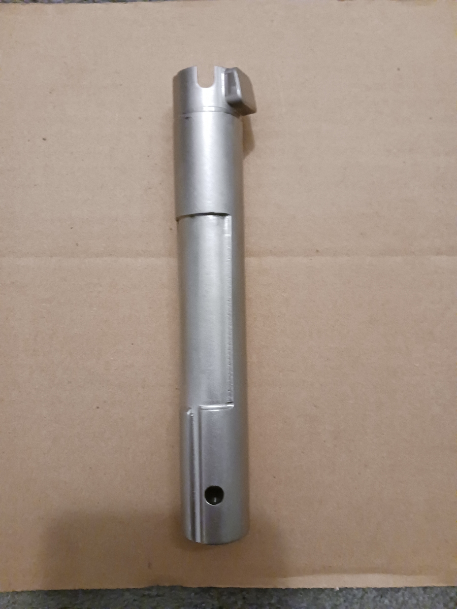

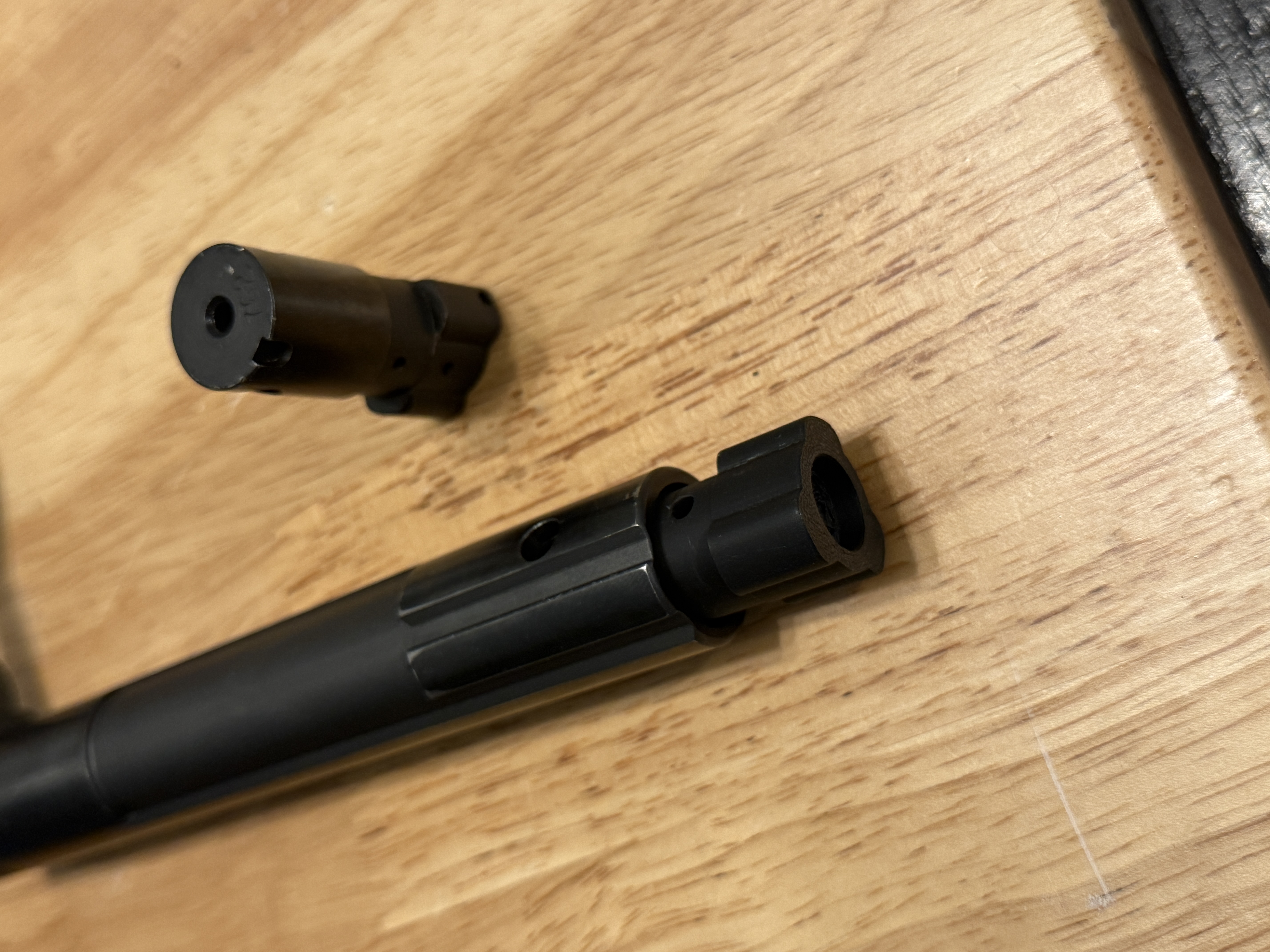

Not to hijack the original thread, but I've made some progress on getting some bolt bodies completed. I have the bolt handle, bolt knob, and bolt head retaining pin completed. I just have a few machining operations to complete on the bolt body. Essentially the helical cut where the cocking piece interacts and installing the timing pin that aligns the bolt head.
I would love to get a count of how many people are in need of complete bolt bodies.
To be completely forthcoming, I have limited opportunities here and there to work on this, due to travel for work. I don't have an estimate when these will be finished. I'm happy post progress here occasionally.
@molonlave, I am in need of a bolt body. I know of a few other individuals out there who may also be looking.
So I see you basically duplicated the 3D model that's been floating around... It's close but it's missing a few features, it's been common knowledge that the geometry on the 3D isn't 100% good... If you want more info let me know... Good luck...
100% agree, and I've been spending significant time making corrections. I would love any info you could share. I'm currently working up a jig to time the handle to the body. I should have some updates by the end of the weekend.
I finally worked out a fixture to cut the firing pin head ramp (not sure of the correct nomenclature of that feature). Anyway, I'm satisfied with the outcome. However the initial notch in the 3D model appears to be cut .060" deeper and possibly slightly wider. Initial test seems to suggest the ramp should function just fine.
