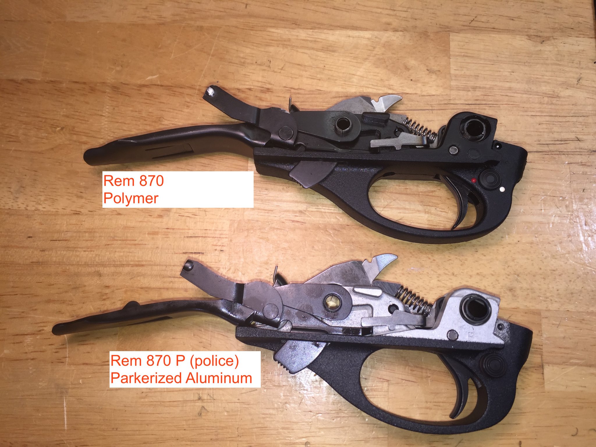

IF you are going to use it for self-defense and hard use might consider changing out the trigger package for the Parkerized aluminum Police version rather than polymer version as well as changing the extractor to a milled steel style rather than MIM extractor.

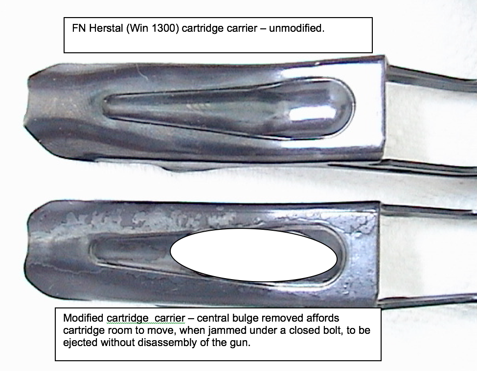

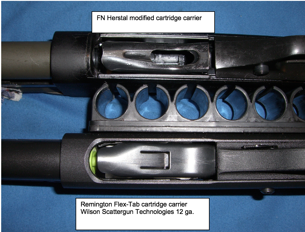

You definitely want to have a model with the "Flex-tab" lifter, or install one, to manage any double-feeds for either field use or defensive duty. Without the flex-tab, a double - feed can immediately convert the gun to a club as you have to disassemble the gun to rectify it. Mossbergs have an open bottom and not subject to this concern. The FN police shotguns have a solid lifter, so I modified mine that allows room for the two confined cartridges in a double-feed to managed like the flex tab or the user can insert a finger and correct it as well.
The choice of installing a metal trigger group (870 Police, parkerized aluminum) or polymer package; polymers today are so strong I don't think it matters and arguably the polymer is more resilient to deforming trigger guard impacts than the aluminum style.

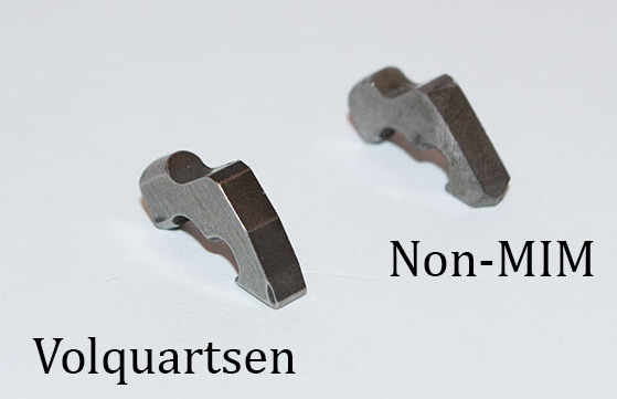

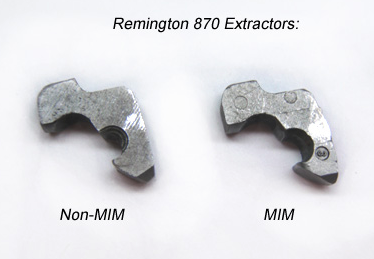

With only a single extractor (unlike the Mossberg 500 series) much chit chat about the extractor construction vulnerability to failure, now the std. 870's are MIM parts, not milled steel like the old days; the 870 P model has a steel extractor. The best quality steel extractors are the Volquartsen.

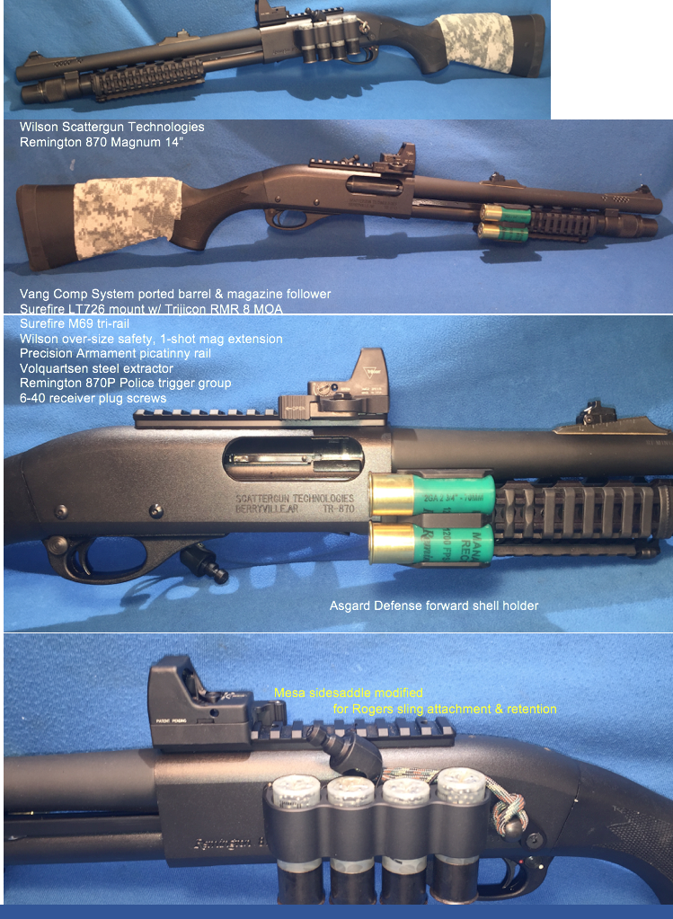

Two Rem 870 extremes from field to combat:
My first shotgun as a kid was a break-open single shot 20 gauge Ithaca; after a rookie season of not being dangerous I was allowed to graduate to a 20 ga. 870 Wingmaster; I have several of them in different gauges but I enjoy the nostalgia just picking it up. On the other extreme I started a project with a Wilson Combat Scatterguns Technology 12 ga. 18" 870. It was much to heavy with a full magazine of shells and a large SureFire forend; I converted it to a 14" SBS with modifications listed below.
