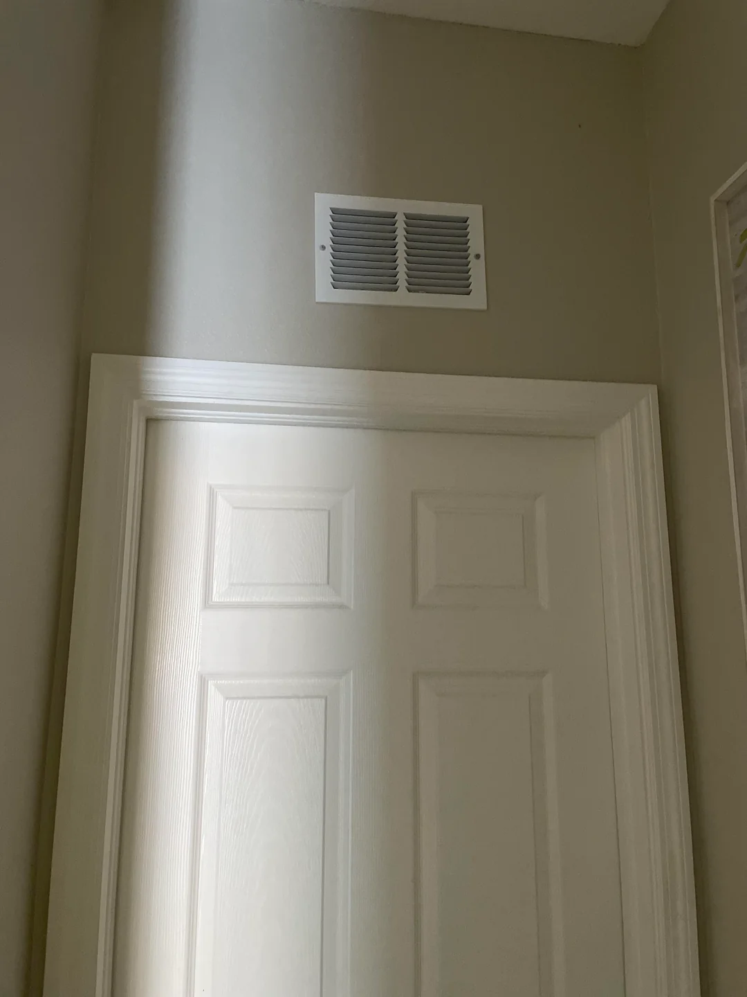

Do you have vents above the bedroom doors to aid in airflow? If not, do it.

I am pretty confidant this isn't a venting/ductwork problem, but I'm interested in why that helps. Can you explain further?
The vents help the return air make its way out of the rooms, and in your case with the thermostat right outside those rooms, it should aid a bit with your issue.
