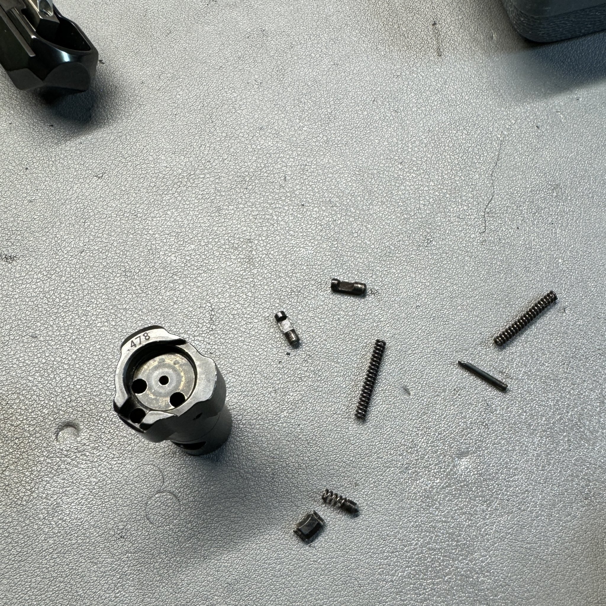

Terry is right, no supporting info out there. Here is what I did. I used a brass case to push down on the 2 ejectors lightly to release their spring tension. With the case rim under the extractor, I used masking tape and a bench vice to hold the bolt head and brass case in place. Then just drive out the single coil pin that held the 2 ejector in place with the correct size punch. Hope this picture is useful to ya.

I made a "splint" using a short length of brass cleaning rod, my no-go gauge and a couple stiff rubber bands.
The splint provides enough side pressure to keep the gauge locked in place and free up a hand.
Wrapped the whole thing in a plastic bag when the pin was out out a little way.
Worked pretty good.
Not going to work to put it back together though. It could with a better splint design.
To put it back together, I'm using a Harbor Freight arbor press. There's already a hole in the ram that perfectly fits a 308 case.
I drilled a hole in a 2x4 to fit the back of the bolt at the correct distance from the back of the press to fit snug up against the back of the press, so I can tap on the roll pin without things moving.
Generally I prefer inserting roll pins with pliers as far as possible before using a hammer.
You can install one at a time, so that helps simplify things.
