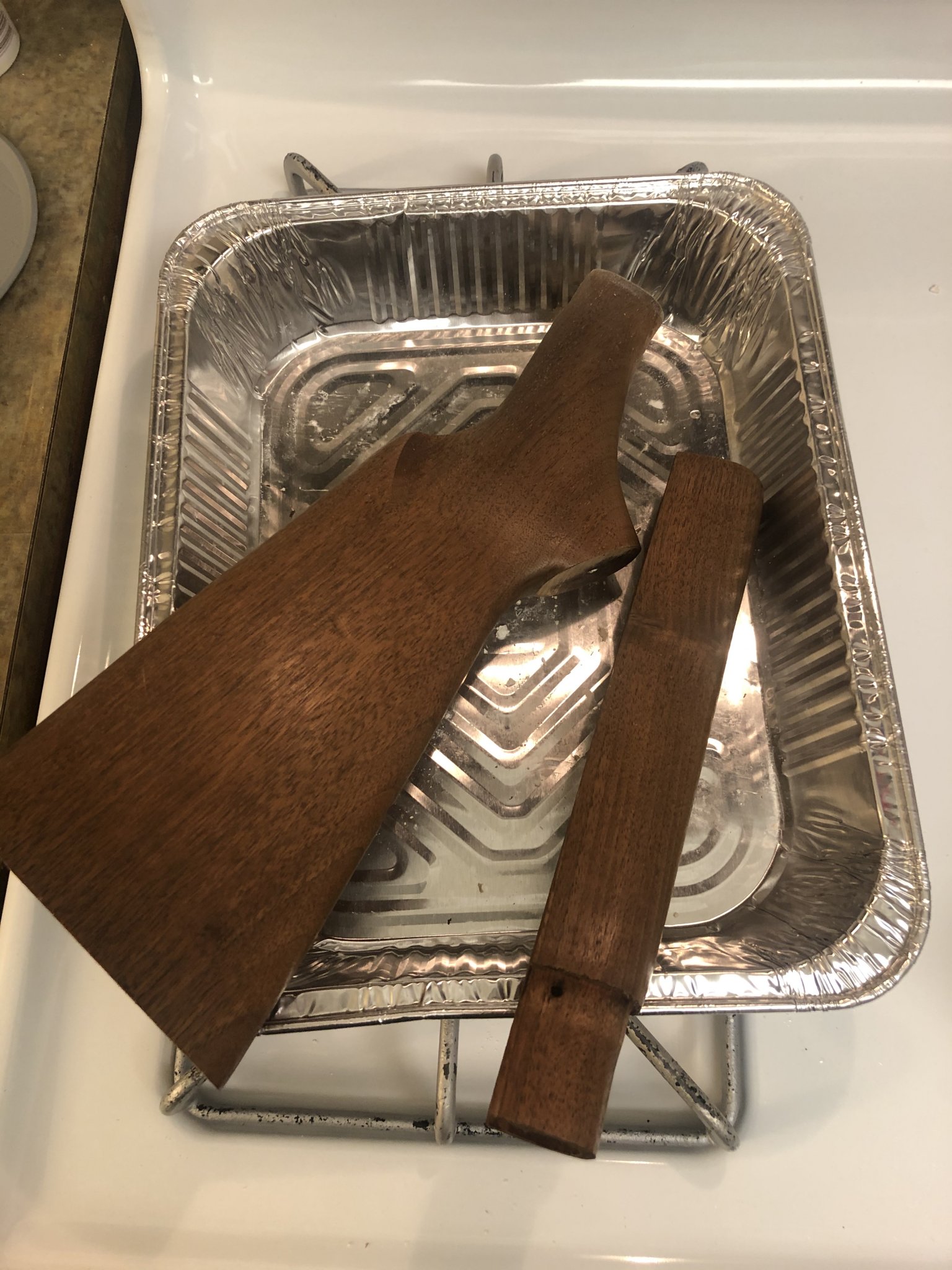

I refinished my Citori skeet gun stock last winter and ended up soaking it in a foil pan filled with acetone for a day, then lightly sanding and soaking it again before I got all of the oil out. Acetone can really dry the wood out though and cause it to split or crack, so use at your own risk. I also got a little container of whiting compound from Brownells and tried that first, but it just didn't seem to be working like I thought it should.
You can see some of the oil on the left side of the fore end in this picture, that's where it mated up to the metal.
Here's the final product

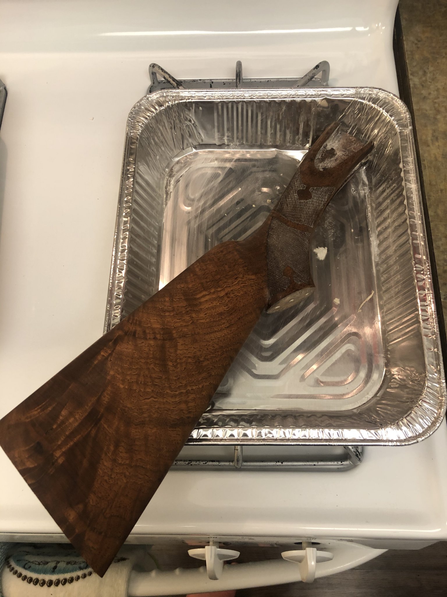

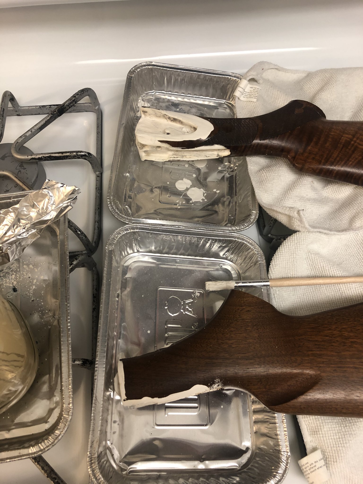

Progress Photos:
  1. LC Smith and Marlin 336 inlets painted with lacquer thinner and diatomaceous earth to remove the soaked in oil. There was quite a lot of it; probably 5-6 paint / wait a day / brush off / repaint cycles on both guns. Note to self: store muzzle-down.
  2. LC Smith stock after several paper towels soaked with lacquer thinner. I’m less interested in completely refinishing the entire stock, and more interested in making sure I can blend the areas next to the action inlets in with the rest of the stock after bedding. There is one chip next to one lock, one small crack next to the other lock, and a long crack between a vertical web and one of the action supports.
  3. Marlin 336 stock after a couple paper towels with lacquer thinner. Since I need to refinish one end of the stock after bedding, the other end of the stock after making a recoil pad, and the forend after bedding to the action and barrel, might as well redo the entire thing.

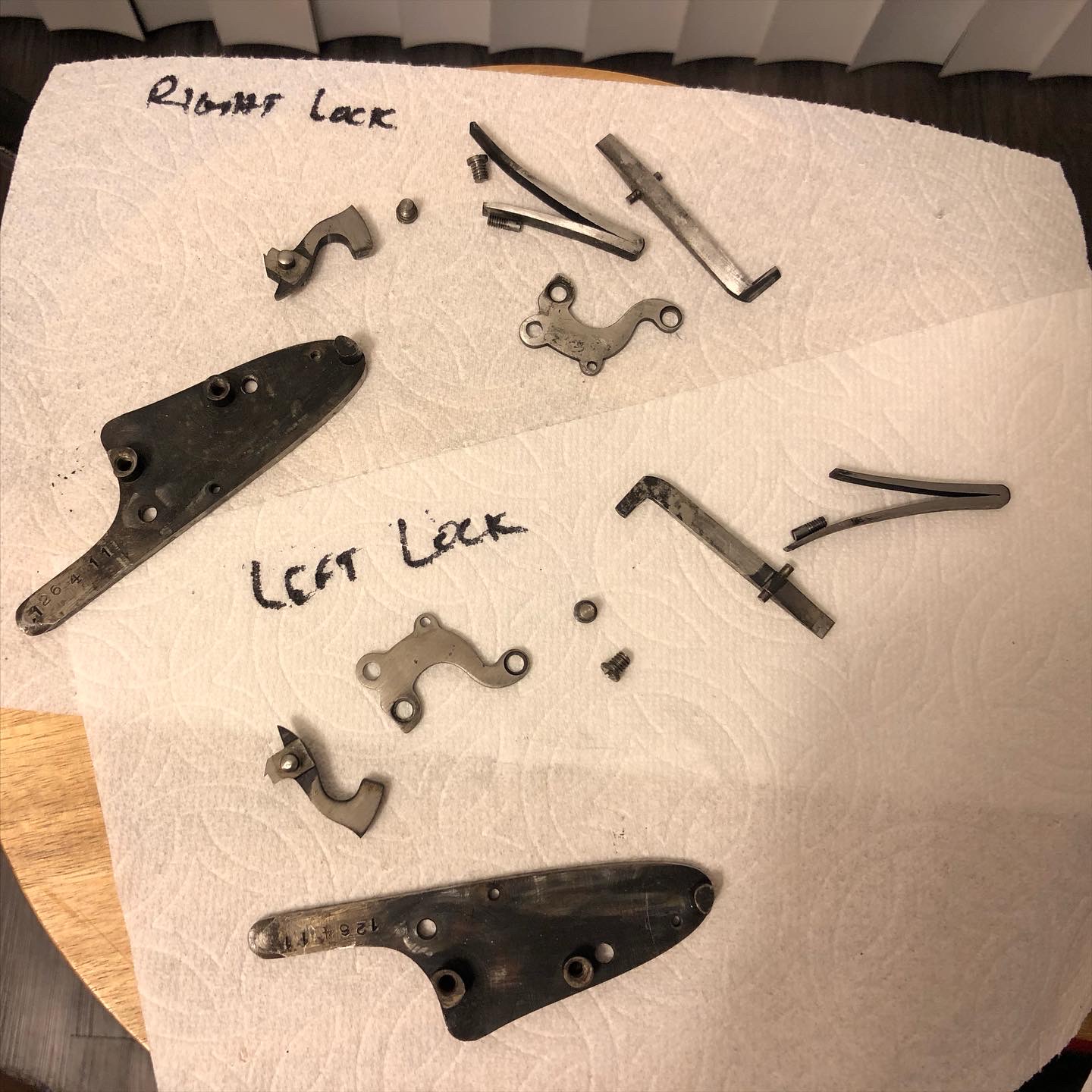

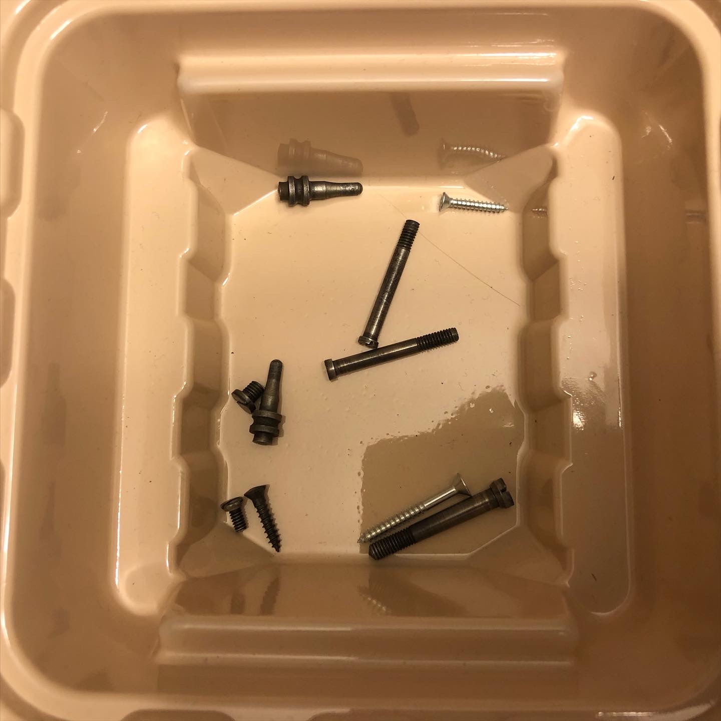

Almost fully-disassembled action. The cocking cams are press fit onto the cocking rods, and the safety sear pin is peened onto the safety sear. Otherwise, I’m good to proceed as planned:
  • Clean off 80 years of grime
  • Bed the action to the stock
  • Reinforce the wood such that it doesn’t interfere with the locks, trigger plate, safety bar, etc.
  • Screw together a couple small cracks
  • Give the metal parts a light coat of oil
  • Give the stock a few coats of Tru Oil
