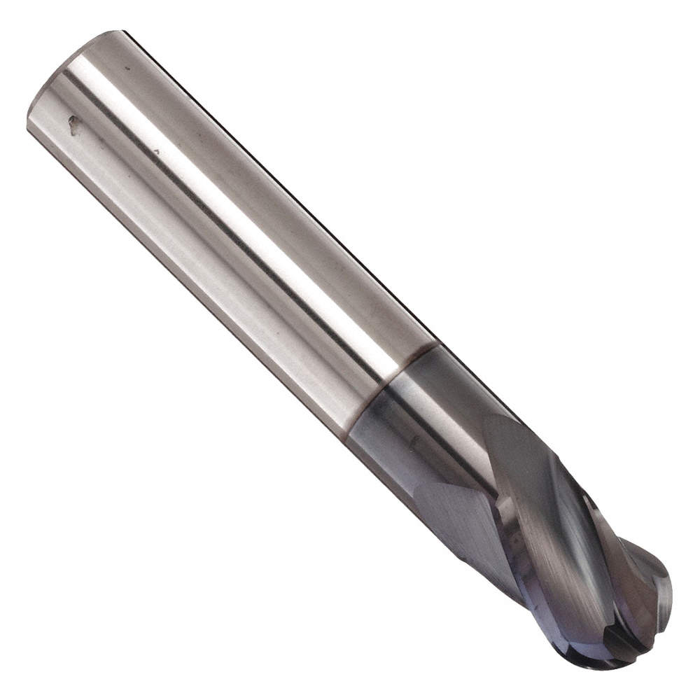

I just finished re-bedding a stock this evening after work and thought I would show you what I did for reference. The Manners T4-A in the pics was originally bedded for a Deviant. I bedded it for a Surgeon Scalpel. I had to open up a small inlet for the bolt release with my mill, but other than that I didn't have to make any changes to the stock.
I have a Bridgeport mill in my garage that I use for hobby type stuff, and I have access to endmills like the one above, however, I really wanted to get as close to the pillars as possible without damaging them so I opted for a Dremel tool with a carbide rotary bit. I took some time and just removed the original bedding by hand. I would take thin pieces of paper and run it along the receiver every now and then just to find any place where I might be hitting the original bedding. (I used blue sharpie on the pillars along with a piece of paper to see how I was contacting the pillar. I would mark it, then put the paper there then seat the BA and would get an impression on the paper showing my contact.)
