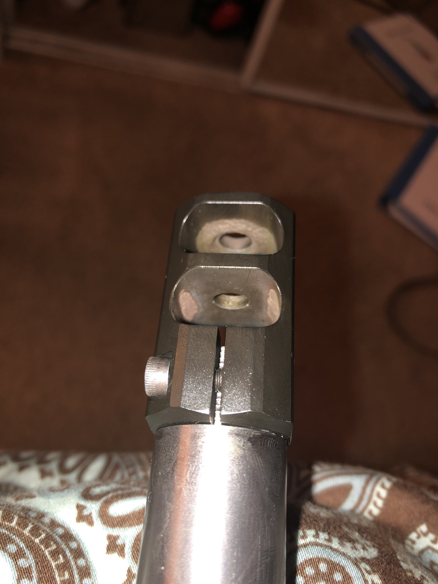

Looking for advice on getting muzzle brakes that have been neglected back to a clean state before starting them out on a regular cleaning cycle.
Please spare me the “I don’t clean my muzzle brake/crown”, good for you, I do.
How can I clean a copper mountain off of SS /nitrided brakes without killing the nitride or SS?
Have tried vinegar & hydrogen peroxide, SS tumbling, CLR, ultrasonic cleaning.

Copper solvent and any decent scraping tool. You indicated that you clean your brake and that’s a good thing. I’m thinking you should probably clean your brake more often. Like others have said, I’ve never seen that much copper on one before.

Ha, I hear ya. My wife feels the same way about the smell. Ammonia removes copper, won't harm stainless steel if you don't let it dry on it. I'd submerge it in ammonia. Not going to hurt anything. Drop it in a water bath to wash off the ammonia. Electrolysis in sodium carbonate would probably work to.
They spent 6-8 hours in CLR... that got 100% of the carbon off but didn’t touch the copper at all.
It has been in Hoppes for 6 hours or more and the big copper doughnut hasn’t budged.
I’ve scrubbed the black off of it that at this point I might as well sand blast it and blue it.
I have always used Sweets 7.62 to remove copper fouling. Should work on your brake as well. No need to soak the whole brake, just use a q tip saturated with it and rub down the copper, and then use a nylon brush to scrub it down. Probably need to do this a few times. I wouldn't leave the sweets on it for more than 2 hours at a time.

Soak it in Bore Tech C4 or similar copper remover. Keep it wet for a while then scrub it out with a brush and a pick.

"Bore Tech Cu+2 Copper Remover™ uses a revolutionary and patented chemical technology that rapidly removes copper fouling and is 100% barrel safe, odor free and biodegradable. Cu+2 Copper Remover’s cutting edge formulation is ammonia free and removes heavy copper fouling faster than the competition without the safety hazards, harmful toxicity, and offensive odors found in petro-ammonia based solvents. "
