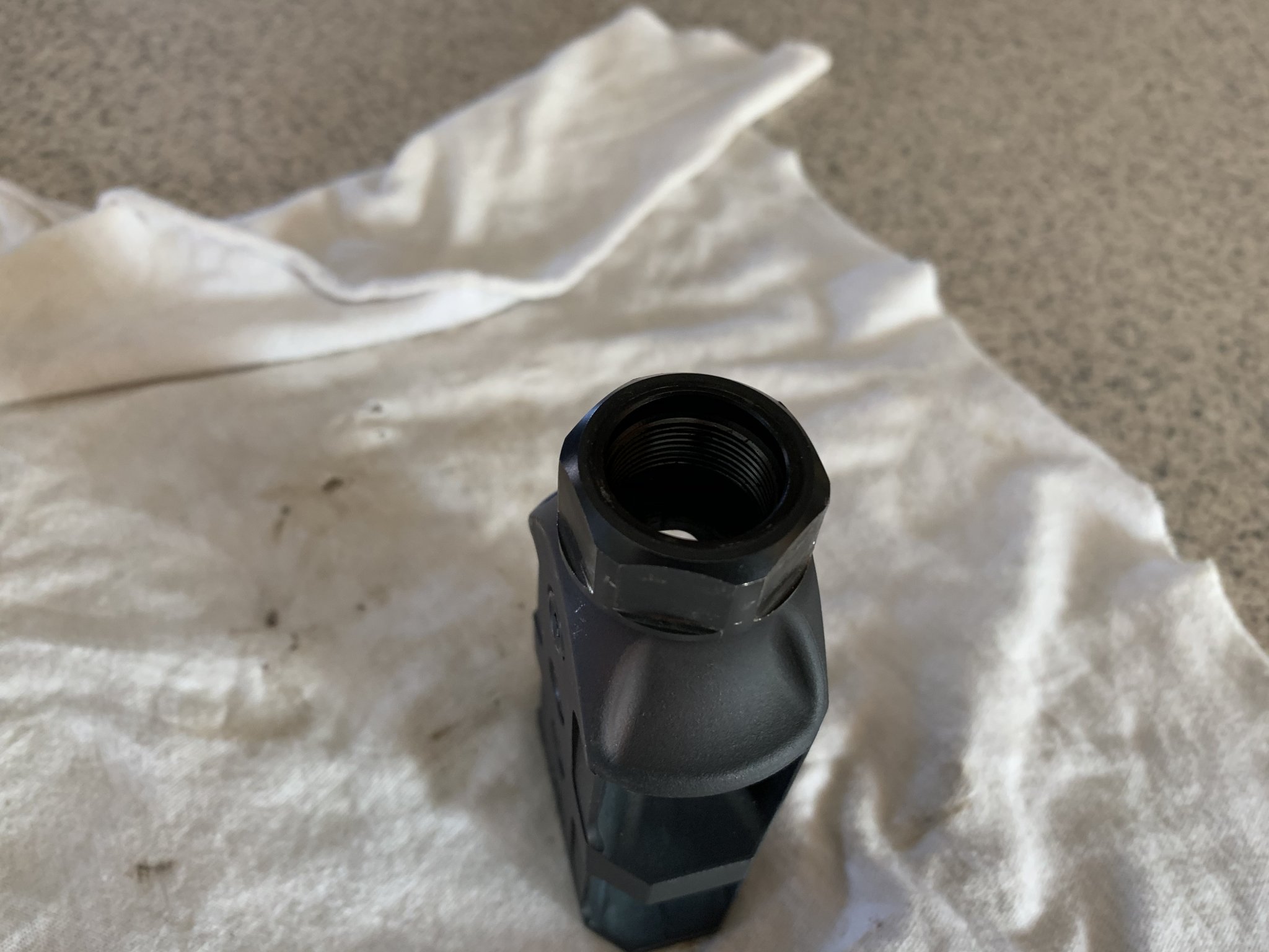

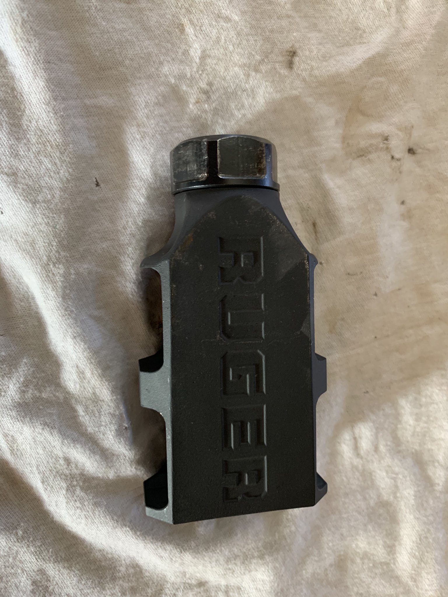

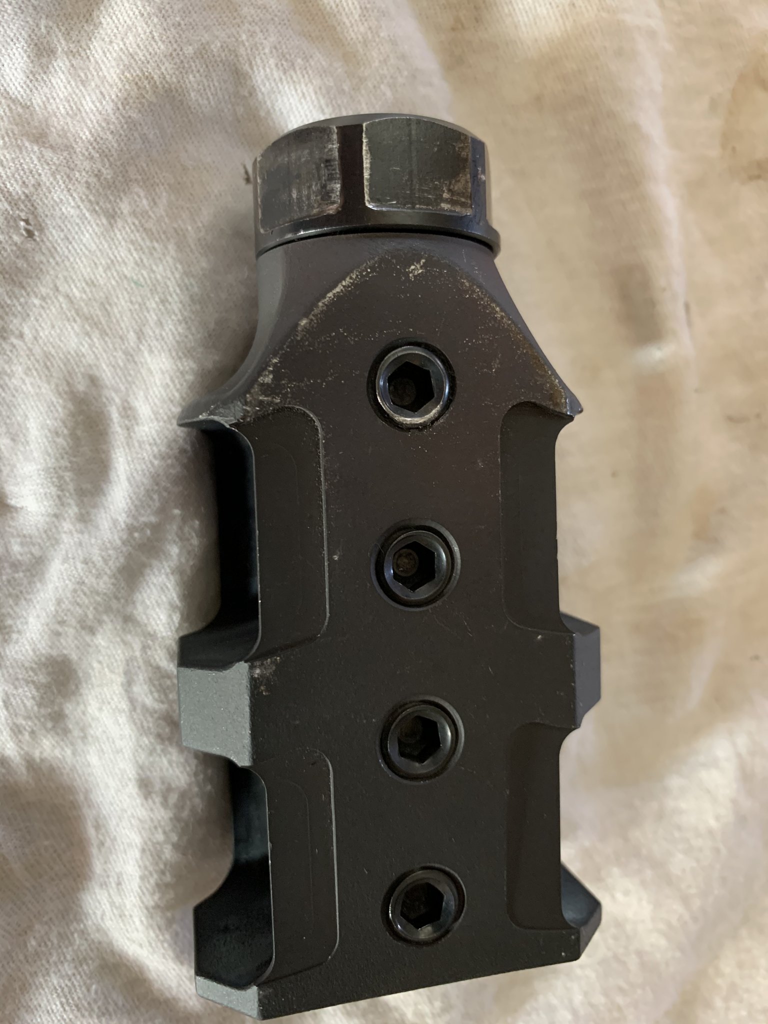

I just completed removal of the brake on my RPR .338 Lapua. Thanks to the previous posters for tips.
It didn’t work like it should. As previously stated, here and elsewhere that I read, you have the muzzle brake and the jamb nut. Generally you should turn the jamb nut as though to tighten it on the barrel while simultaneously turning the brake the opposite direction, and the two should come loose. Then you unthread the assembly off of the barrel. I started with a 15” crescent and a 1 1/8” combination wrench. No. Applied heat with heat gun and tried again. No. Swapped 15” crescent for 24.” Applied heat once more. No. Then, disgusted, just for kicks tried turning the lock but the other way, as if to loosen it. The entire assembly turned. I went ahead and took it off since I could. But the lock nut and brake are still jammed together.
Wanted to share and hope this helps someone in the future.
