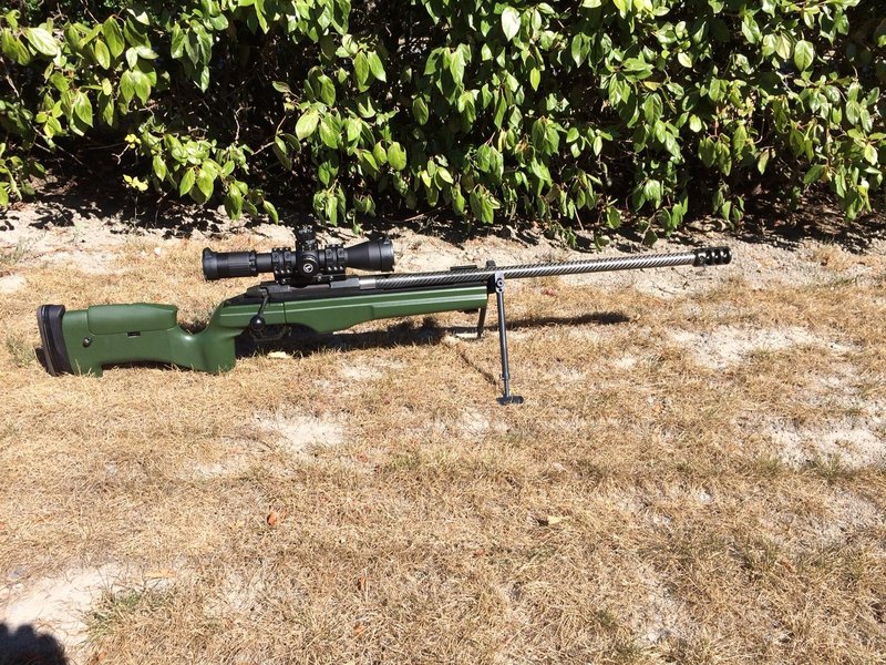

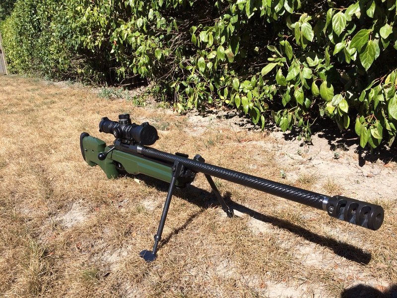

It cut a lot of weight off the rifle. With a Leupold Mk6 scope it's now 10.5lbs total without bipod. I feared changing the TRG barrel which shoots so well, but the new barrel, as discussed, I think is more accurate in 260 than the factory barrel was in 308. And the factory barrel was no slouch shooting 0.25-0.3MOA groups very consistently.
Gratuitous rifle pic with carbon barrel.
