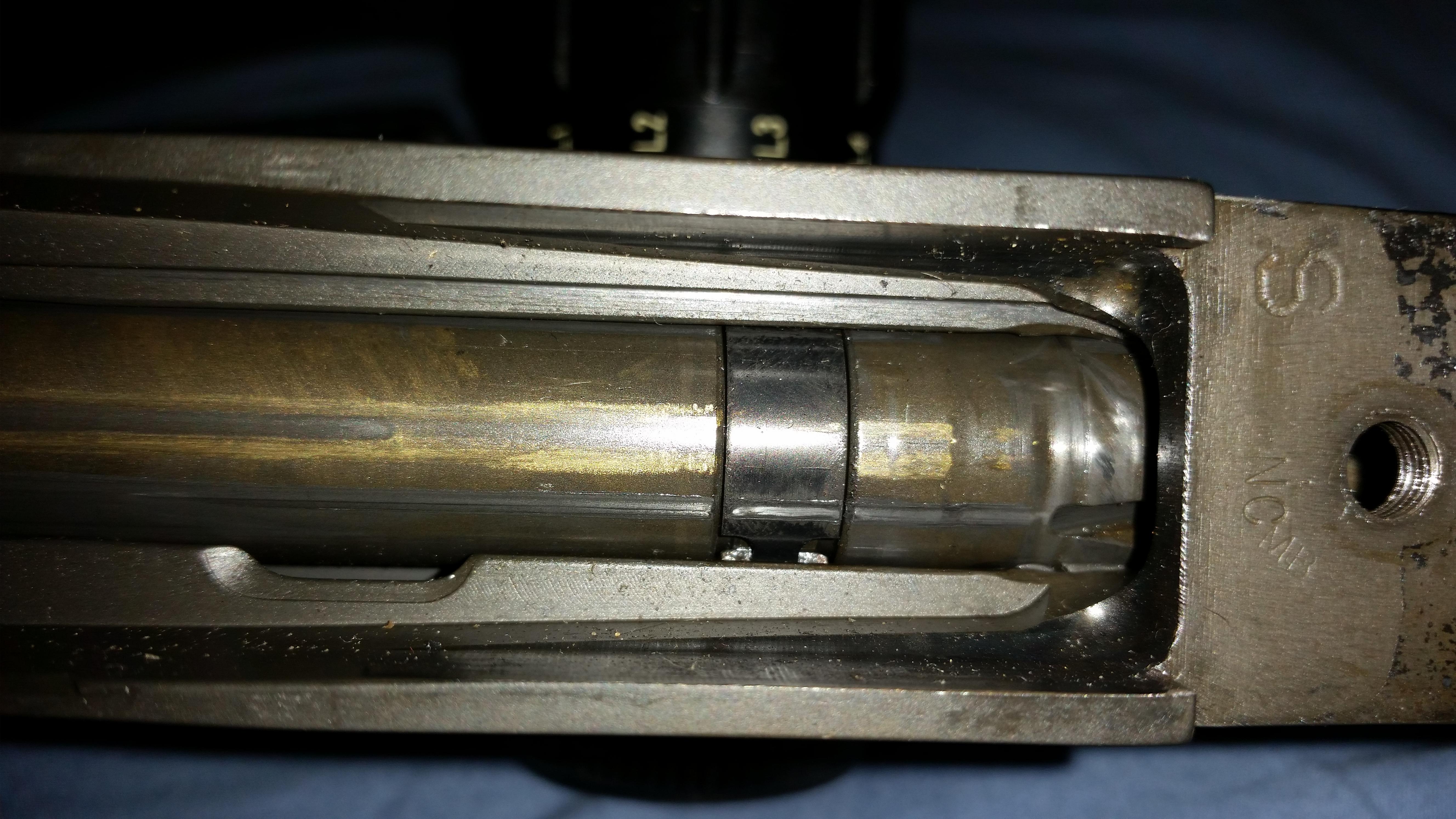

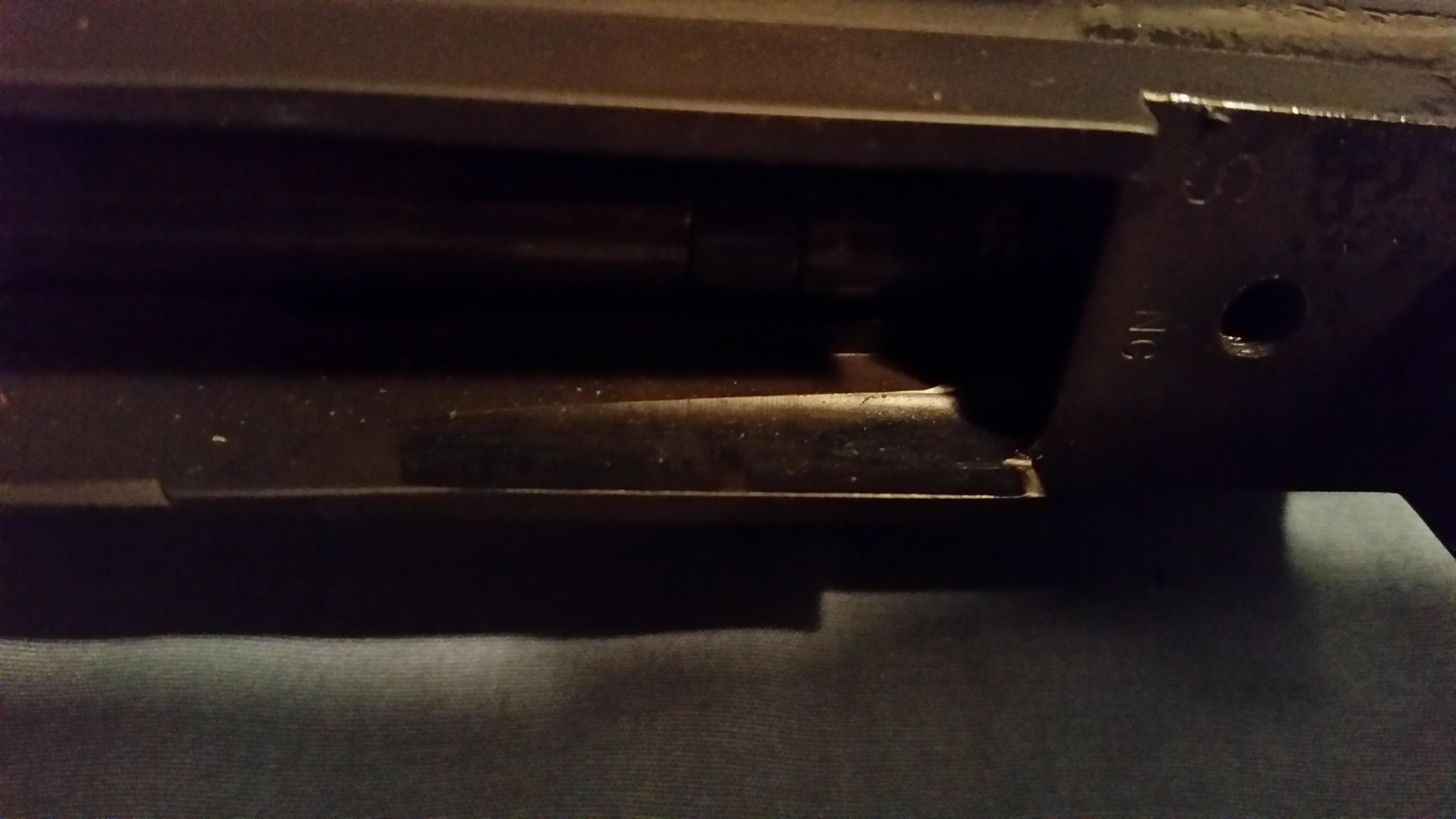

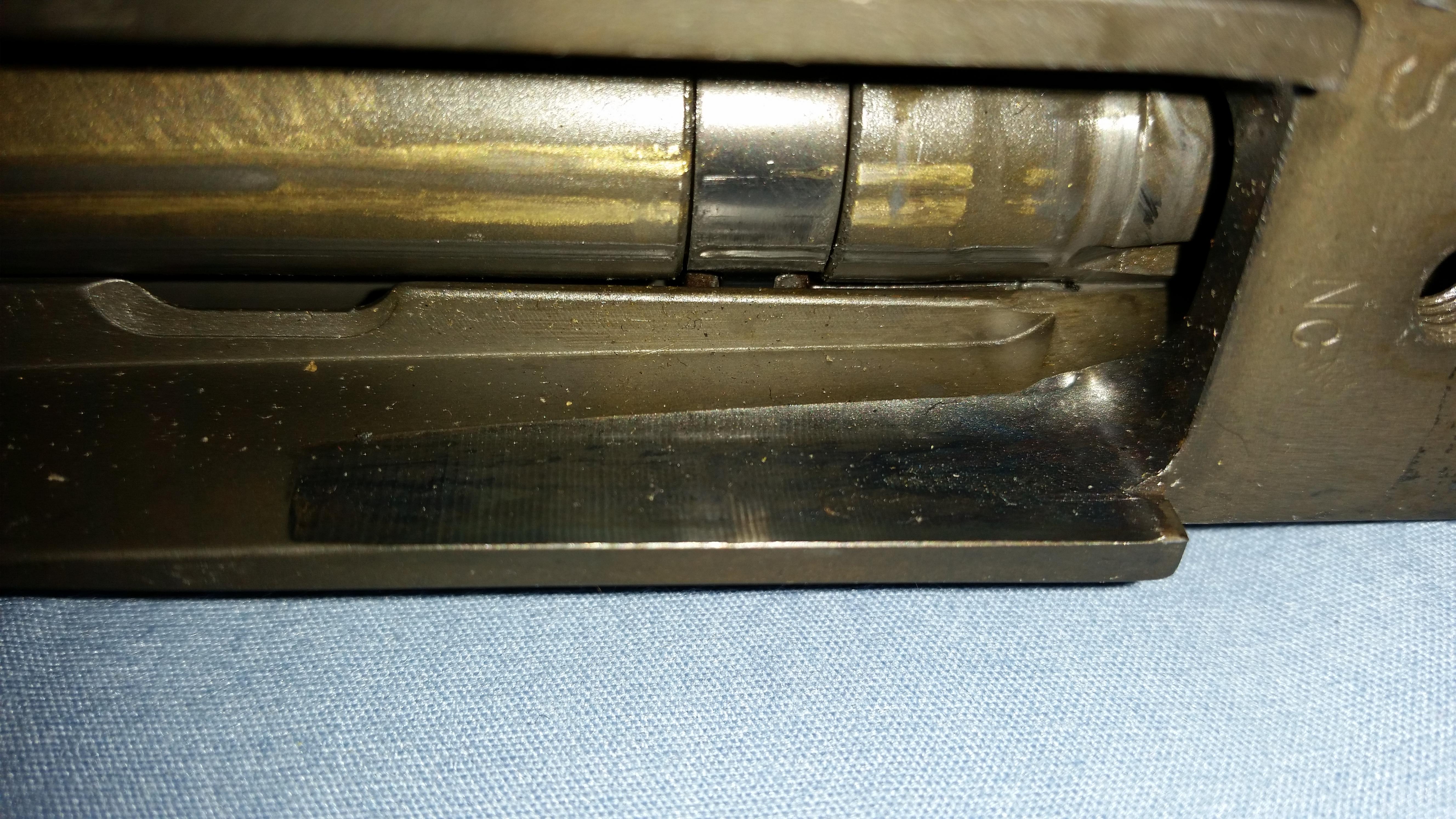

    As promised here are some pictures of the machining that needs to be done on the inside of the action in order to make the SPR work with AICS magazines. Sorry for the relatively poor quality, my only camera is my phone. I had Mike at Tactical Coordination install the bottom metal when I ordered the SPR through them initially.
    Also, apparently my rifle is filthy....
