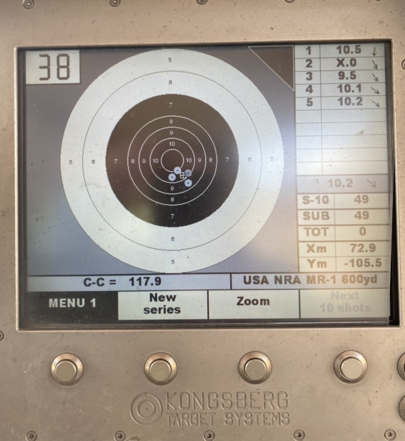

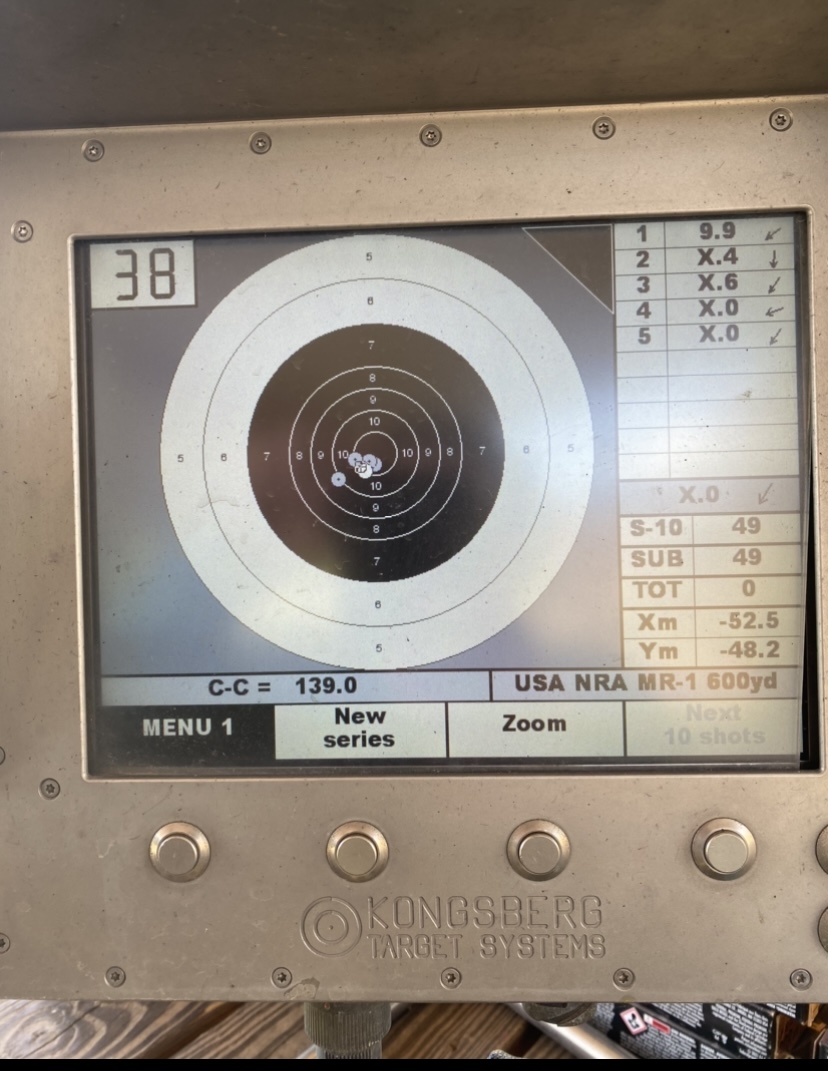

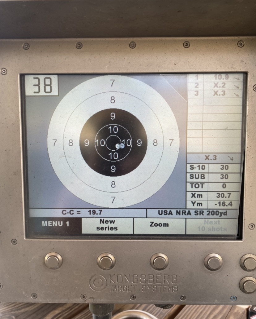

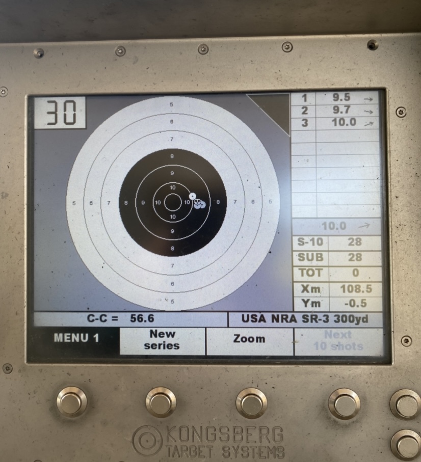

Here are some groups after a brief break in. This was in 8-12 mph winds with some 15+ mph gusts. Using factory 308 Federal 168 gr SMK
3 shots at 200 yards: 0.37 MOA
3 shots at 300 yards: 0.71 MOA
5 shots at 600 yards: 0.74 MOA, 0.87 MOA
It for sure outclasses me.
