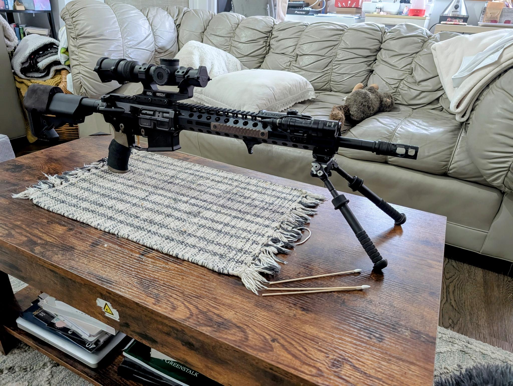

Picture of current Scout setup for help:
PLXC 1-8x FFP, Unity mount, anti reflection device and scope caps from 100 concepts.
Larue ultimate upper, adj gas block, RLGS, surefire light and comp, JP captured buffer, SOLGW BCG and Radian ambi CH,
Aero M4E1 Lower receiver, American gold Trigger, Driven arms co grip, b5 stock, bag rider, cheek piece

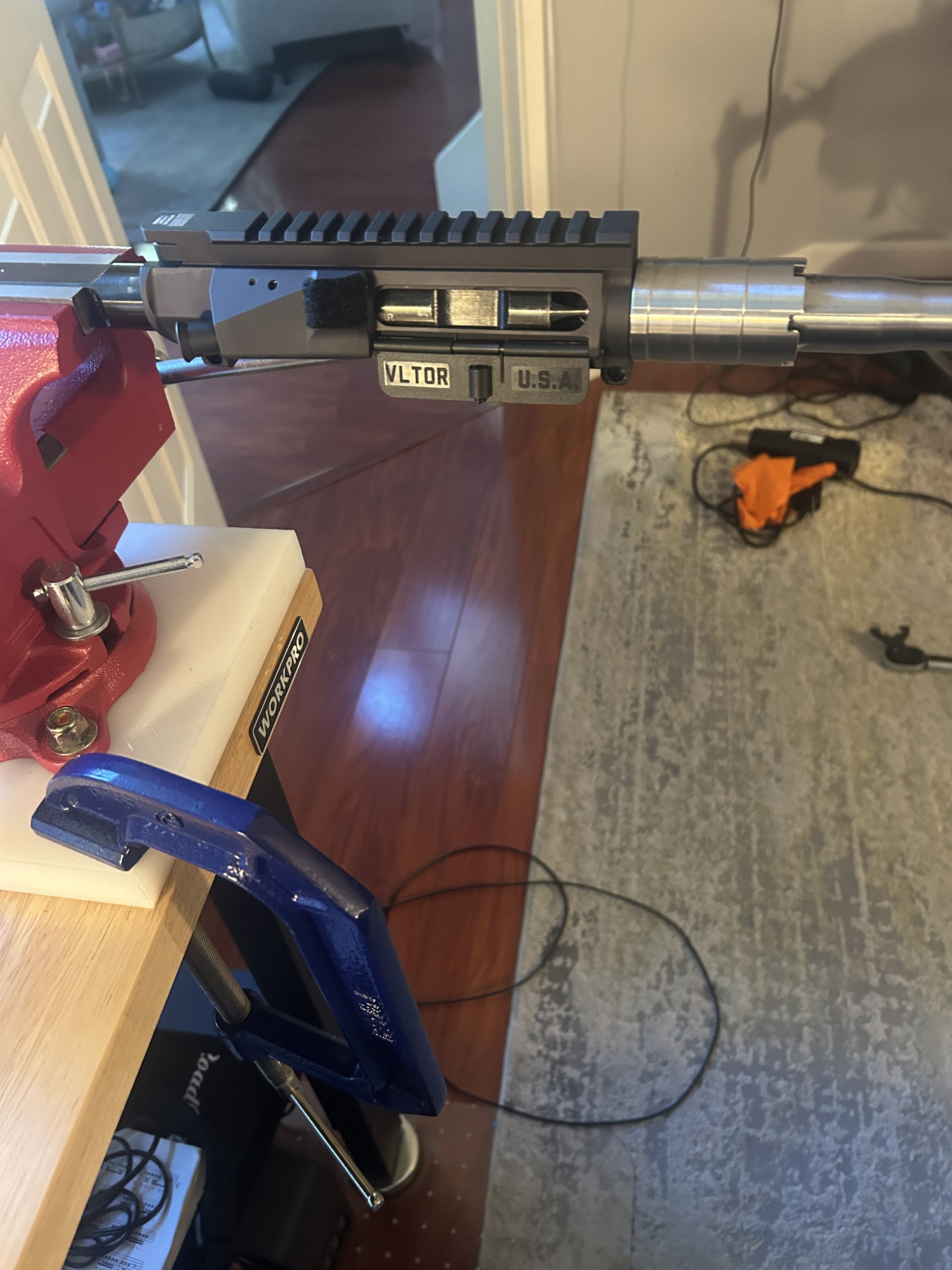

Heads up that I have a 16” core barrel and Vltor MUR upper and the fit to the upper is very sloppy. Def needs shim/bedding for best accuracy but for R&G you’d be fine
Not exactly what I want to hear about a $500 combo.
What ended up working for you?
Yeah I was pretty bummed. I tried the core barrel in a demo bcm upper (thermofit) and the sloppy Vltor upper and there wasn’t really a difference in accuracy (1.5-2” 10 shot groups at 100 yds with 77 smk handloads) with the same 13” kak handguard. I ended up getting a third upper which was a SOLGW forged and a different barrel -> Craddock RTR 16 inch MK 12 mod H barrel and solgw m89 rail. I’m gonna see how this combo works and I will use the core barrel as a back up/spare. I was getting close to finding an accuracy node for the core barrel so maybe when I have some more time and enough components I will give it another try by bedding it into a spare upper and see if that helps.
Gonna use the Vltor upper on a 6 arc build and use a shim. Once solgw broadsword uppers are back in stock I will swap that in for the Vltor (I want to pair both my SOLGW m89 rails with solgw uppers). Here’s the vltor upper with the PVA Osprey 6 arc barrel:

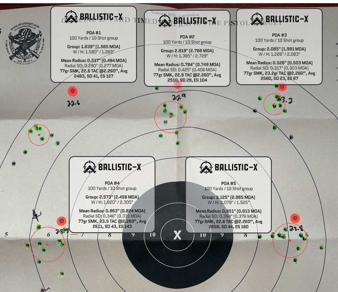

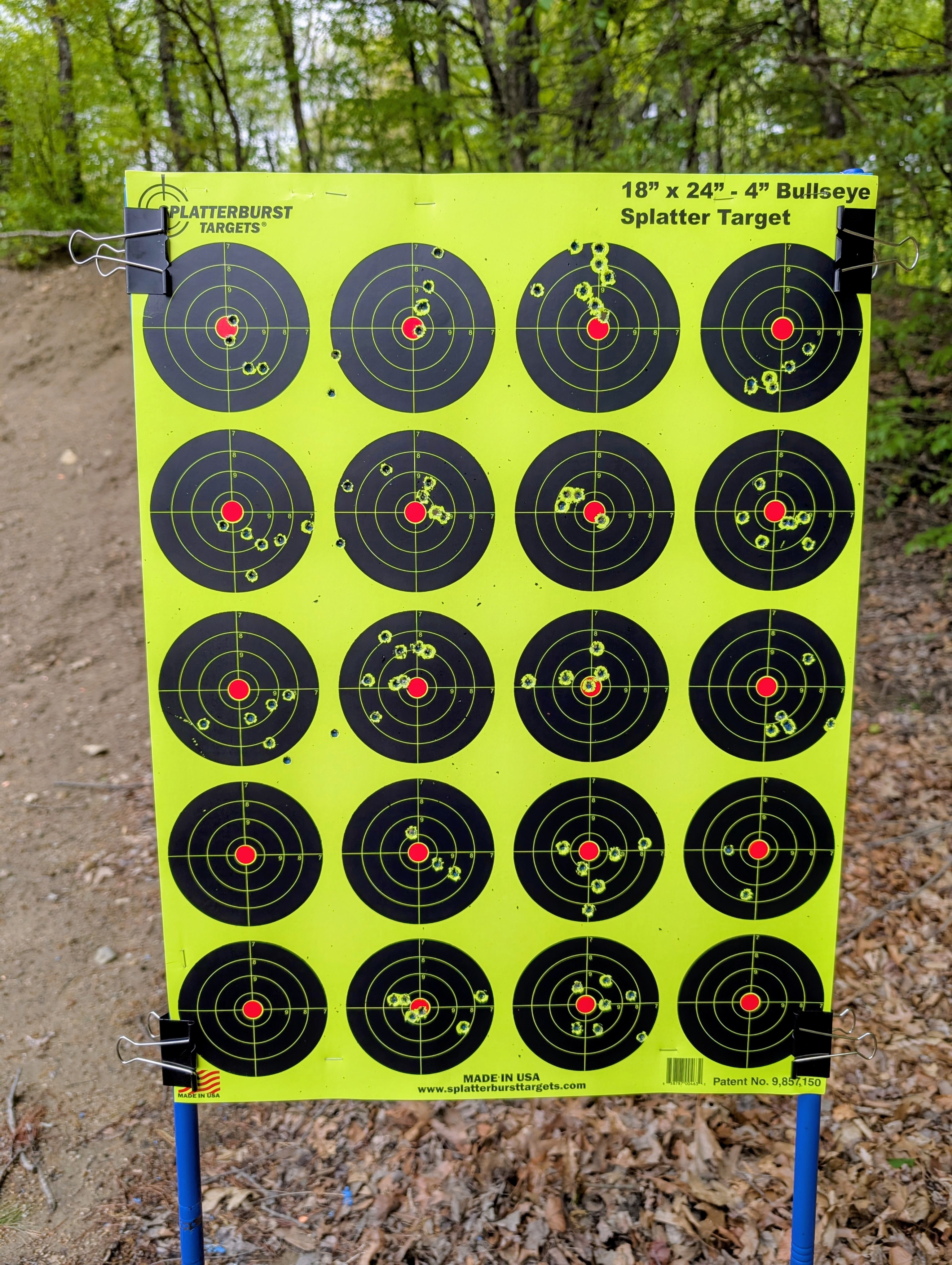

The below is my best set of groups for the core barrel in about 300 shots:
Reactions: faylix
I tried a range of ammo to try and find what worked for my criterion barrel.
The type lines up with the target in vertical lines. 100 yards from a prone rested position.
This was with the Larue Ultimate upper. Going to throw my white oak barrel in there when she comes.

The finish/machine work on the MUR was very nice but to give you an idea of how loose it was, the inner diameter of where the barrel extension slides in measured at 1.003”. This was about a 4 thou delta to the core’s barrel extension diameter. When I slid the core barrel in it was like a hotdog going down a hallway. Keep in mind this is a sample size of one though and I think a shim/bedding would have tightened it up maybe an extra 0.25 to 0.5 inches

Vltor uppers are nice, but of the several that I've used, none were are a snug fit on a variety of barrels, slip fit at best.
So if you really like Vltor uppers, trueing the face & loctite is your friend.

+1 on this. They must make the vltor uppers assuming people will shim/bed the barrel bc they are super loose. I had to add a 1.5 thou shim to my barrel extension before it was tight enough for me to not be able to slide it in by hand (I ended up doing a thermofit with the shim).

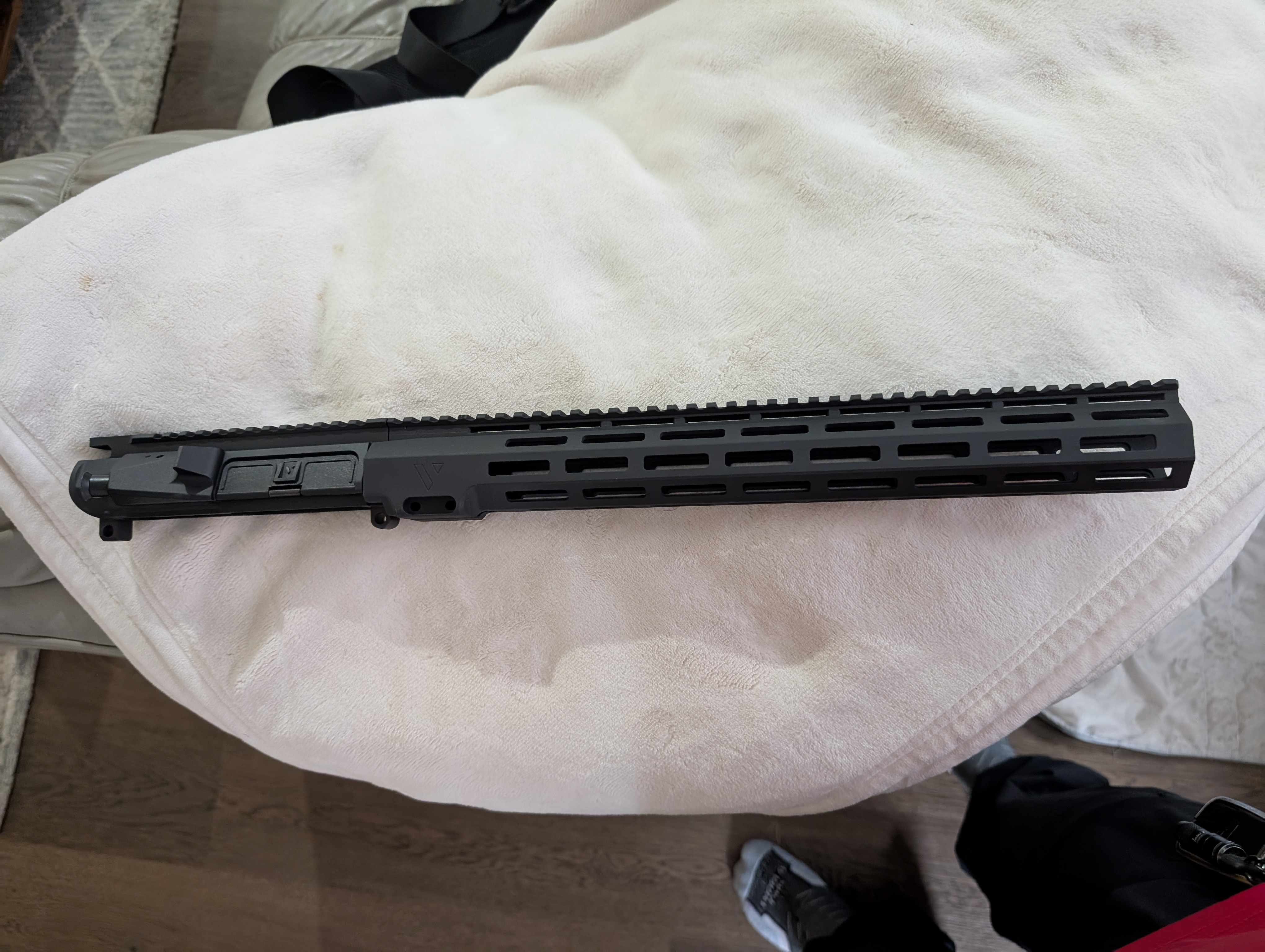

My vltor upper receiver and rail came today. First thought is they look like they were inspired by stealth aircraft and I'm here for it.
My noveske ddf barrel should be showing up sometime today, so while waiting, I hand lapped the upper receiver for Maximum squareness.
More updates to come!
