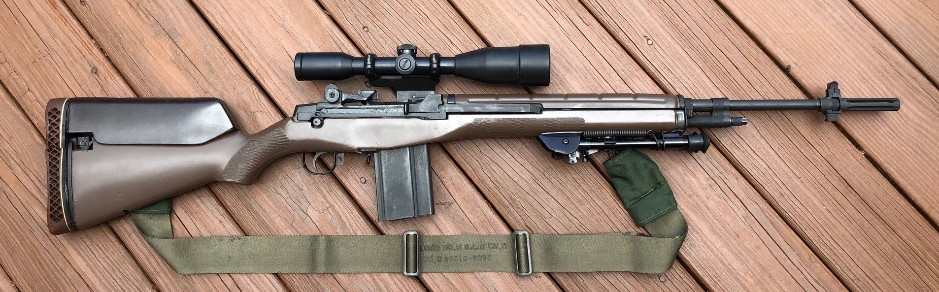

I generally prefer US military items, but I made an exception for this replica as its kind-of unique looking. One other interesting historical analogue is that the US Army 'officially' replaced the M21 sniper rifle in favor of the M24 SWS in 1988, but the IDF kept using their M14s snipers until they too were replaced around 1997 with the same rifle, the Remington-made M24 SWS. Here's some project pics for anyone interested:

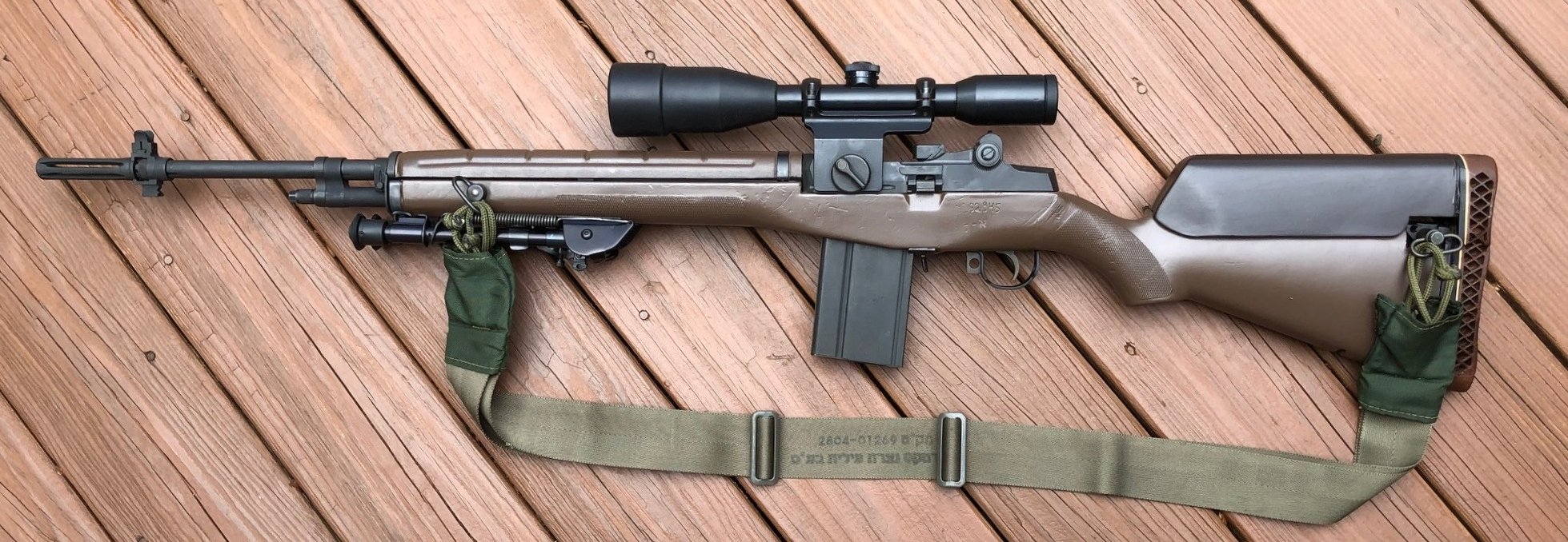

Here’s a picture of the rifle when it was in service.
7094561

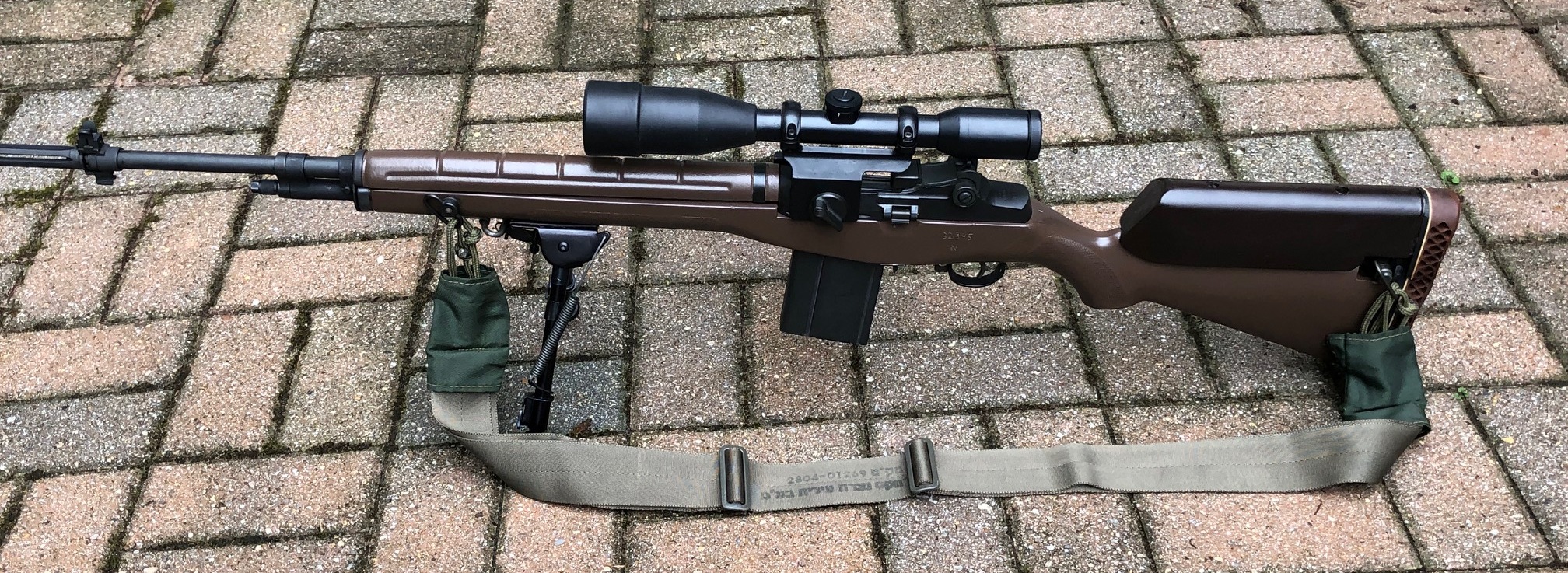

First, given that my IDF scope had been painted/re-furbed at some point, I decided that a light re-spray of the vintage IDF stock would probably be okay, but normally I would leave a vintage stock as-is. My sling is pretty fresh looking too. So, other than wear on the buttpad and minor blemishes on the stock from military use, this replica looks like an IDF M14 sniper that just came out of an arsenal re-build circa mid-1990s. Left side (complete):
7094562

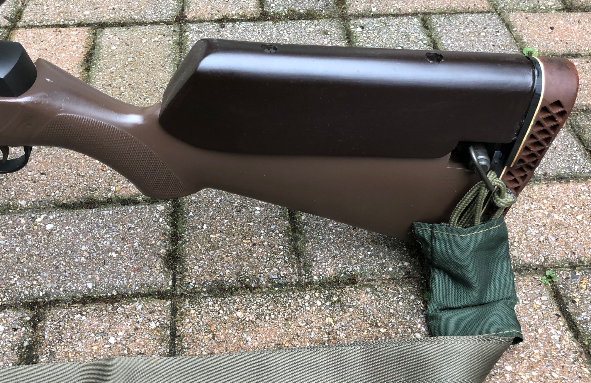

Unique IDF cheek piece is bolted into USGI stock via two long threaded bolts. Its huge and ungainly looking, but ergonomically it works. Note the para cord securing rear sling to rifle. I didn't paint the cheekrest. It had been previously roughly sanded while in service, so I simply added two coats of clear satin enamel finish to slightly restore it.
7094563

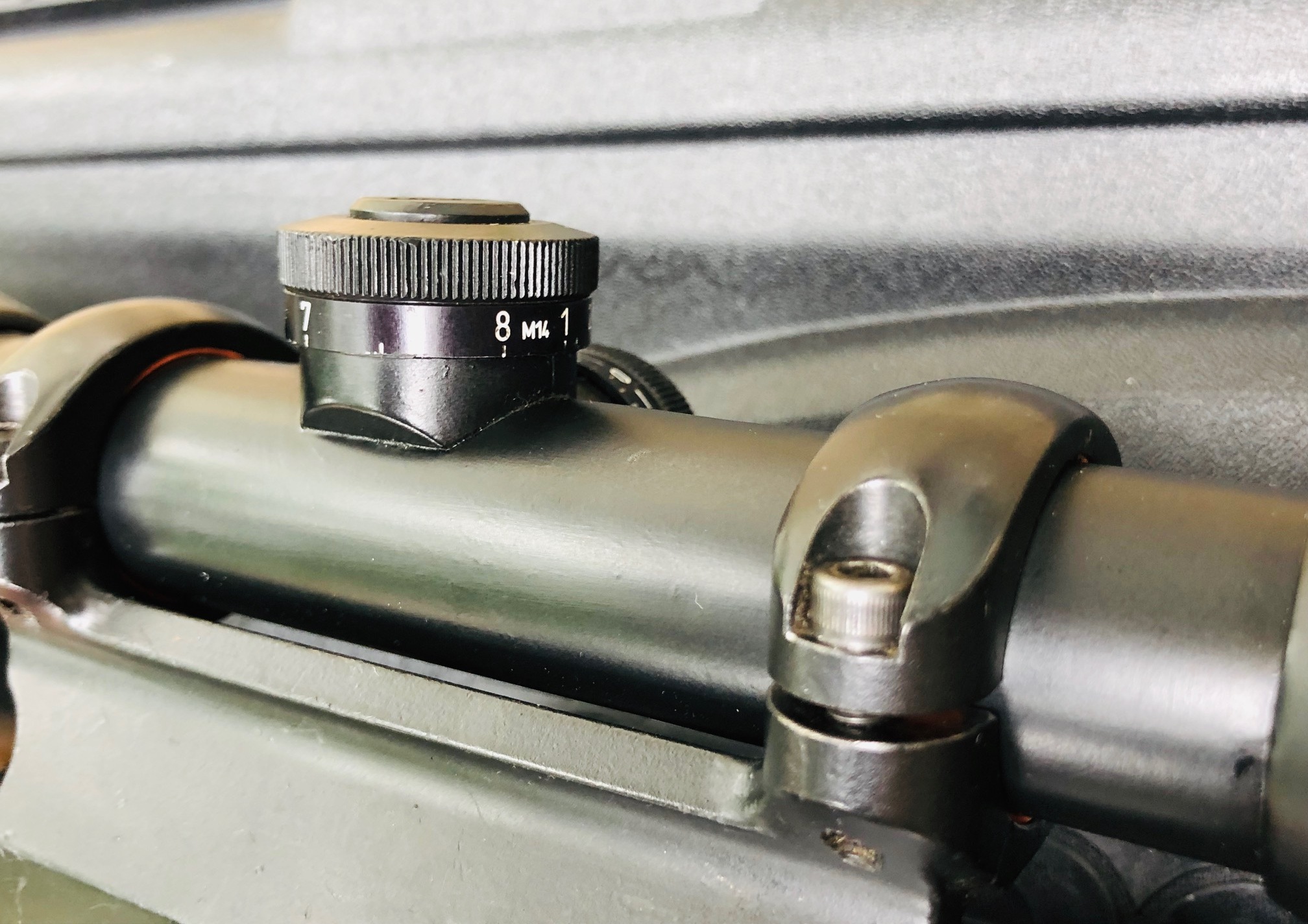

Scope elevation turret marked "M14" with a BDC from 100 to 800 meters:
7094564

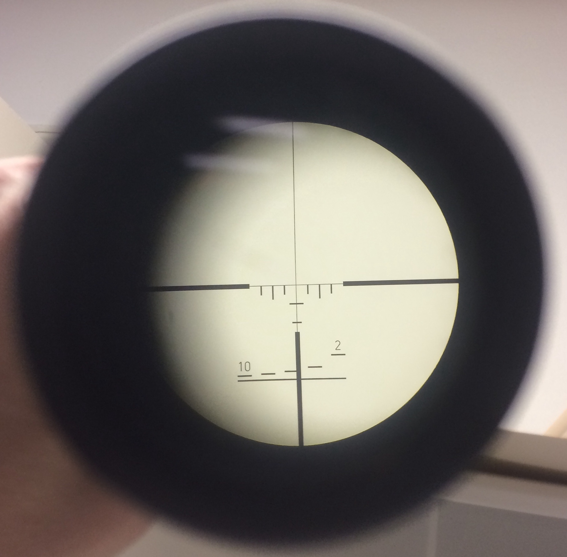

Range estimation reticle:
7094565

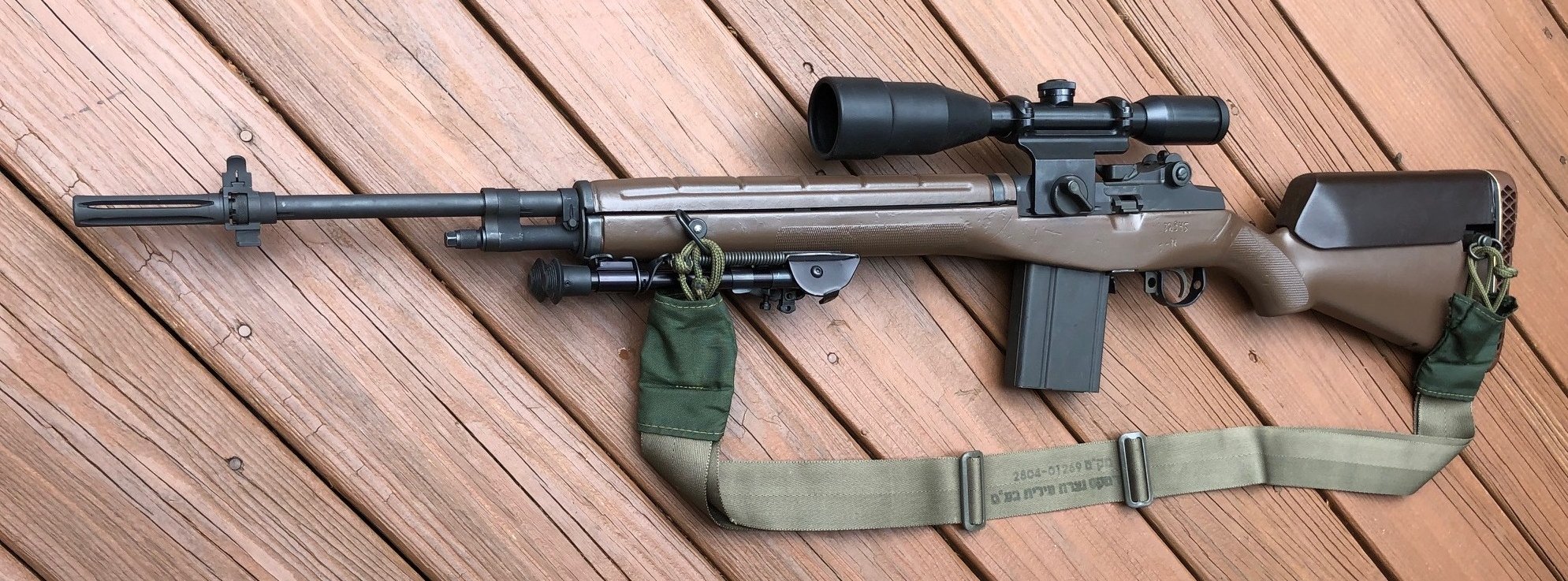

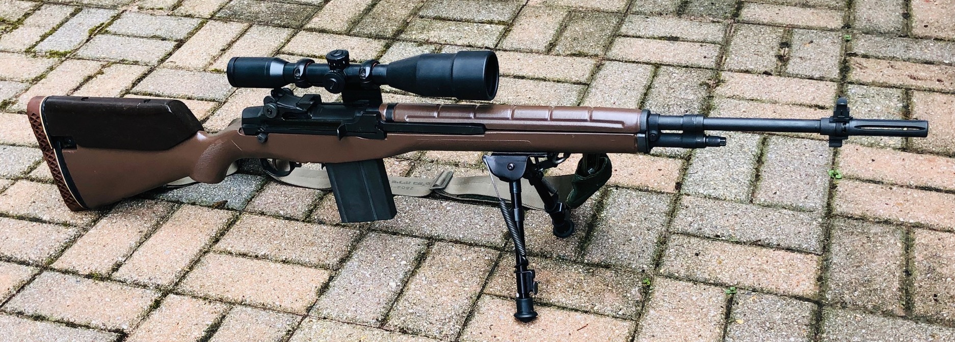

Right side:
7094566

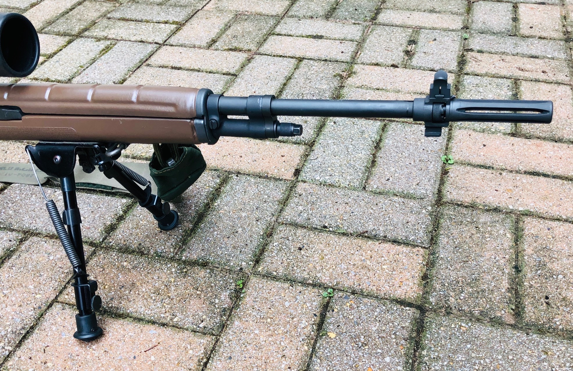

Barrel is a medium weight SAI barrel. Front sight is a standard part, but I did use a NM flash hider. Gas cylinders were not unitized on the original IDF sniper rifles, but I plan on doing an AMU-type unitization for this project.
7094567

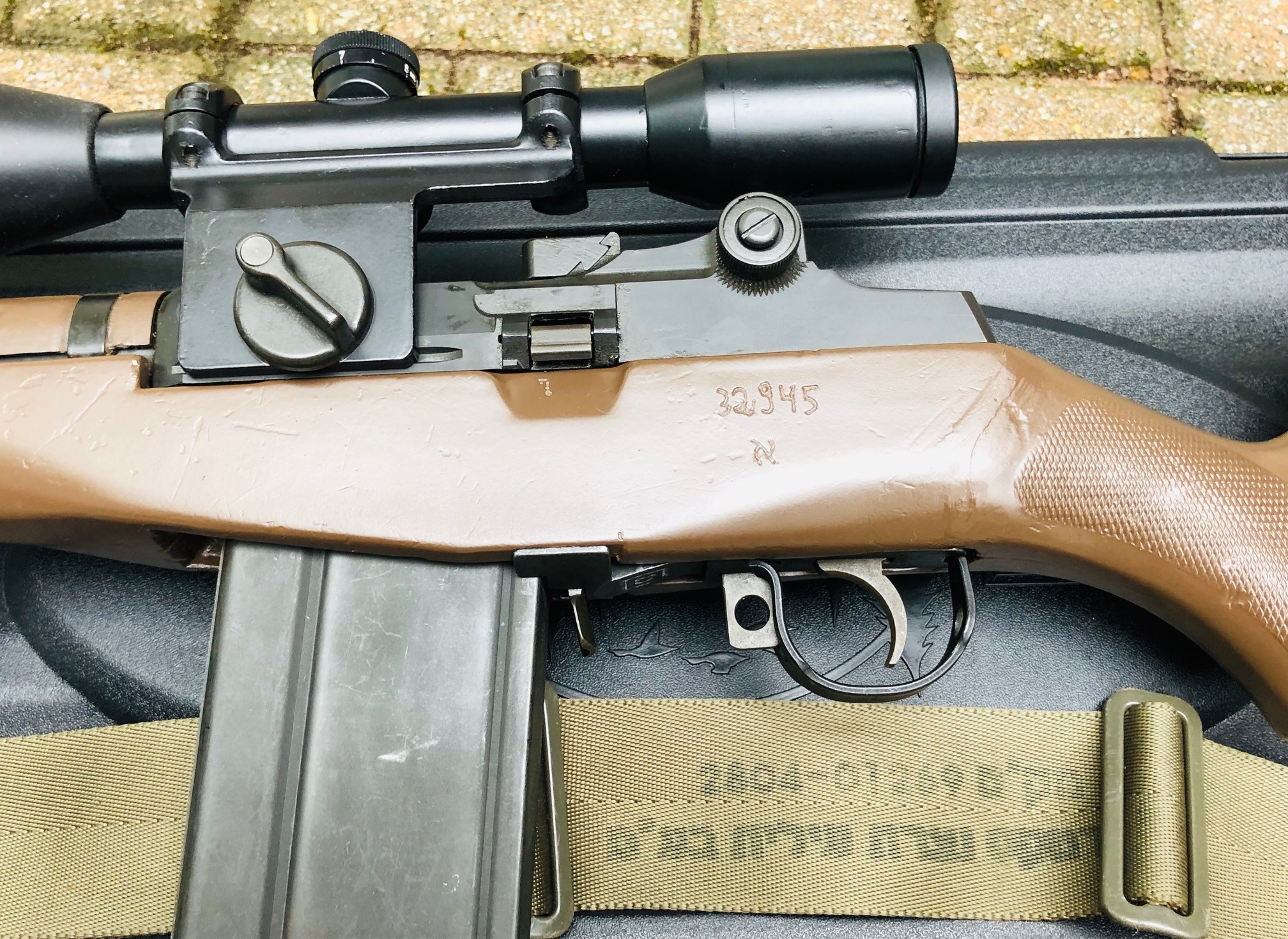

You can see the original M14 serial number of the IDF rifle here, and also some writing on the vintage IDF sling (I don't know any Hebrew, so I can't read it):
7094581

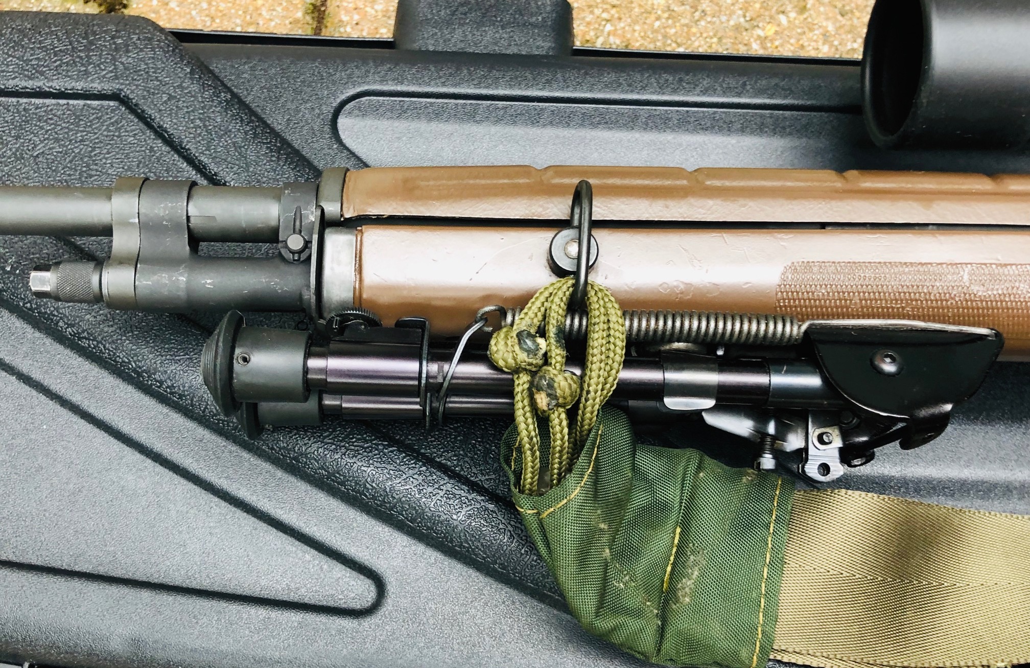

Interesting use of double para-cord to secure the sling to the rifle (this is original):
7094570
Anyhow, this was an ad hoc project for 2019 due to the purchase of the IDF scope on eBay. It turned out okay given the budget.
7094794
So now it just needs a trigger job, a unitized gas cylinder, and fitting a gas lock so it times up correctly, but otherwise its basically finished. I do not have a range report on it yet, but I'll take it out sometime this summer and see how it shoots. Just an fyi post regarding a replica of somewhat unusual vintage sniper rifle.

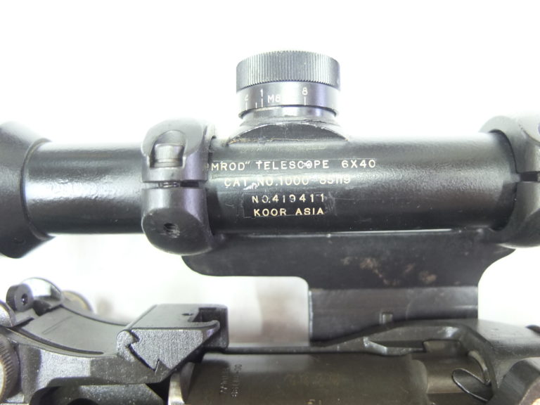

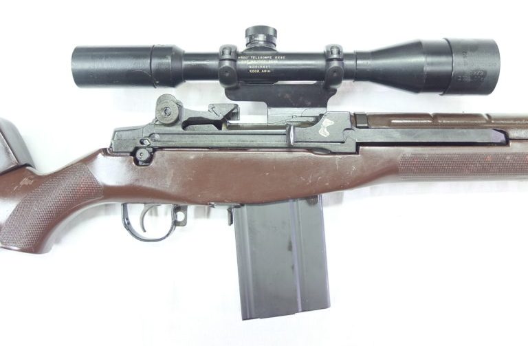

Regarding what load, my scope turret only says “M14,” but some IDF Nimrod scopes used from mid-1980s to early 1990s have “M852” on the elevation turret re the BDC, so presumably that was the standard for a while. (168 SMK bullet at approx 2550 FPS). I gave heard of - but have not seen - Nimrod BDC turrets marked “M118”. That’s all I know...
ON EDIT: I found a picture of an IDF M14 sniper sold on an Italian website a couple of years ago, and I noted that it has one of the Nimrod scopes with the turret marked 'M852' - just an fyi to confirm that IDF used match ammo with these rifles.

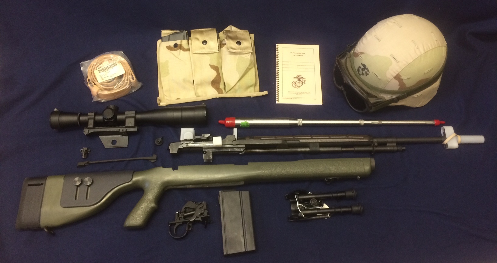

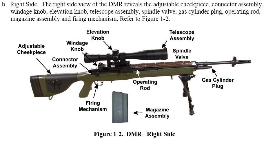

Thanks for the kind words. The IDF M14 replica came together pretty easy as it didn't require glass-bedding.
I have a couple more US-based M14 replica sniper/DMR rifles that need to get bedded...and thus I have to wait on builders.
