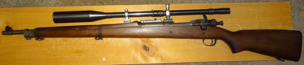

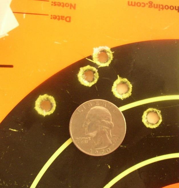

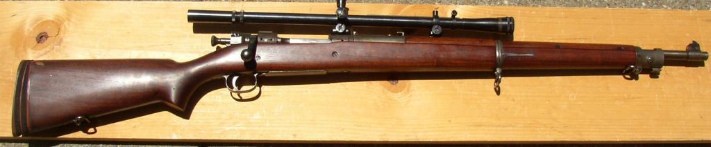

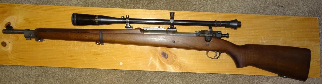

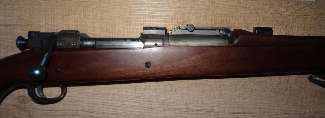

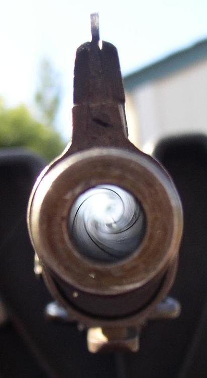

A few years back I grabbed this sporterized high-number Rock Island 1903at an auction with the plan of converting it into a 1903A1 USMC sniper rifle suitable for the CMP vintage sniper matches. My sons and I are planning to shoot in those matches.
It had the C stock and the scope mounting blocks already mounted. . The barrel was pristine and interestingly, is a less common Sedgeley.
I was satisfied this was a decent shooter after my son shot 100 yard groups like this with the Redfield sight that was mounted on the gun.
I mounted an 8x Lyman Targetspot Junior for some long range work and the rifle shot very credibly at 550 yards.
I have run into some issues, however. Turns out that the C stock, a required element of the rifle, had been cut too short to use. The 8x Lyman scope, while legal, is so dim that it is far from optimal for use in the match. The scope blocks were good and properly drilled and tapped, but also were not optimal for the match. Bottom line, it needed some work. After a new stock, new scope blocks, the addition of a few missing parts, I got this...
I also bought an 8X Hilux reproduction Unertl scope, but discovered issues with it and had to send it back ti HiLux for repairs.

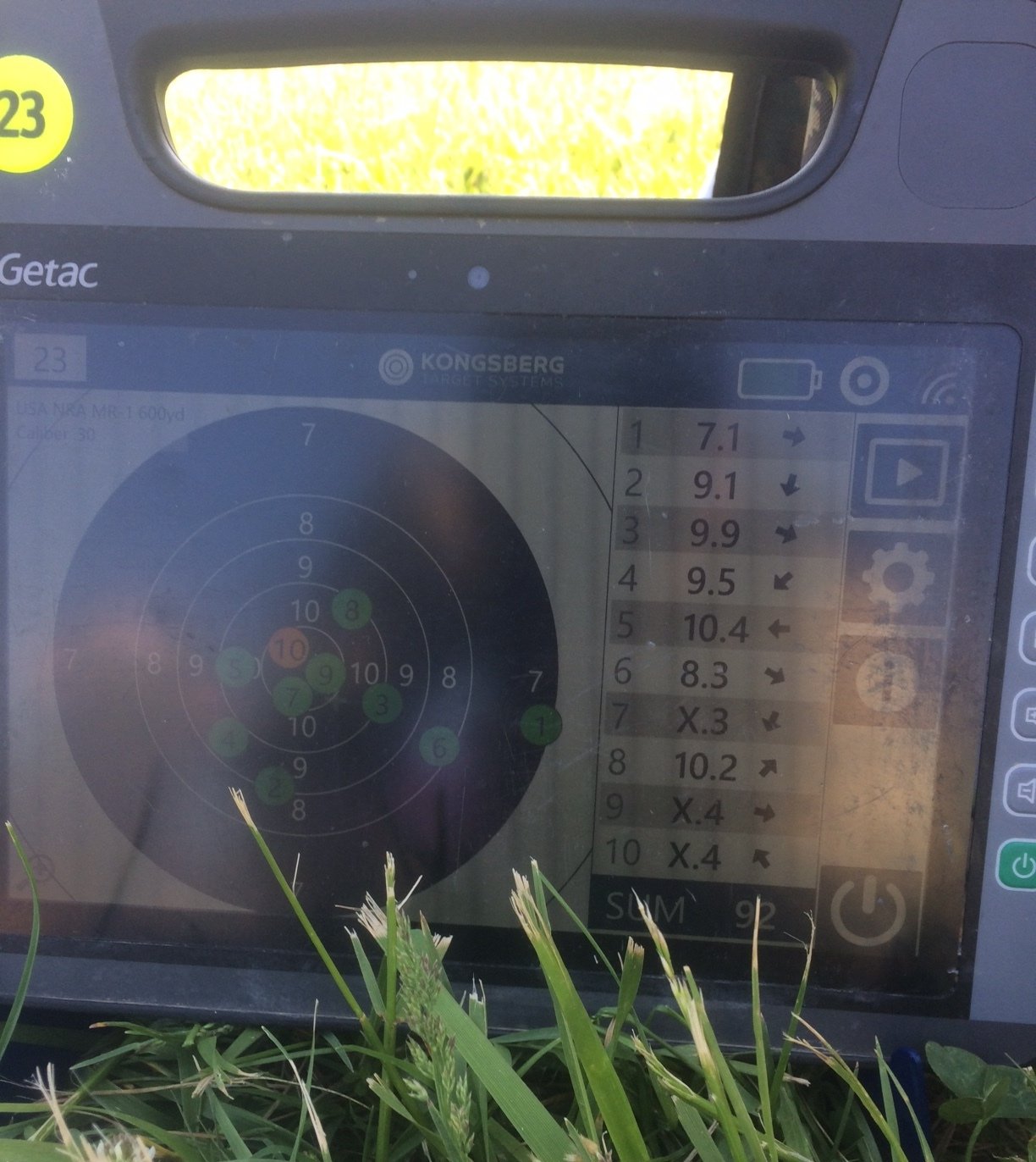

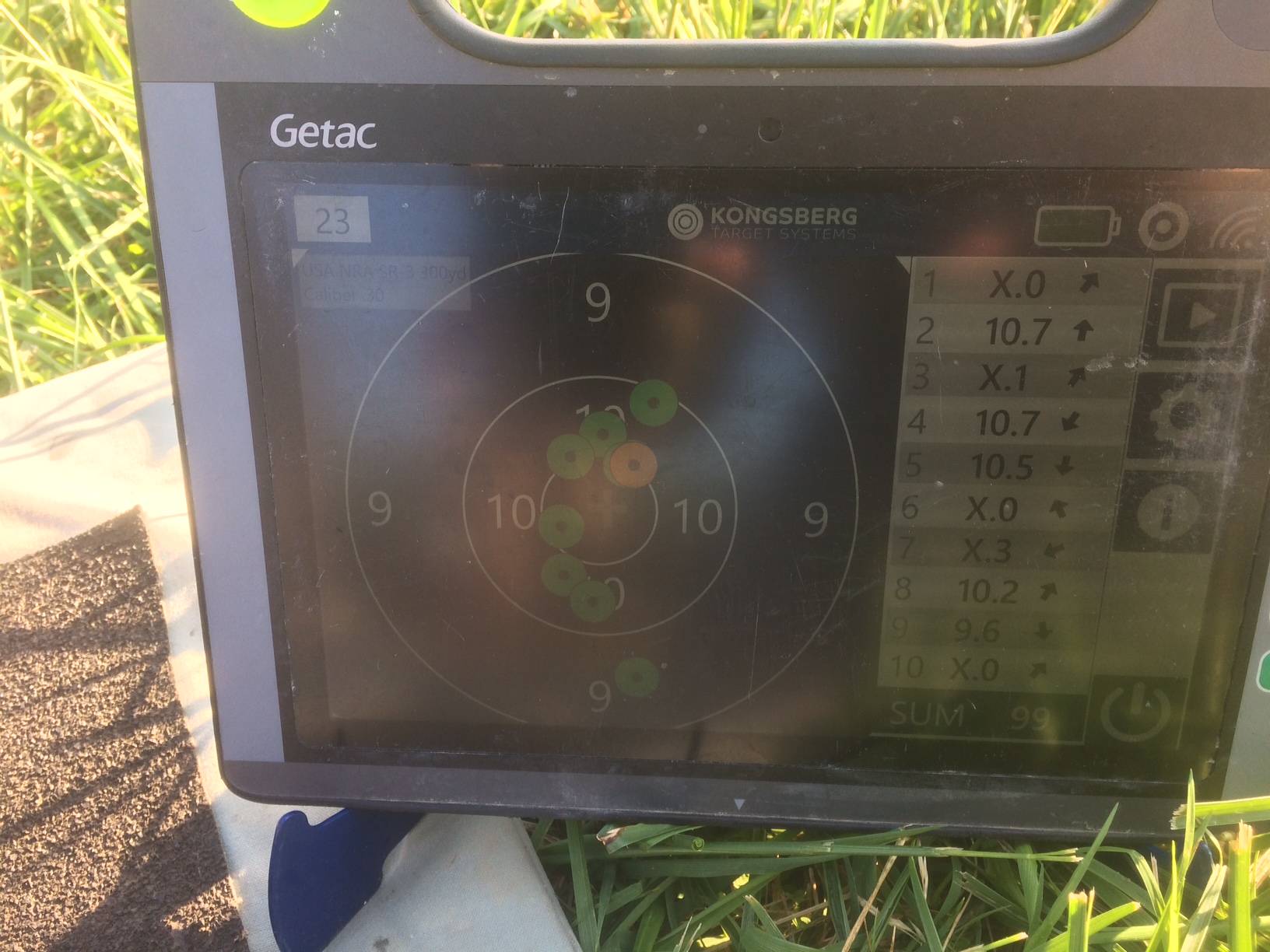

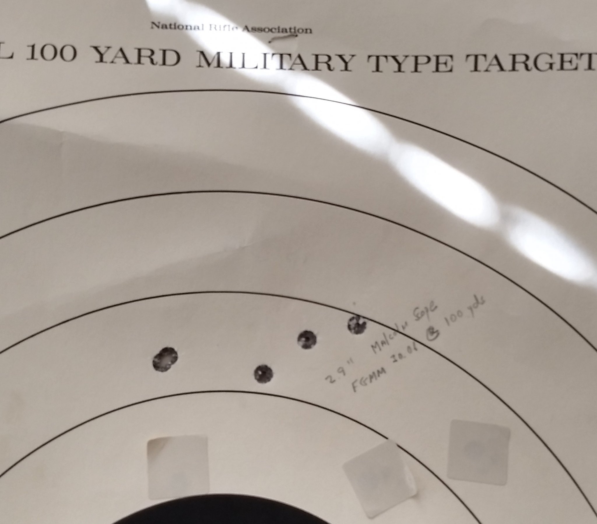

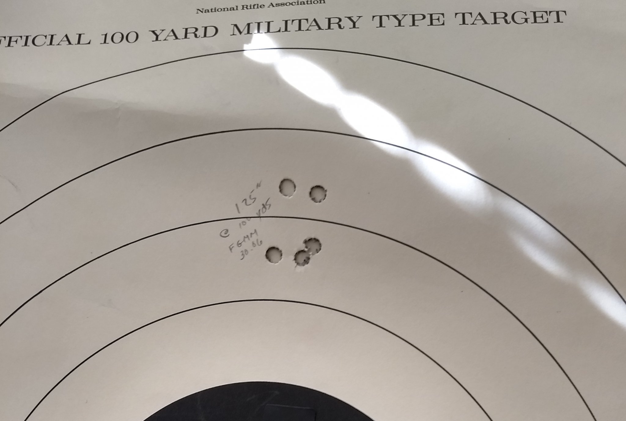

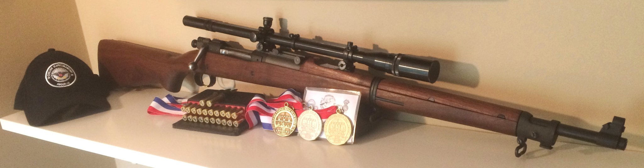

I have used my Springfield 1903 w/ Leatherwood 8x scope at CMP vintage matches since 2012. Its a fun event. The scopes are pretty good but the mounting screws can be a little soft, so that is worth swapping out, but otherwise I haven't done anything to mine over the years. In fact, my 1903 with 8x scope is probably my favorite vintage rifle that I shoot. (along with my M1 Garands)
With match ammo, and if I do my part, it will hold the 10-ring at 300 yards and often at 600 yards too....unless I embarrass myself and somehow pull my first shot at 600 yards and hit the 7-ring, which I did at the CMP Eastern Games in NC (May 2019). Opps...I'll try not to do that again..
I also bought an 8X Hilux reproduction Unertl scope, but discovered issues with it and it is currently back at Hilux getting repaired.

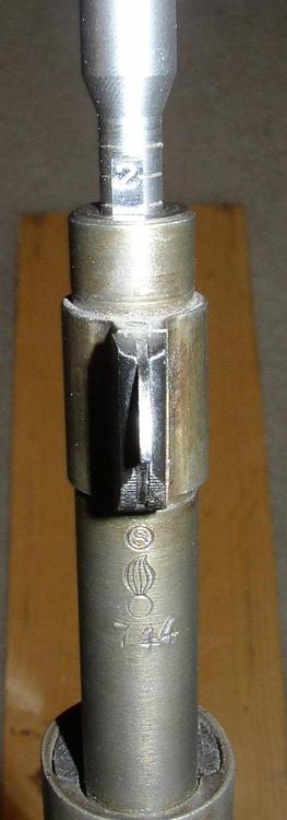

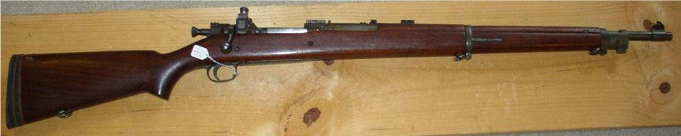

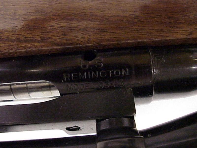

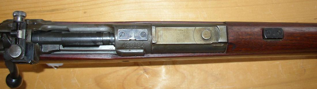

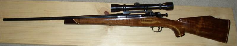

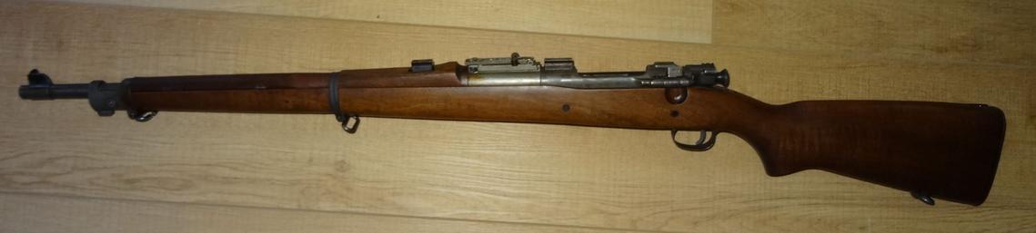

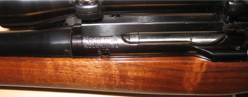

I 've got a repro Swedish Mauser M41B that I had put together and it shoots pretty well. Of course, the 4X Weaver gives up a lot to the 8x "Unertl".
I've also got sported 1903A4. It still has the original (I assume) barrel, as well as the bolt and scope mount. It has been blued and put into a nice White Line sporter stock. I've thought about restoring that for my other son to use.

And if I'm not mistaken, you have a real 1903A1 sniper rifle.
I actually have been very, very blessed to find one of each variation that I could afford. But I bought them before really a lot of research was done on them, so I got them really sort of cheap. But I have one of the NM and and one of the Special Targets that were built into the Unertl Snipers.
Hey Ramdom
What is that target system you are sporting in your photos? How does it work?
Eye on the "6"
"6"
"What is that target system you are sporting in your photos? How does it work? "
CMP started using these electronic targets in 2017 and they are awesome. Made by Kongsberg Target Systems (KTS) of Norway. If you google “CMP electronic targets” you’ll see several articles. For example:

Cool! Thanks!

I got behind on this project, but finally received the scope back from Hilux, supposedly repaired. Last week I took the rifle to range, where I mounted the HiLux scope and found that the cross hairs were canted about 45 degrees off plumb. Damn!
Has anyone else experienced this problem?
I called HiLux and they explained that I could loosen a couple of screws on one of the rings and plumb the reticle. Has anyone done this before and if so, any suggestions on the best way to make sure the reticle is level?
I went ahead and fired the gun at 25 yds as is and found the rounds hit far to the right. I adjusted the scope until the hits were centered, then moved the target back to 75 yards. I couldn't get the rifle to group very well and finally removed the scope and fired 5 rounds of the Federal Gold Medal Match using the iron sights and was rewarded with an approximate 1" group. So Chuck , the gunsmith, did a fantastic job with the rifle. Still working with HiLux on the scope.
@75 yards. Pasters covering 25 yard shots, unpasted holes @ 75 yards with scope, small group in upper left shot with iron sights @ 75 yards.

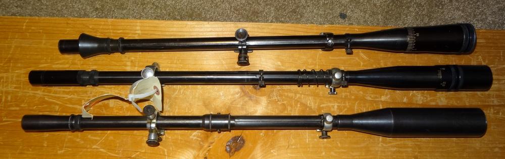

The thing that kills me is that I have a Lyman Super Targetspot and a Fecker which both look better than the HiLux, but are unmarked as to power. I would gladly use them if I could determine that they are of legal power.
I also have a Litschert Spotshot, but it is marked "10 power" and needs a new reticle.
Went ahead and mounted the Fecker and the Lyman, just to see how they looked.
