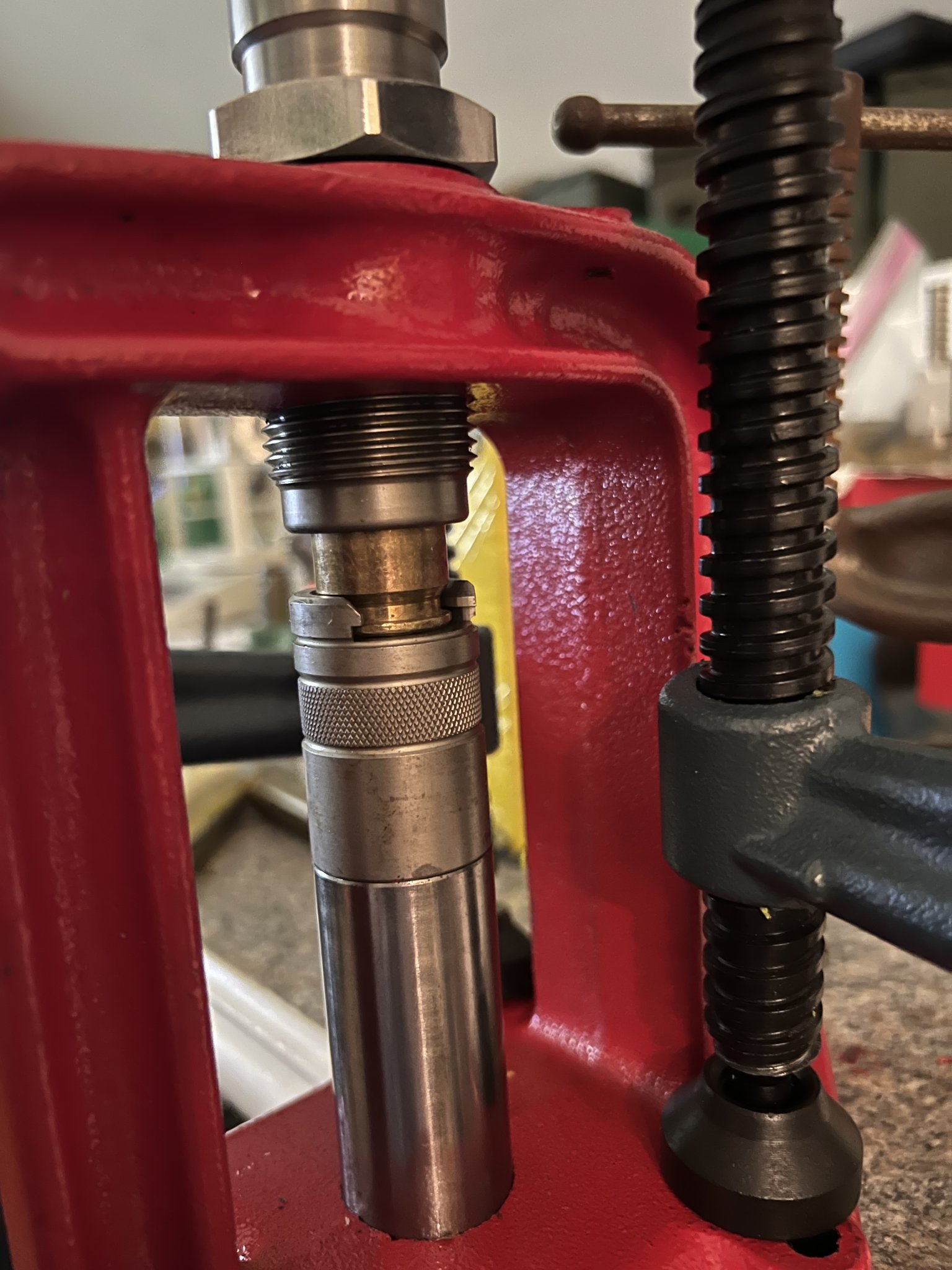

Hey, guys, so I have 1300 cases of once fired mil brass. It’s way oversized and out of spec, no matter what I do I can’t get it to run through my lee dies and I cracked a 2x10 I was using and my table as well(partially). I didn’t know why I was having so much trouble but now I’ve figured out that the cases are just blown out a lot.
I have no idea how I can mount a press to where I can actually apply enough force to resize these cases, I might need a hydraulic press or just a table that can actually handle the amount of force required without bending.
I’m at a loss here, I’ve already invested so much into the cases and primers and powder and rifle.
Any help would be appreciated, especially someone in the area with a sturdy enough press for me to borrow or rent.

I’ll, be honest, I doubt I will eat up through 1300 rounds of 50 so if I can load these once I’ll be happy.

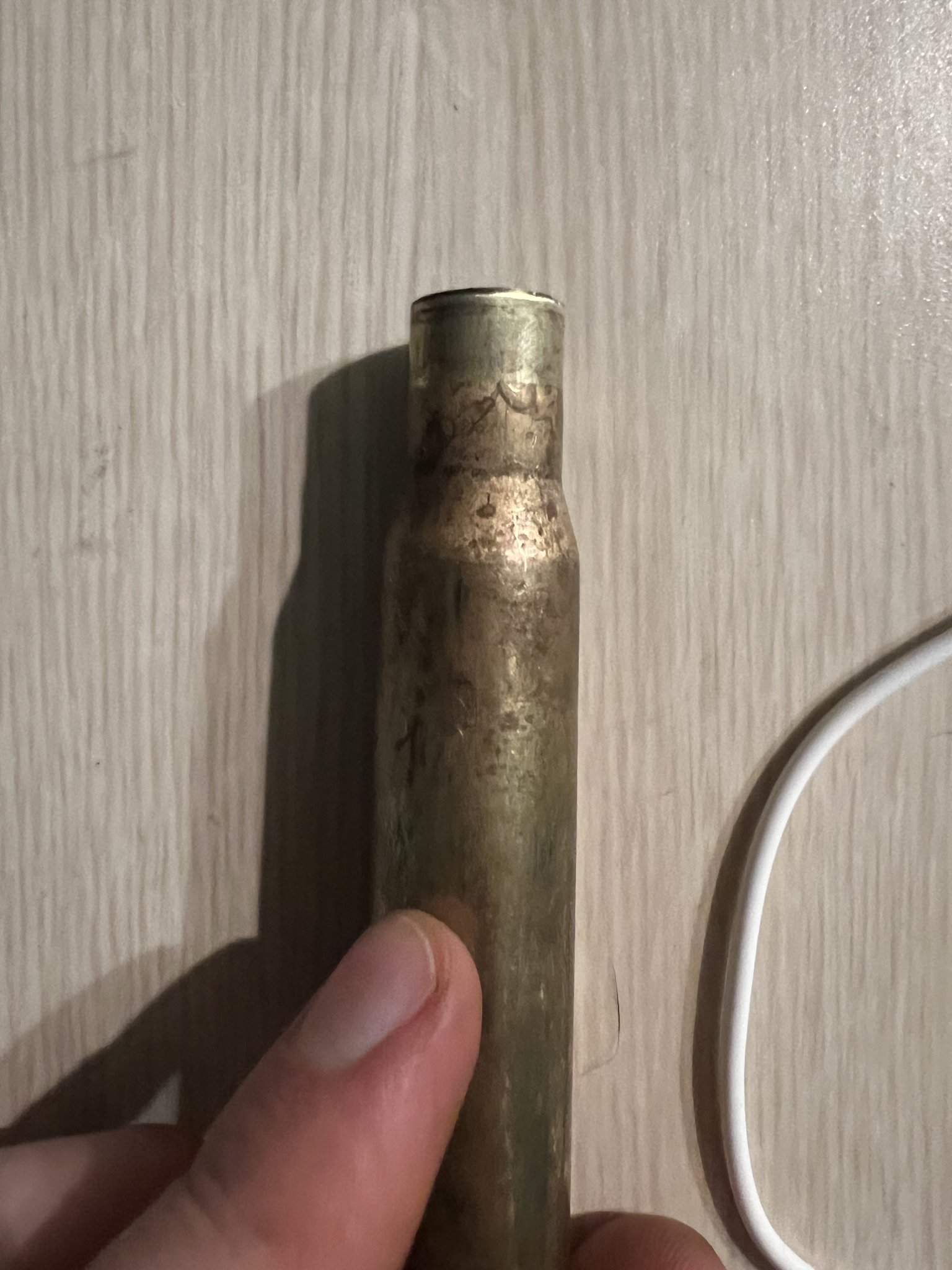

Anyway, I’m not even sure it’s the necks that’s the issue. The base is what seems to be really way overblown. I can get it easy enough half way down, or actually more like 85 percent maybe 90 percent down but the base is just oversized by a lot. Here let me show you.
I broke the 2x10 and the table cracked! I cannot apply anymore force to get that last little bit and pop the primers out.
I’m thinking of finding brass processing companies to ship this to so they can resize it and remove the primers.
That brass is fuggin ugly. Looks like you covered it in sand and bbq sauce. Clean it a bit and you’ll have less friction.
Also, take some actual measurements of the neck, shoulder and body diameters, fired and sized, and compare. Your answer is in the numbers. Compare to the chamber/reamer print.
Reactions: camocorvette
What headstamp? Does it have the year? I've got some really old 308 and 06 from the 50's-80's that needed to be anneled because it was so hard. I literally could not size it. Got stuck in the die and had to cut it out.
Anneled it and bam it sized like butter. But then the necks split after firing haha.

You may need to resize in increments using an oversized die first.
