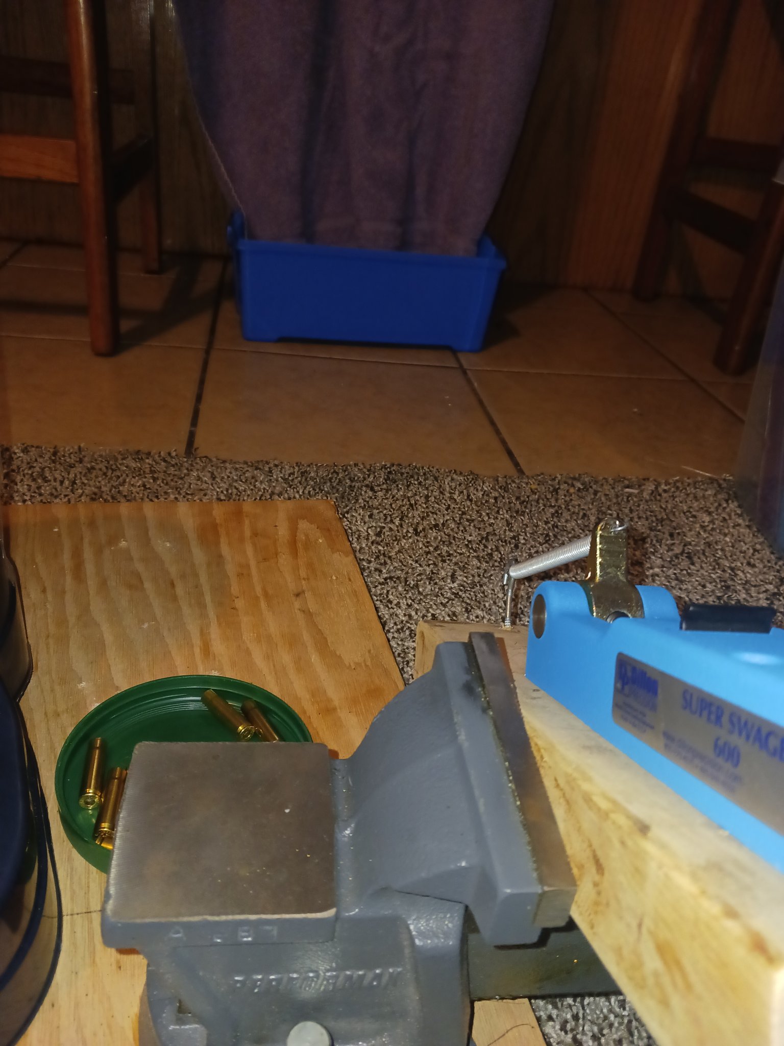

Don’t forget to swag your primer pockets. Problem with range brass is some of it may have a military crimp and other brass doesn’t. You start loading on a progressive and unswagged brass with screw up the works.
You probably already know this but just a reminder!
I hooked up a spring to my Dillon swager and turned it into a speedy little catapult.
Anneal, swage with Dillon,[if required],small base die and you are good to go. Annealing every time makes ALL brass effectively the same. Before commencing SSM all brass. Cleanliness is next to Godliness.
