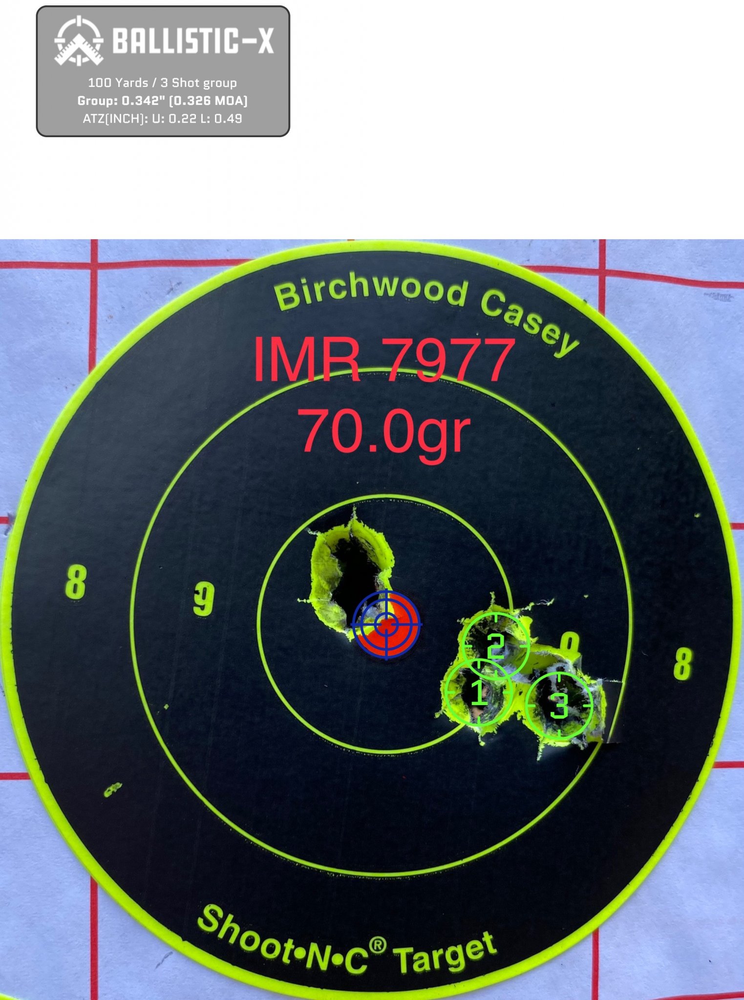

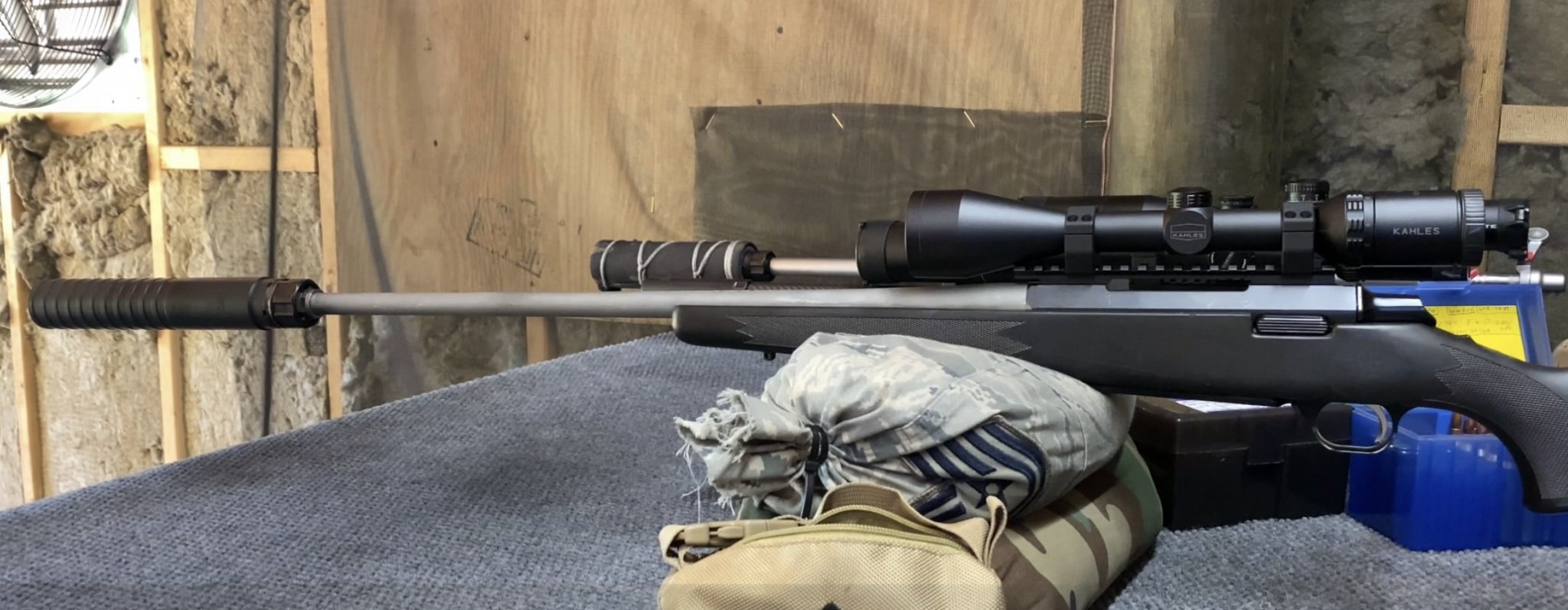

I sure have... I took a good, nearly new, (proven shooter) stainless Remington 700 26" magnum sporter 7mm RemMag barrel, and had my smith turn the barrel tennon down to the smaller metric size of my Browning A-Bolt II 7mmRM that I had burned the barrel out of. That was about 10 years ago. That rifle/barrel was always a shooter, and after the rebarrel it was around a 1/2" rifle with handloads.
Recently (in the past few years) I've finally gotten into the suppressor game, so I had my smith cut that same barrel down from 26" to 22.5" and thread it 5/8-24 for running a suppressor. That rifle still shoots amazing...Hell, it shoots even better than it did before, due to the increased stiffness after cutting it down 3.5", and sticking a precision rifle can on the end of it. It still puts down sub-1/2 MOA 3-shot groups (magnums I don't shoot 5-shot groups due to heat).
Here it is after cutting and threading @ 22.5" with an Otter Creek Labs Hydrogen-L suppressor. This will be my lightweight deer setup from now on...Except, contrary to the picture, it will be direct-thread, and not running the heavy KeyMo QD system. That was just for being able to easily test my different cans.
Ignore the 2 shots stacked on the bull, those were confirmation shots after re-zeroing my scope, after finalizing load development (the 3 shots in the measured group). 😉
