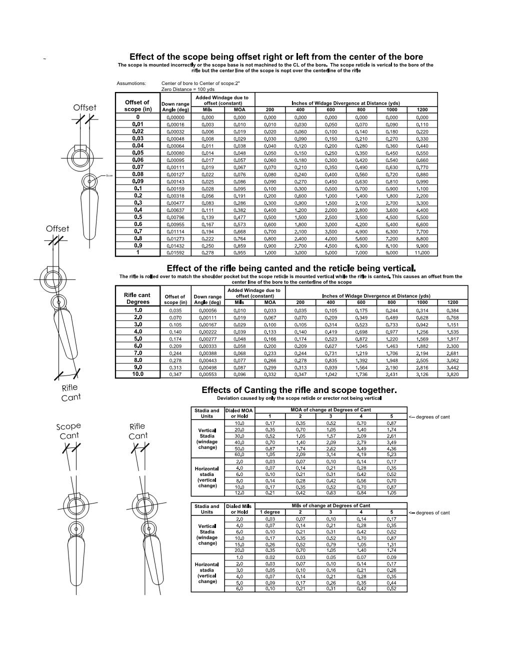

Much bigger errors from canting the gun with a scope leveled accurately to the gun than from a scope being canted a bit in the rings with a level gun.
Somewhere on here is posted the math that somebody did on this.
Oops, see attached and below
  • Reticle vs Rifle Cant Analysis.pdf
Reactions: Herb Stoner
Thanks for the share. This is actually quite helpful and takes a load off my mind because of some error figures I read about earlier (17.6 inches of error at 500 yards on a 2° scope cant) are way worse than what you're showing me, buuuuut now I doubt I even want this swiveled Harris bipod anymore regardless, after seeing this haha.
