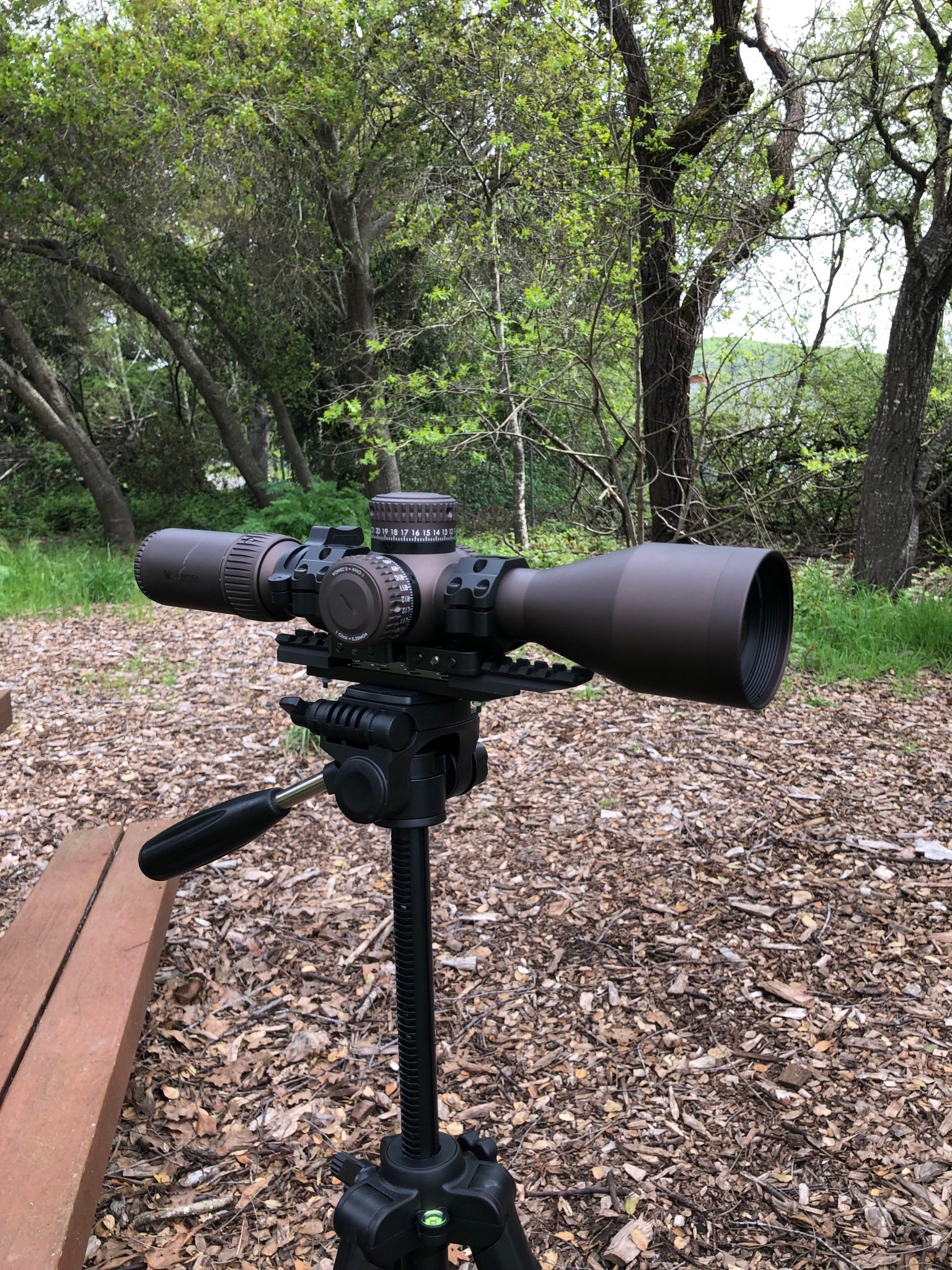

What I do when setting up a new scope:
What you need:
- I have a plate that attaches to a tripod and has a pic rail mounted on it - $15 camera plate on Amazon
- An anti-cant level for your scope
- Rings (of course)
- A weight
- A brightly colored rope or bungee
- A tripod
1) Put the rings on the scope, slightly tightened
2) Put the anti-cant level on the scope, loose - not tightened
3) Hang the weight from a tree limb, ladder, whatever with the brightly colored rope or bungee. Do so at a distance equal to or greater than the scope's minimum parallax.
4) Put the rings/scope onto the plate/pic rail and put it on the tripod.
5) Point the scope at the rope, and align the vertical line of the reticle with the rope
6) Adjust the anti-cant bubble level until it is level - make sure the scope reticle is still aligned with the rope
7) Once aligned, tighten the bubble level.
Now the anti-cant bubble level is aligned with the vertical line of the reticle. This is the critical thing to do.
8) Go back to your gun vise, mount the scope onto your rifle, loosen the rings
9) Put a level into your action and twist your rifle until it is level
10) Twist the scope in the rings until the scope's anti-cant level is level/aligned with the level in the rifle's action
Here is a pic of my plate:
Reactions: Jscb1b and TACC
What you need:
- Rings (of course)
- A weight
- A tripod
