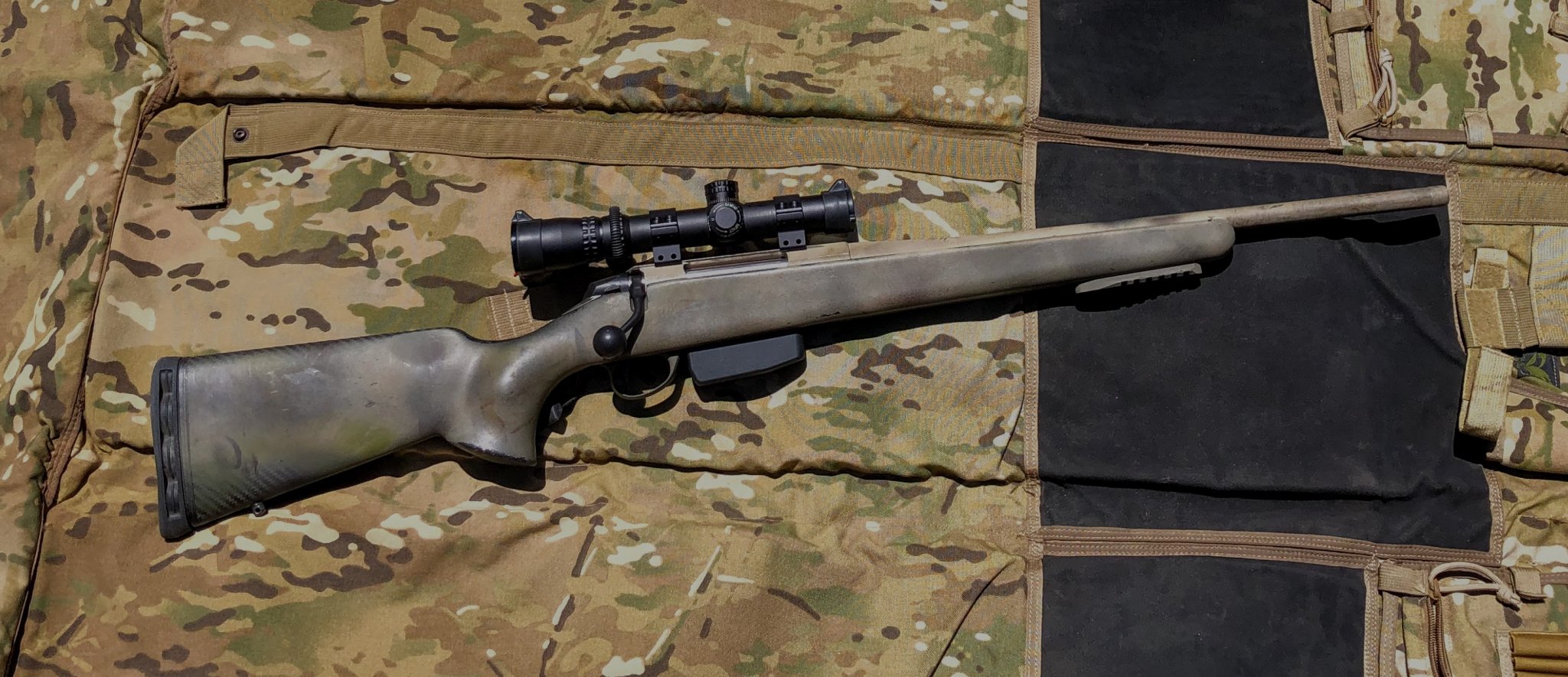

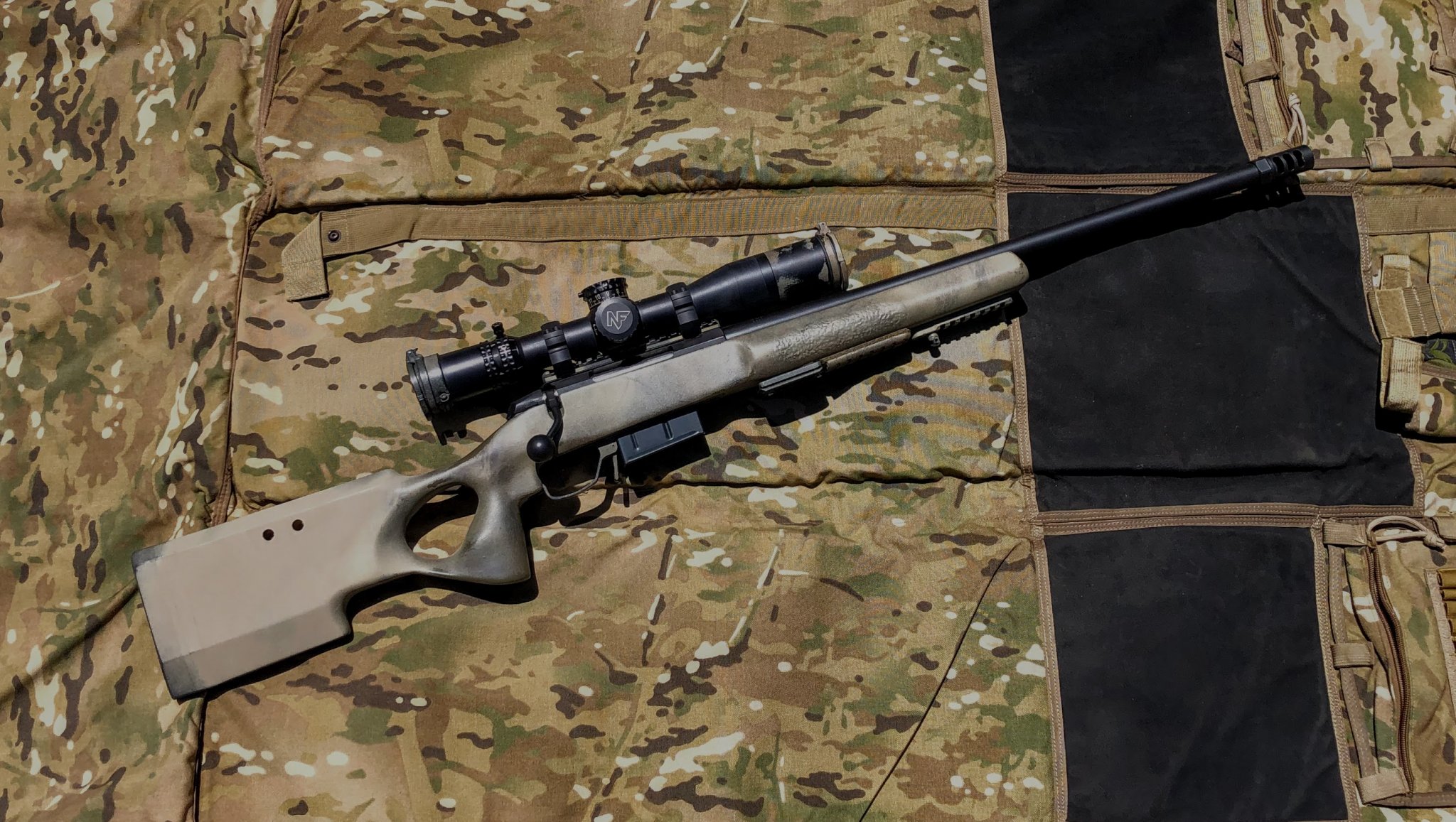

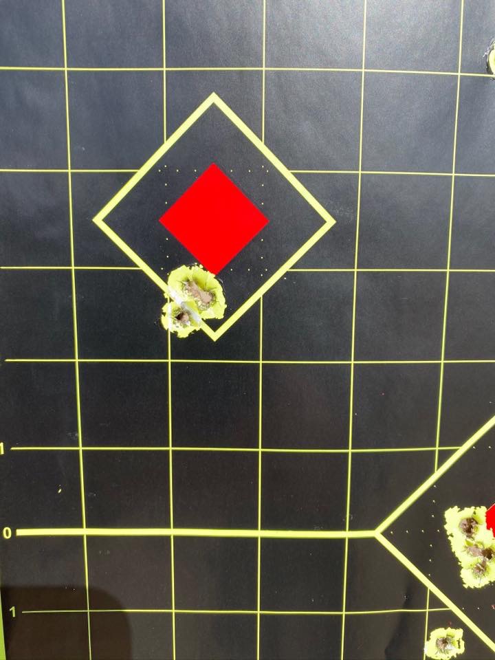

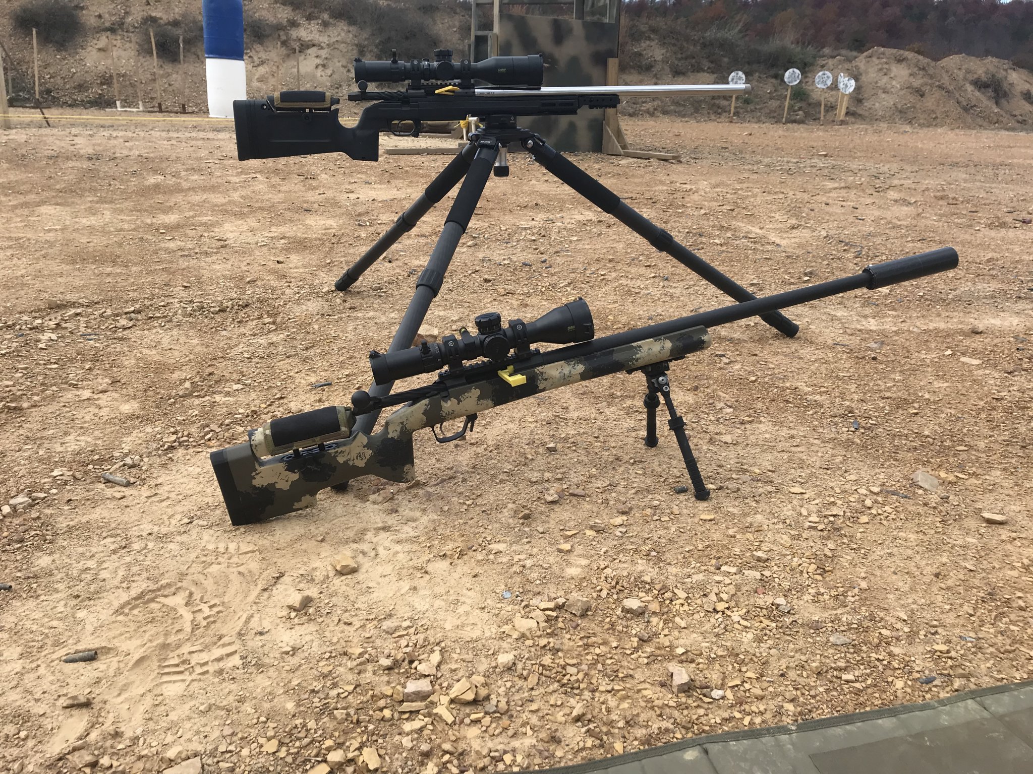

Reuse it, here's my old T3 .270 now wearing a Beanland Proof 6.5CM.

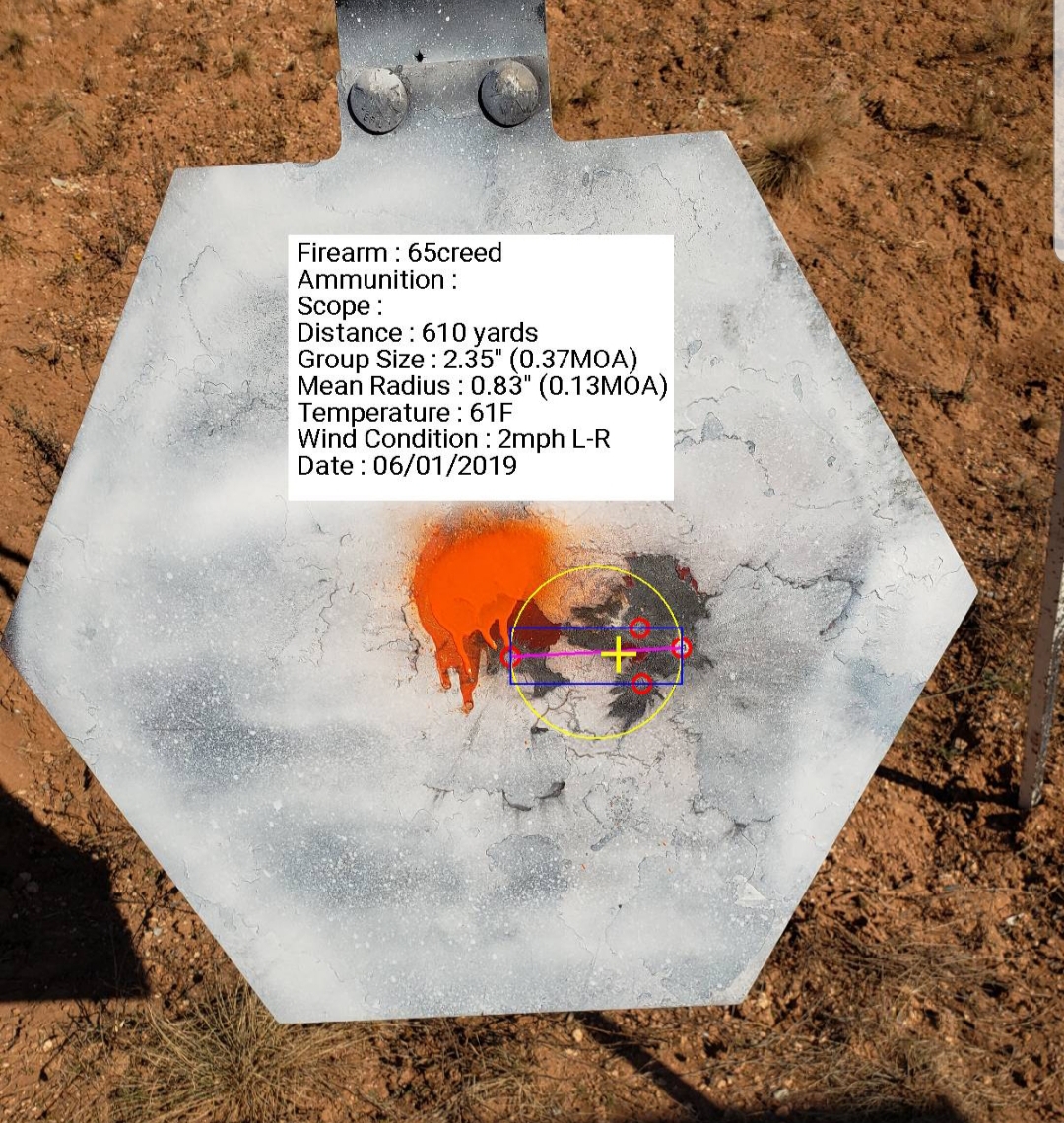

And here's how it does @610yds.

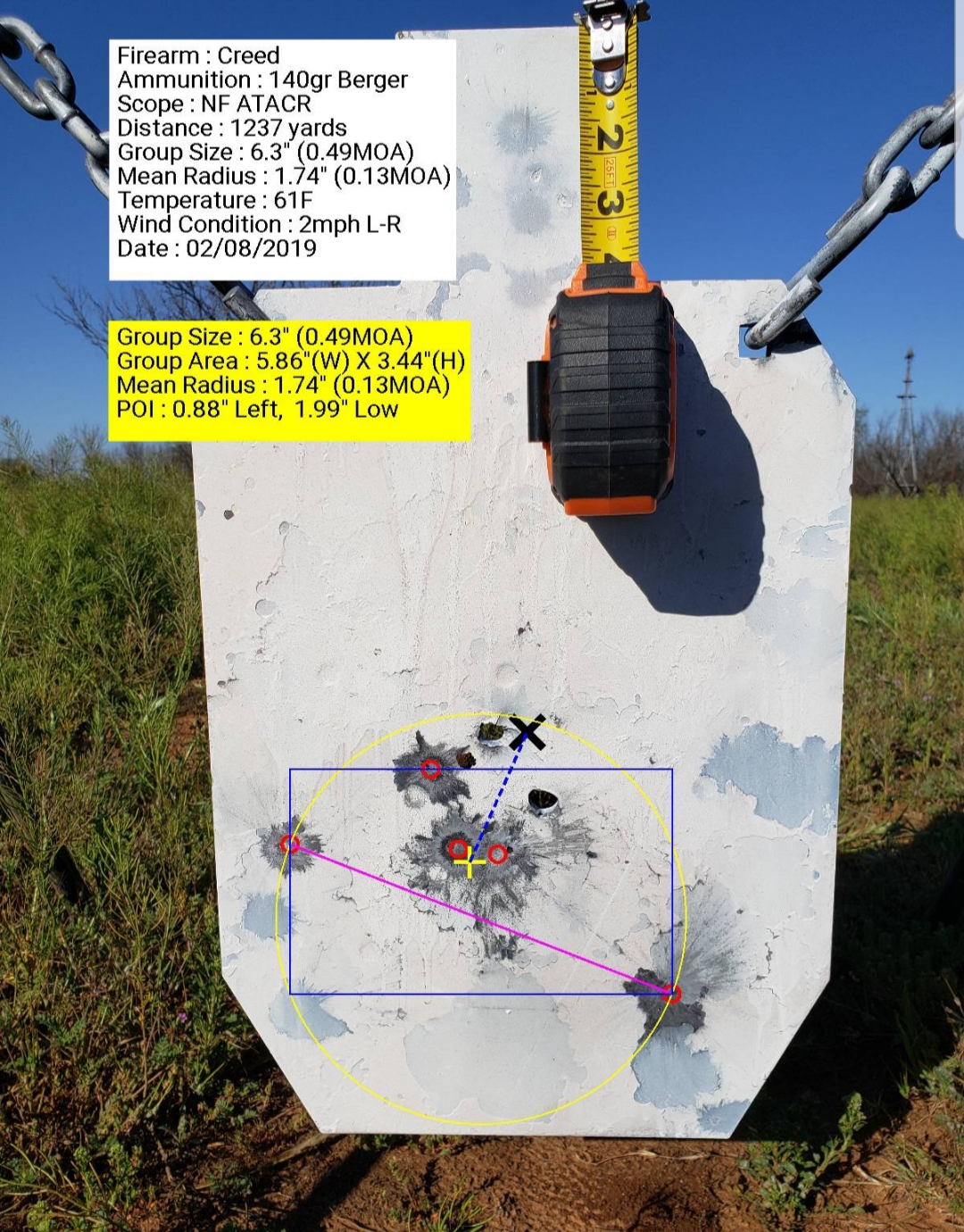

And 1237

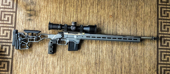

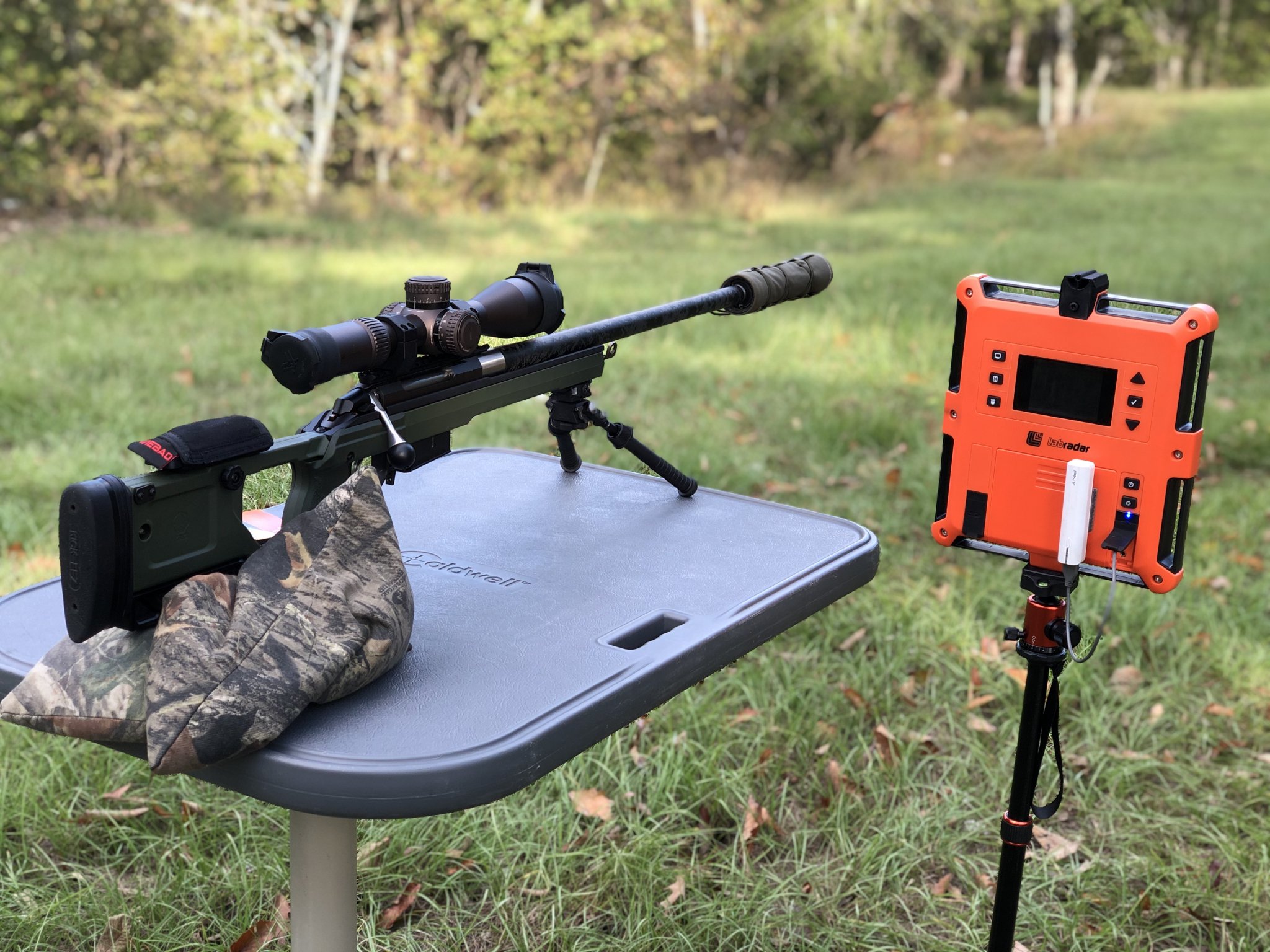

That being said, my brother bought a CTR 24" SS and that thing shoots lights out with Federal premium 130 Berger ammunition. If I didn't have my 6.5 Sherman, I'd be going the CTR route.

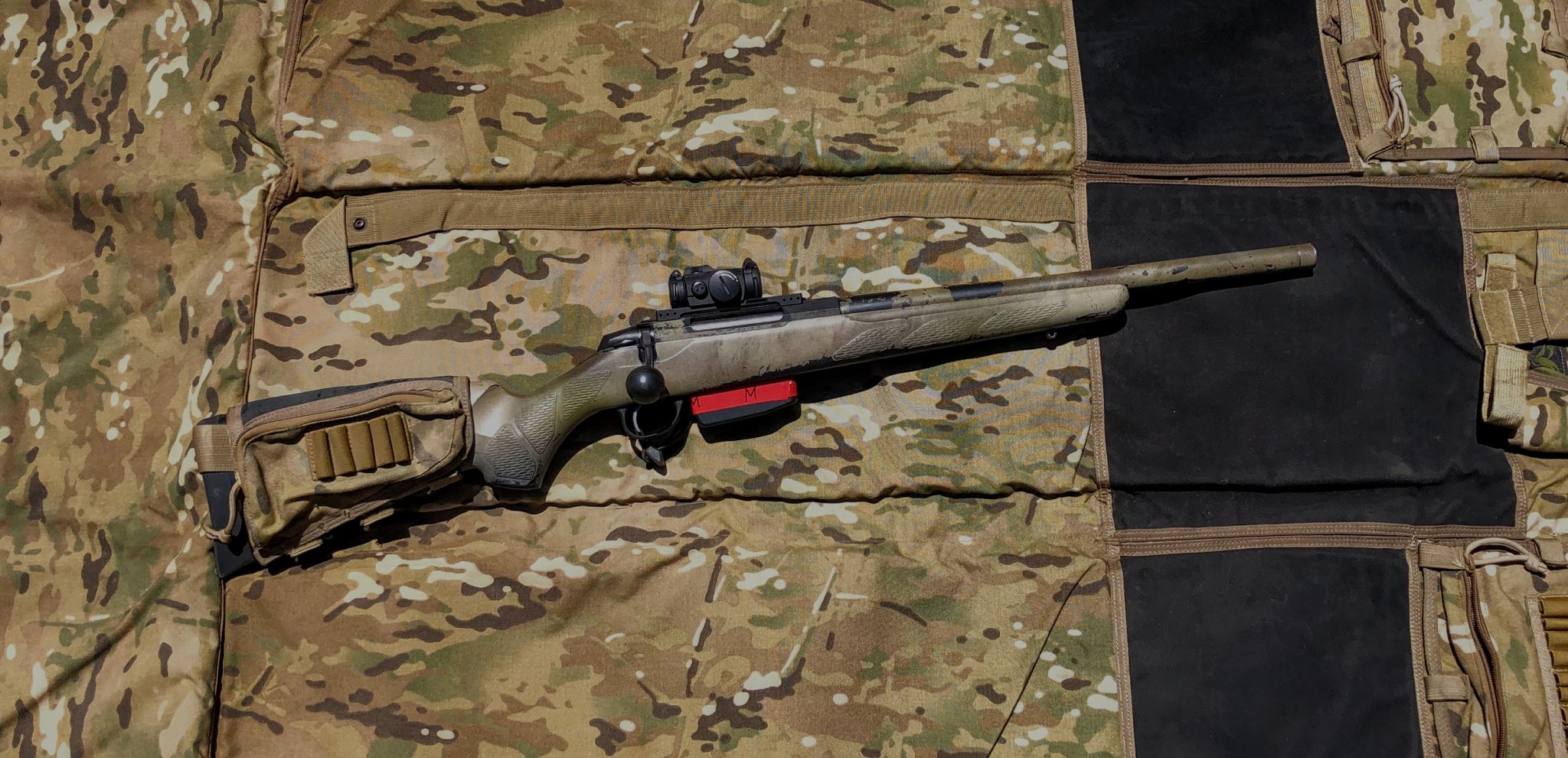

Like the others said, build, pick a chassis or stock to put it in. Hard to beat a bravo for a budget build. You could do a prefit barrel as well and do it yourself. Bugholes does prefits on all their barrel choices.
As above, I would certainly use that action. If the barrel isn't shot out, sell it to get some money back. Add in a stock and barrel of your choice and I'd expect you'd be under what one specs on a CTR and it's setup exactly how you want. I think PVA does Tikka prefits now too, so plenty of options.

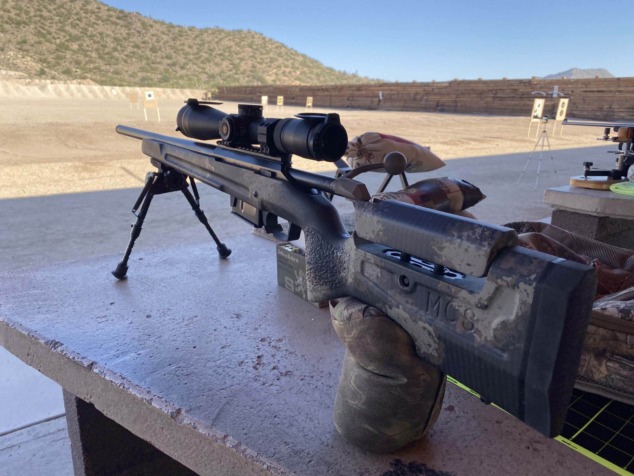

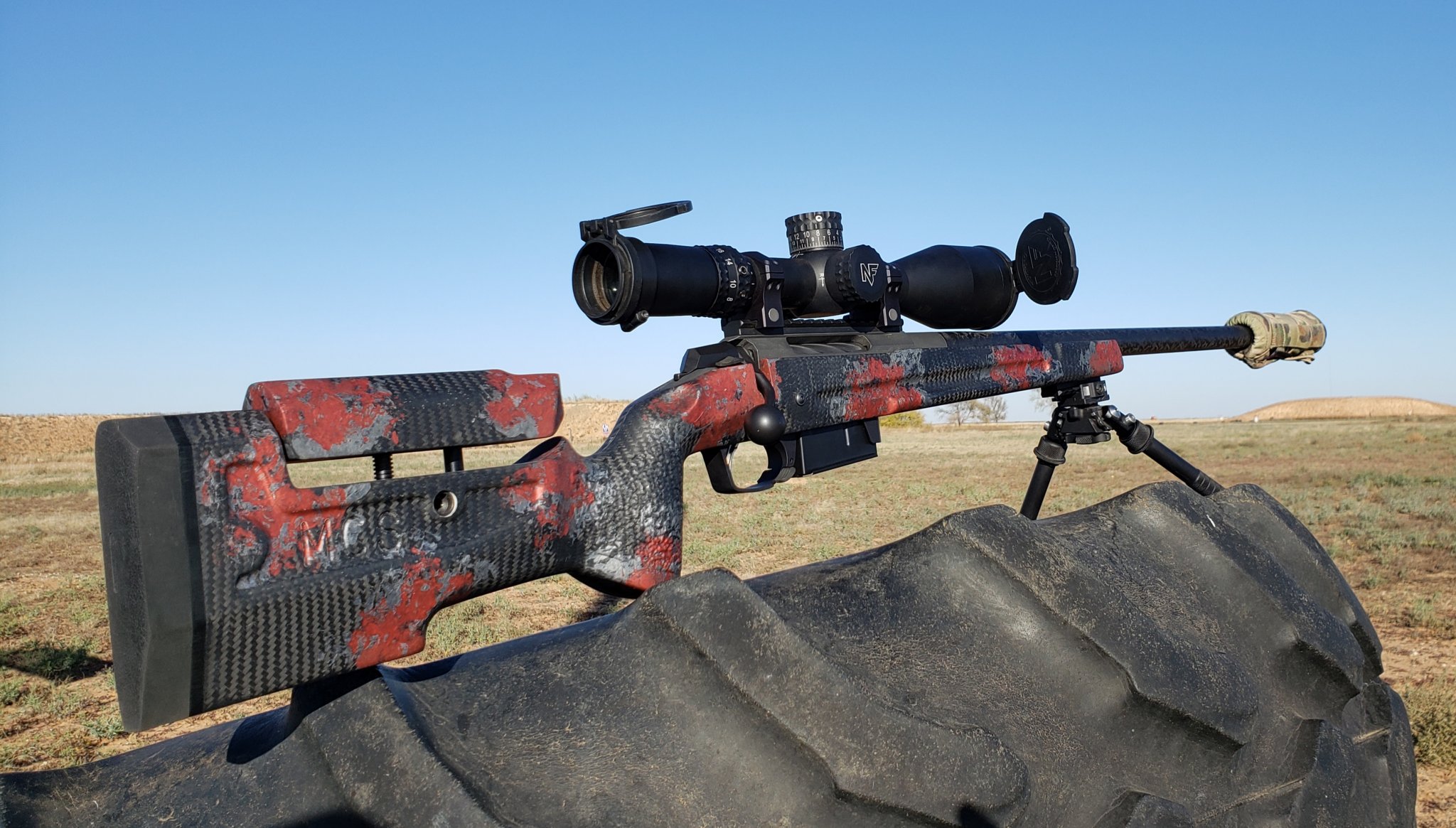

I'll vouch for the PVA prefit on a Tikka. Near Manufacturing makes a rail thats a work of machining art. Mines in a KRG Bravo but you can bolt a TRG stock or forend to the KRG backbone if so desired.

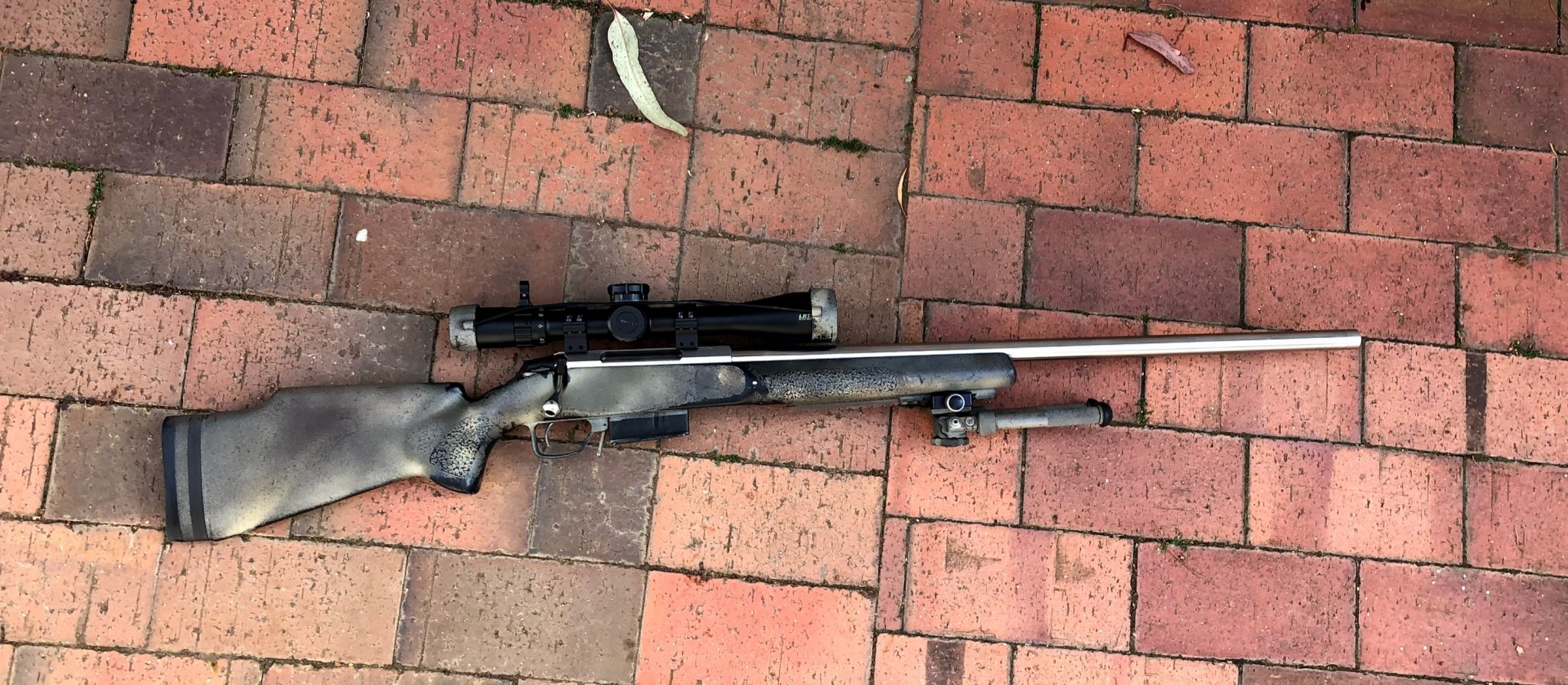

Love that shorty, is it chopped and threaded? Which caliber?
It's a Tikka Varmint barrel in .308. Had it chopped to 17.5' and threaded. I then inletted a Tikka lite stock to accept the varmint barrel profile. It balances very well and is insanely accurate. When I had this rifle scoped it shot a 2 inch 5 shot group at 500m with 155smk's. Despite the short barrel, it will push factory Aussie Outback ammo, which is 165gr, to 2675fps. One of my absolute favourite rifles.
