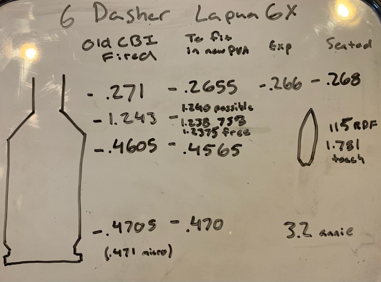

I've pondered this question myself quite a bit...
My conclusion (and I may be way off the mark) is to have a reamer made from your current brass and die if you want to move brass from one barrel to the next. But for that money you could just buy new brass... If you can find any.
So presently, it might make sense to find a way to move serviceable brass to the next barrel.
Your circumstances and chosen caliber will have a big impact on how to move forward.
