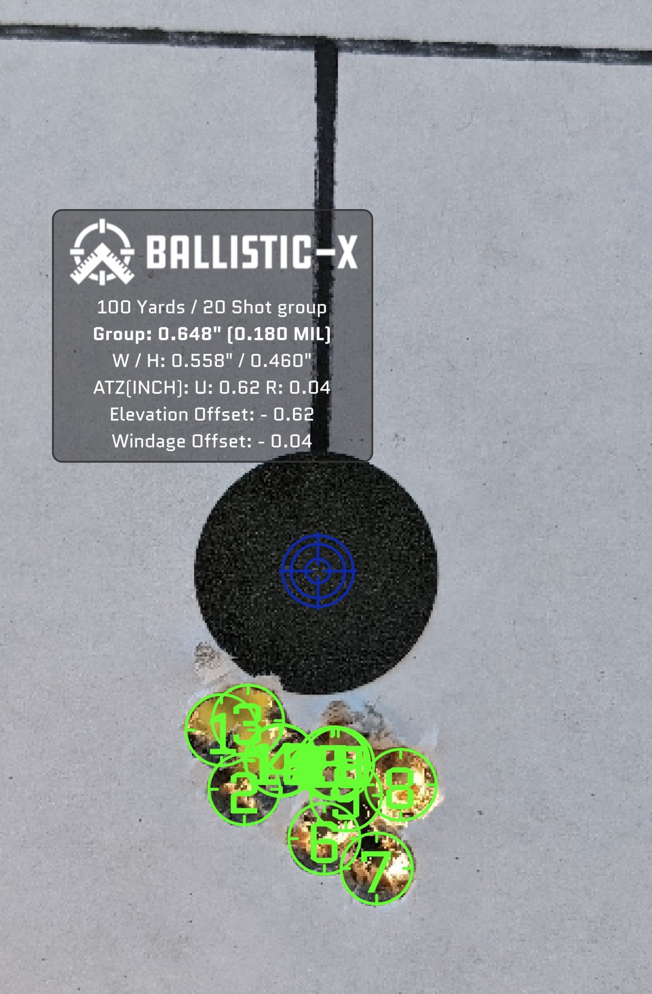

I have the MG7. Certainly not hearing safe for 6.5. My Nomad with ebrake is hearing safe running 144 gr Bergers at 2850.
However, in 308... Yes, it's a lot more tame. I still wear ear pro if doing continuous firing.
As far as grouping... It's good to go with very little POI from my traditional brake (APA Gen3). This is 20 rounds on a 3/4 inch dot in 6GT. I direct thread. This was the first day I used the can just less than 2 weeks ago.
Ballistic-X-Export-2021-02-20 06:22:09.215762.jpg

I'd take that group all day long. I still shoot minute of deer. I noticed that you were saying you direct thread. On this application I was going to direct thread to save weight. Have you done any testing to compare if different mounts and uses affect the POI?

No, there is still a good bit of not-hearing-safe pop on the first couple rounds. It's bearable with lightweight muffs or as a spectator behind the shooter. But still not quiet like a Nomad or TBAC. Maybe in a one-shot hunting situation it would be okay but you know what they say about hearing... it only takes one accident and that sound is gone forever.
I only DT at this time. I do have a Maverick on the way and will soon be switching over to their Hellfire/Sidewinder system but I don't expect much POI changes, if any.
