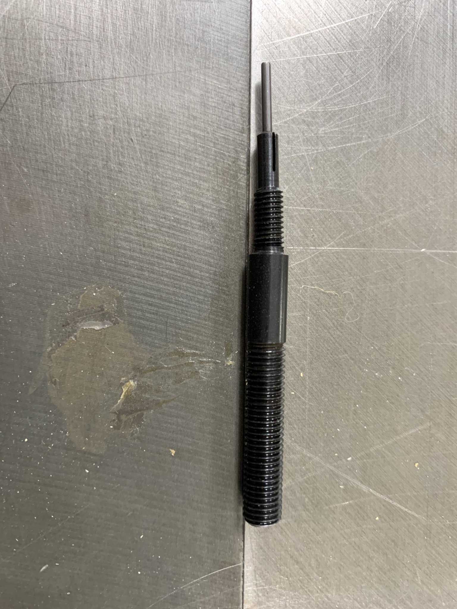

And now for something different. I just went out to check the sizing die and noticed my decap pin was off center. Took the die apart and my spindle is bent. Not sure how well is shows up in the photo but the top of the threaded body just below the middle portion of the spindle is slightly bent. I've bent a lot of spindles for 9mm before I stopped using pins but this is a firtst.
