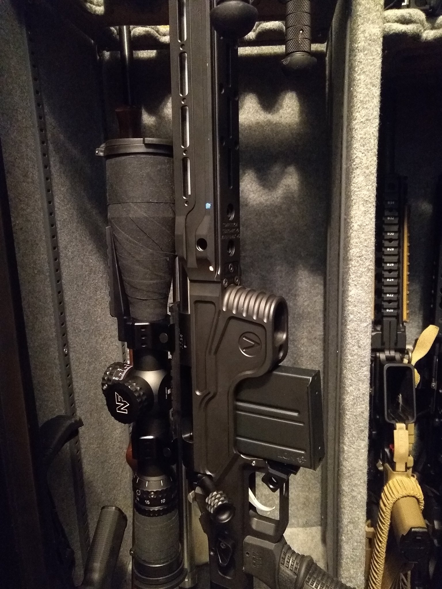

I have a proof comp contour on a tl3 with whiskey 3 folder. It balances 3.5 inches in front of the magwell.
With a surefire 300sps I need a heavy bag rider to get it to balance correctly.
Appreciate the data point. When I added the 2lbs to the front of my rifle, my balance was near identical. With my sdn6 up front i need both rear weights and grip weight in a bravo. 20.5lbs and balance 3.5" from magwell. I think it'll work just fine.
