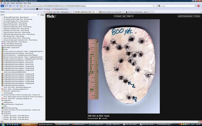

Bart Bobbitt, the guy who shot a 3.25" 20 shot group at 800 yards with a 308 in 1997 in Precision Shooting ad by Krieger, used to say that the bedding breaks down under a round bottom receiver. He used a Win M70 at Camp Perry with a flat bottom. That info can still be found with Google.
