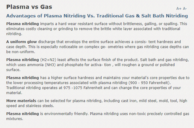

Hi,
Not all "Nitriding" is the same AND the firearms industry in general is beyond stuck in rut of continuing to utilize a nitriding method that is not optimized for our use.
The 3 largest "nitriding" companies used in the firearms industry are still using Gas systems.....
Sincerely,
Theis
