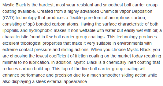

Kind of related; since we're talking coatings, does anyone know what Cryptic Coatings' Mystic Black is?
As someone who has three of their bolts, one a complete spare, it's the only coating I've come across that actually matters. Everything else is inferior in my opinion.
As to what it actually is, they don't specifically say here.
They just talk about coatings in general.
Based on their description it's DLC.
