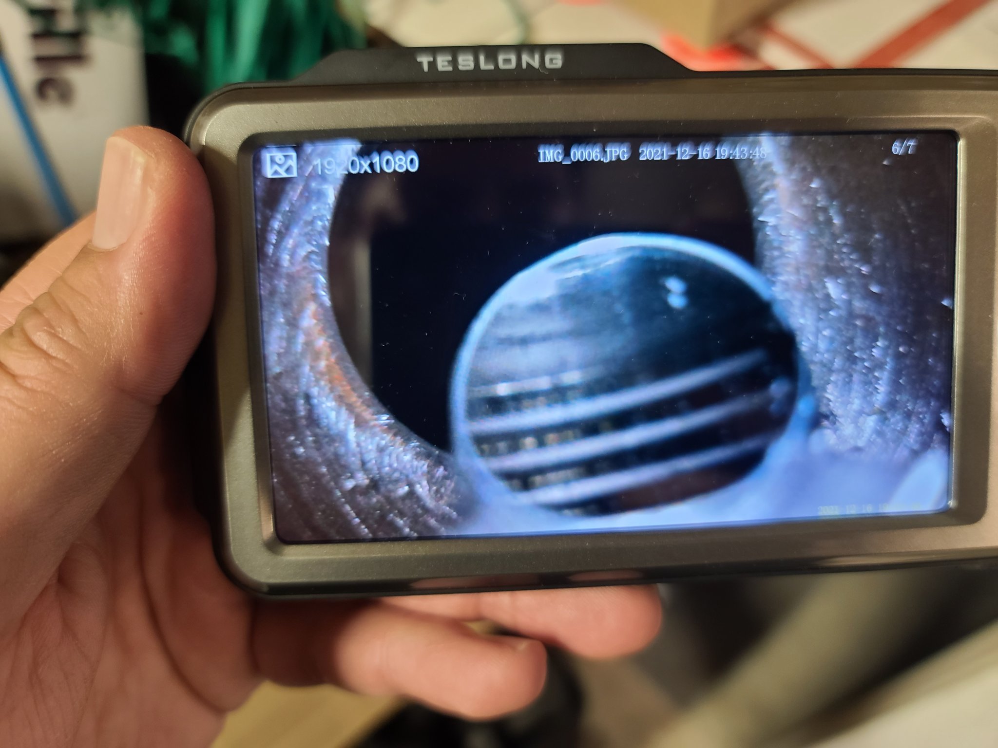

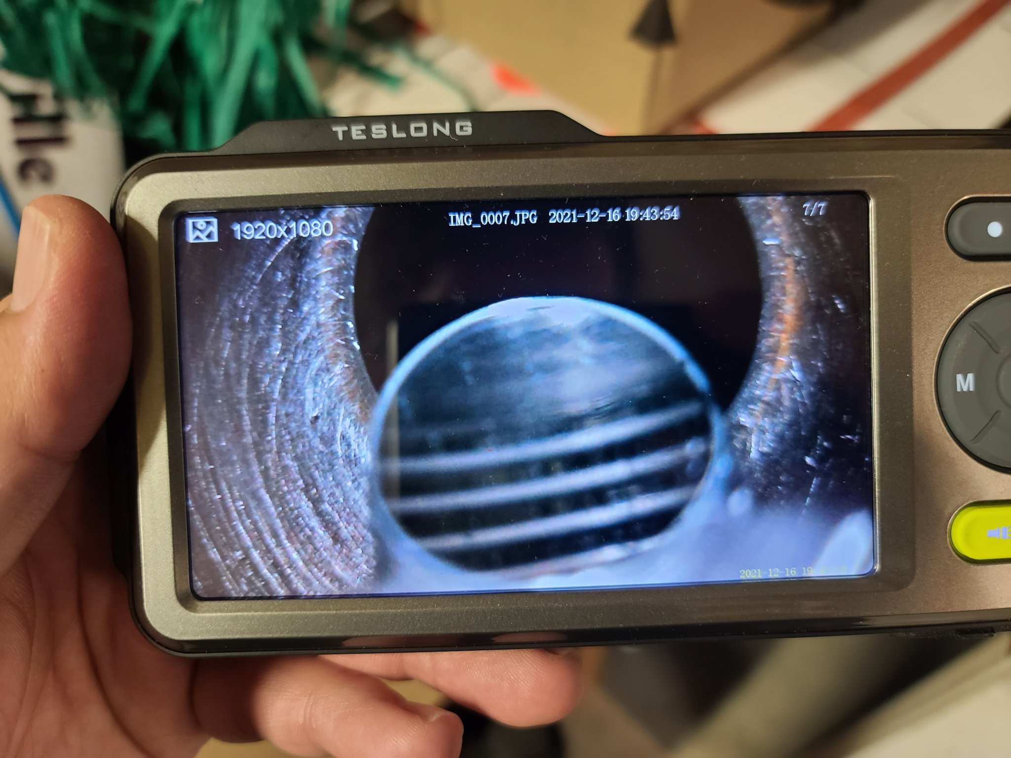

    I personally clean after every range trip and check it with a borescope to verify. I run copper cleaner through it first and then go after the carbon with a bronze brush until it is clean. The main issue I seem to have is carbon building up in the sharp corners of the lands. This area can be hard for me to get clean but I think I need those sharp corners to grab the bullet.

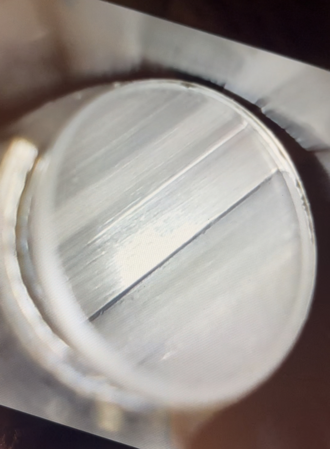

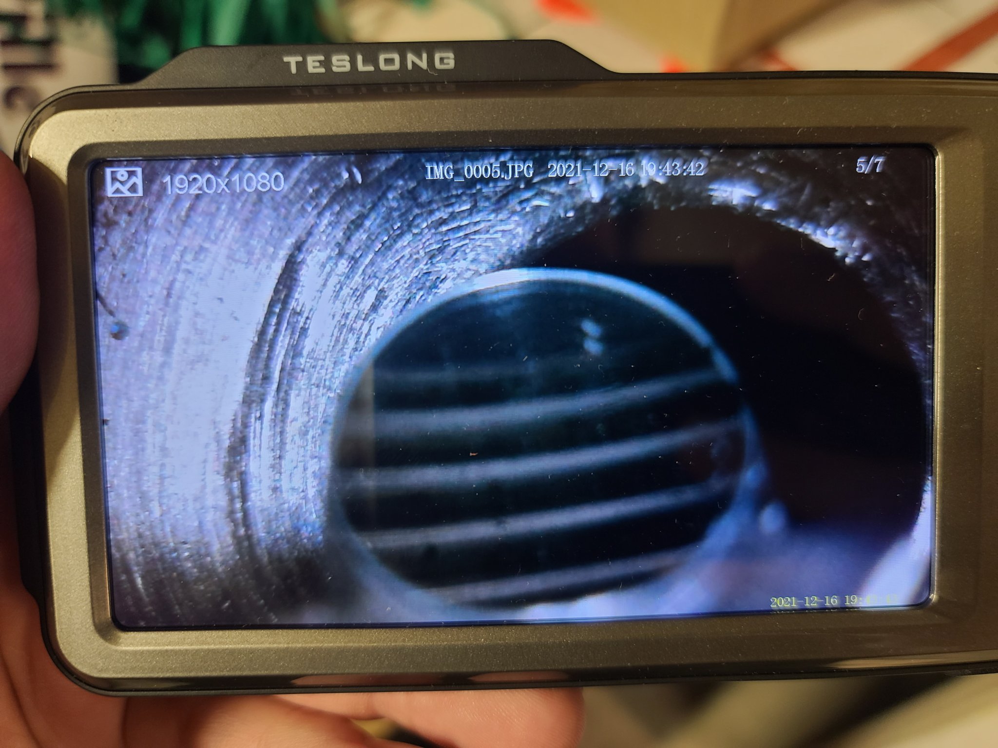

    Hey so this is the barrel face right before the chamber. This is a brux barrel in 223ai with only 400 rounds on it.. I'm not sure what is causing this. I realize bore scopes are microscopes so this is all blown up alot. I always use a bore guide but i do usually clean the chamber with a patch and jag but this seems like its caused from something else.. the inside of the chamber and throat look great. At the range the otber day i did notice some sticking more then usual when trying to extract and cycle the next round.

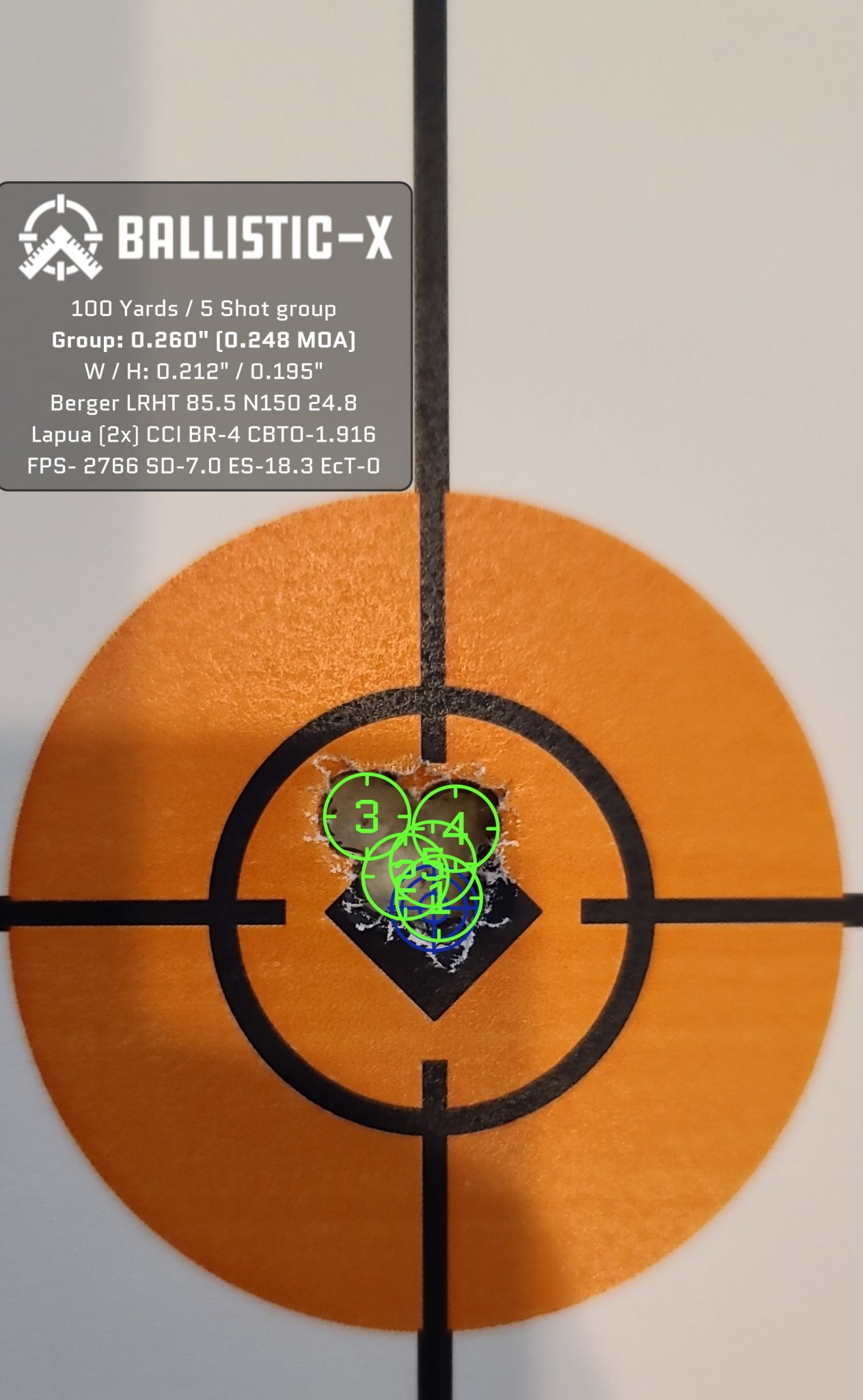

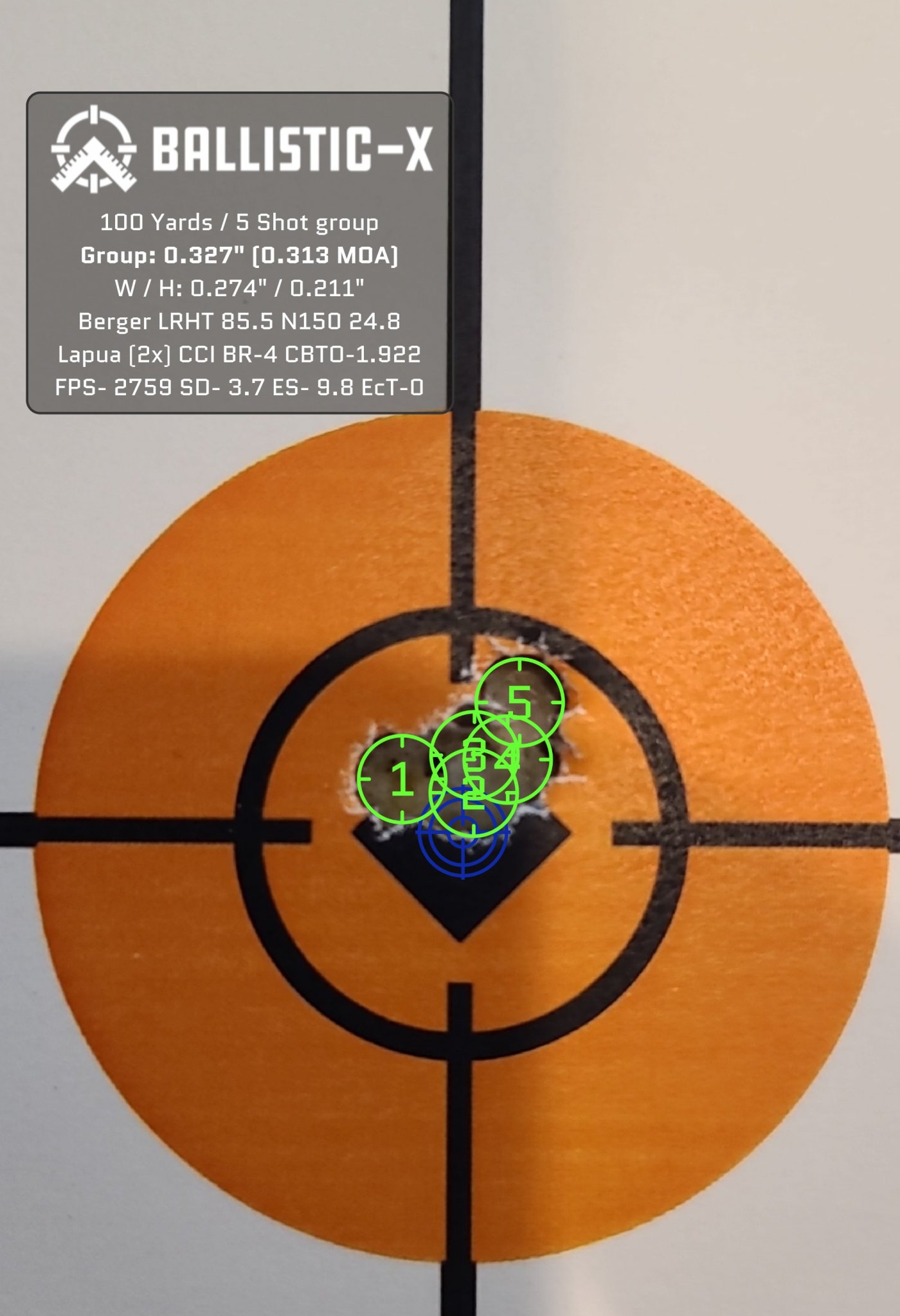

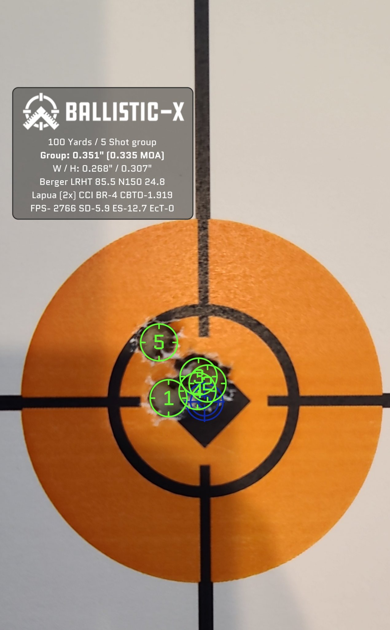

    After every match (or about 100 rounds in a .308 or .30-06) while using a bore guide, wet patch chamber to muzzle then remove patch. Pull bare rod through barrel then bronze brush chamber to muzzle and after it clears muzzle pull back to chamber. Do that x 5 then clean patch x 2 and leave dry.
    It is what Barret Obermeyer suggested I do to clean the barrels he sold me and I have 3 of them. It is also what John Krieger suggested to clean his barrels and I have 2 of his.
    That cleaning schedule served me well as a 'Boots' SS, 5r barrel on a 40-XC action chambered in .308 shot a 200 10X 'clean' at a 600 yds. Match and the barrel had 4,302 rounds through it at the start of the 600 yd. slow fire stage.
    The load was 46 grs. IMR4831 (slight crunch) in a LC 79 Match case trimmed to 2.0" behind a Sierra 200 gr. HPBT Match King seated to 2.850" and set off by a Federal 210 Match primer. A chronograph said the low was 2,301 fps and the high was 2,308 for an extreme spread of 7 fps and average of 2,303 and standard deviation of 4.
