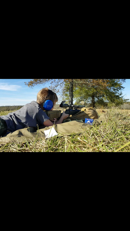

My son at 6 started with the Cricett .22 rifle. I started a similar thread to this here earlier this year because he's 11 now. He outgrew the Cricket and needed a bigger rifle. I ended up getting him a Ruger American Ranch. I then put it in and MDT LSS chassis I just got off the Hide. Minus the scope, bipod and can, I have ~$600 in it.
