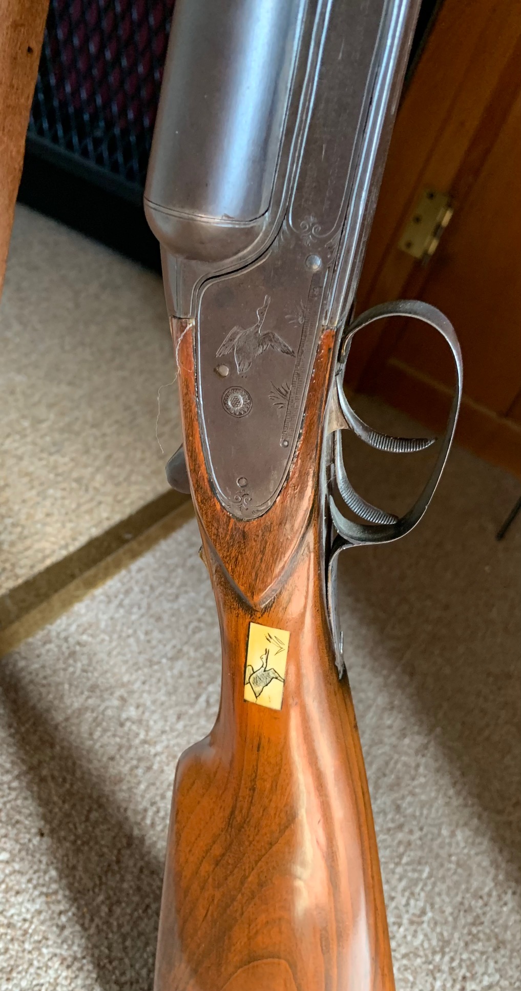

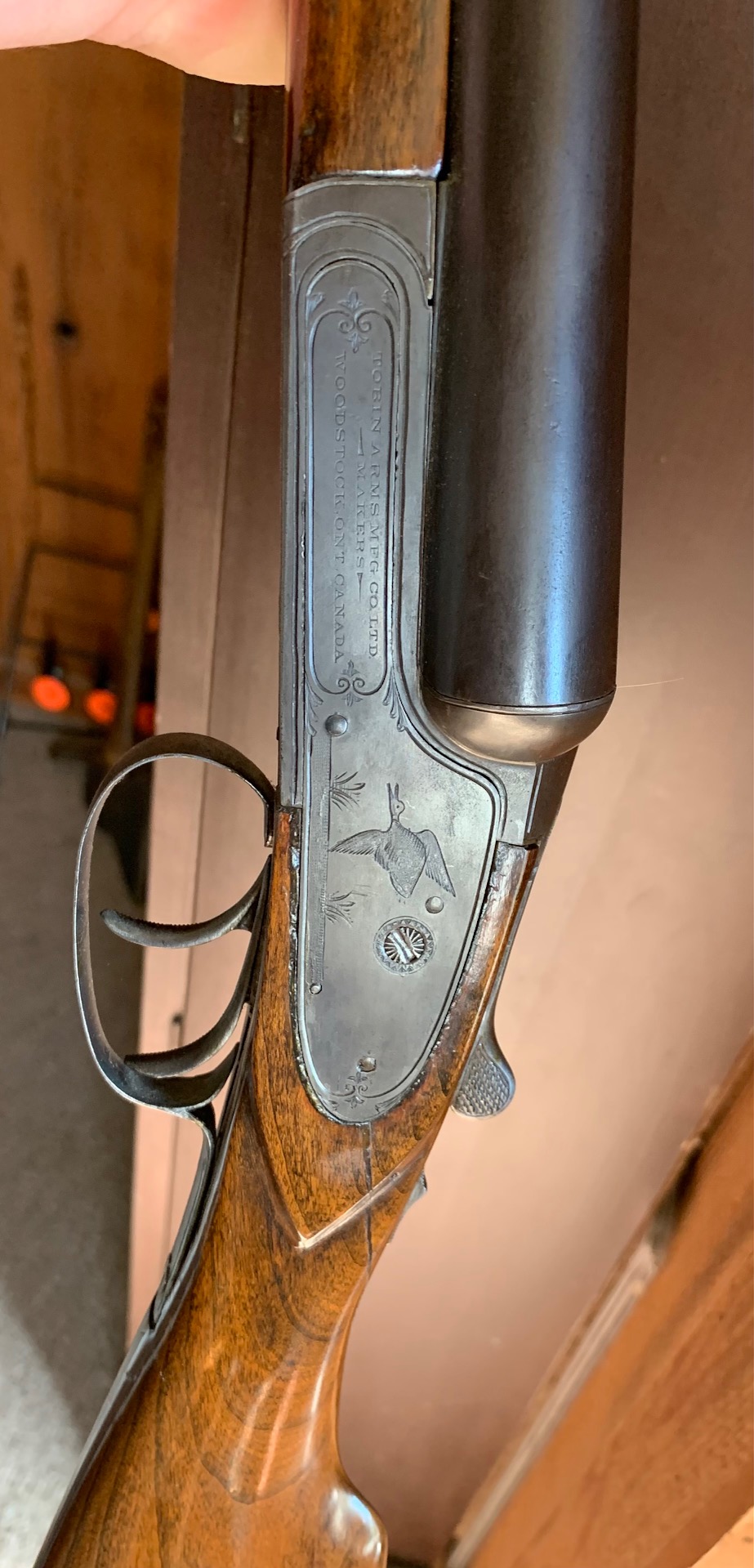

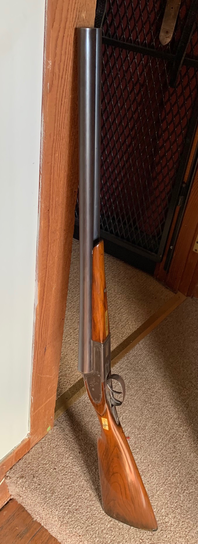

Ok... so here's what poors get up to...
My first shotgun. Bought with my own money. A whopping $7! From a guy who worked on the farm named Tom. It had a broken-to-fragments stock. Barrels were/are about 22 inches. No choke of course. It's actually a pretty high-grade sidelock by a company called Tobin Arms. They were a legit L.C. Smith competitor. Moved to Ontario in the '20's but started in Connecticut.
Oh and one firing pin was broken.
It became one of my first 'restorations.' I know I had to be at least 15 because I drove several places to get 'help' fixing it. And had a farm license here at 15. So would have been summer '80 or so.
The stock is a piece of Walnut I got at a local mill. It's not really good 'stock' walnut. But it was cheap. Maybe even free. I think the Lemire's took pity on me when I showed them the project. Anyway, it was walnut. And relatively straight. With the help of a local gunsmith named Herb Parkhurst, we carved and inletted the stock. He did the inletting. I did rough shaping and then the final sanding and oil finishing. Later it cracked again and shrank, so I did my first epoxy bedding job. And it hasn't cracked since.
The firing pin was made in school metal shop. I still remember the shop teacher, Brent Hoskings. (Hoskins?). Big blonde afro and missing a finger. Really. He gave my my first lathe lesson and we turned the firing pin from a piece of mild steel then heated it and quenched it in oil. It broke. So we made another one and heated it and put it in Kasenit. It's still working to this day.
Later, I got into scrimshaw and made the duck inlay out of beef bone and inlet it in the stock. I was styling!!! I had a sidelock double with an ivory (!?!) inlet scrimshaw duck on it!
No chokes. It simply blasted out lead. But was and is (I have not shot it in 25 years!) deadly on birds. Just a massive spray of lead downrange. I killed a lot of grouse with this gun!
