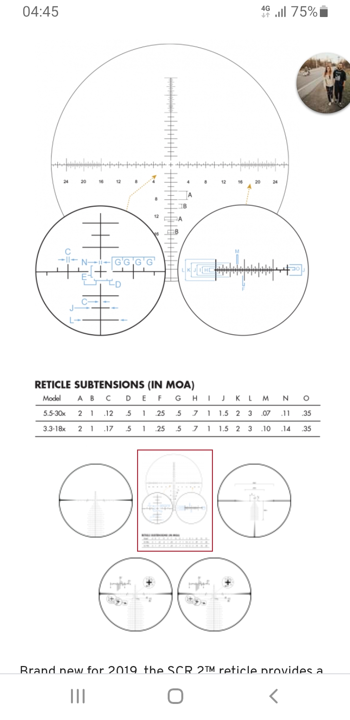

I'm looking for the following scope:
  • Semi-auto (AR-15), 223 Remington
  • Primarily steel to 1000 yards, limited varmint hunting
  • Primarily daylight, very limited lowlight
  • Required: FFP, mil-mil, illuminated, zero stop, .2 mil hash windage and elevation hash marks (I understand that really reduces the pool of options)
  • Preferred: Christmas tree
  • Preferred: 50mm objective or less
  • $2000 MSRP or less
  • No China
I have a Nightforce NX8 4-32 F1 Mil-xt and like it but, one, that's on a different rifle, two, I don't want to move it, and three, I want to try something different. I am aware of:
  1. Athlon Cronus BTR GEN2 4.5-29×56 APRS6 FFP IR MIL UHD (#210115, https://athlonoptics.com/product/cronus-btr-gen2-4-5-29x56-aprs6-ffp-mil/)
    1. Misses the objective size preference
  2. Tract Toric 4.5-30X56 34MM MRAD ELR (#30, https://tractoptics.com/all-product...m-ffp-mrad-elr-extreme-long-range-rifle-scope)
  3. Meopta Optika6 3-18x50 FFP
    1. Only partial illumination
    2. Country of Origin???
    3. Lesser quality glass than the others listed?
  4. Burris XTR III 3.3-18x50mm (#201202, https://www.burrisoptics.com/scopes/xtr-iii/xtr-iii-3.3-18x50mm)
    1. Over budget
    2. Not illuminated
    3. I could deal with the price if it were illuminated and it'd be my pick
  5. Leupold Mark 5HD 3.6-18x44 M5C3 FFP PR1-MIL (#180726, https://www.leupold.com/mark-5hd-3-6-18x44-m5c3-ffp-pr1-mil)
    1. No Christmas tree
    2. Not illuminated
I guess my point with the above list is that I could go on and on with scopes that miss the mark in one way or another. There seems to be nothing exactly matching. Thus, I'm left with #1 and 2 as the closest given that I'm willing to budge on objective size. Both meet all other required features and preferred features. Is there another brand I'm missing? I'd rather not shop used.

Do you know what the line thickness will actually be? The Burris website is a bit of a mess regarding reticle images, the only place its specifically mentions the SCR line thickness for the XTR3 is with the MOA version which indicates the 3.3-18 will be thicker than the 5.5-30.
Line thickness is the same between MOA and Mil reticles.
In the SCR, the line thickness was optimized based on the magnification. The same goes for the SCR2.
The line thickness of the SCR is .13 moa at 20x and 25x, and .18 moa at 15x. They are using XTRII magnification numbers here.
The line thickness of the comp SCR2 is .11 moa at 30x and .14 moa at 18x.
