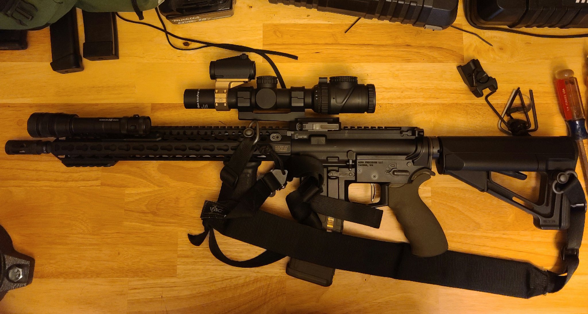

i have an lpvo on a high mount for a more upright - two eyes open type of setup, but i can't say if that would work for you, or resolve the issue entirely.
Reactions: ICEMAN550
