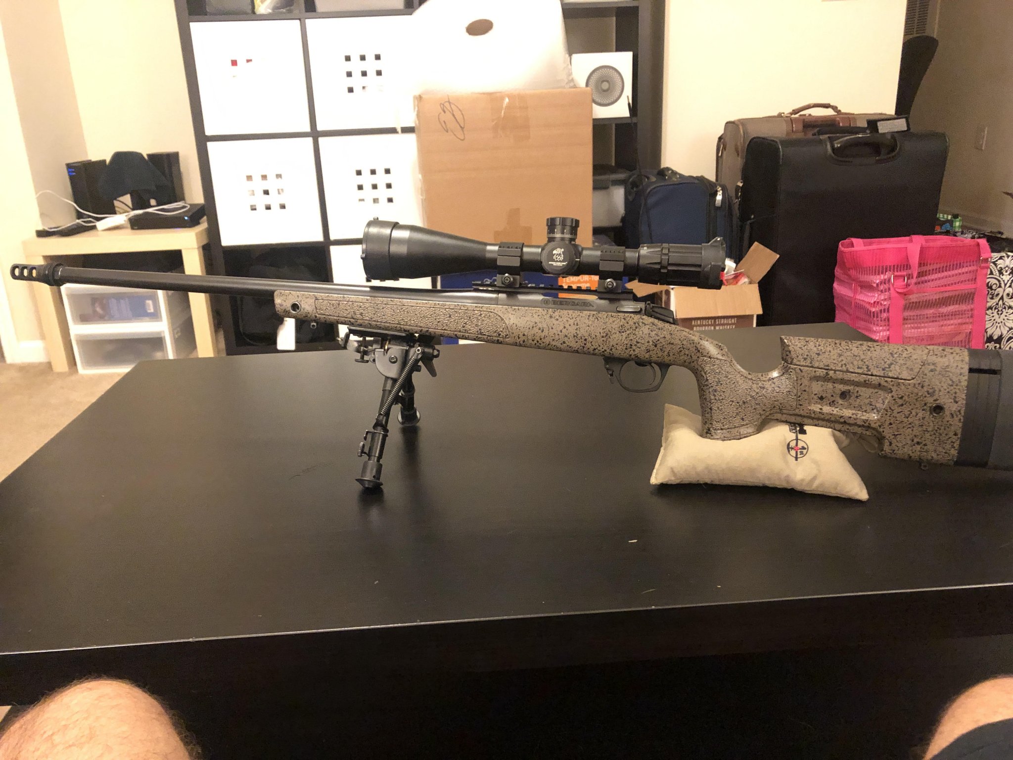

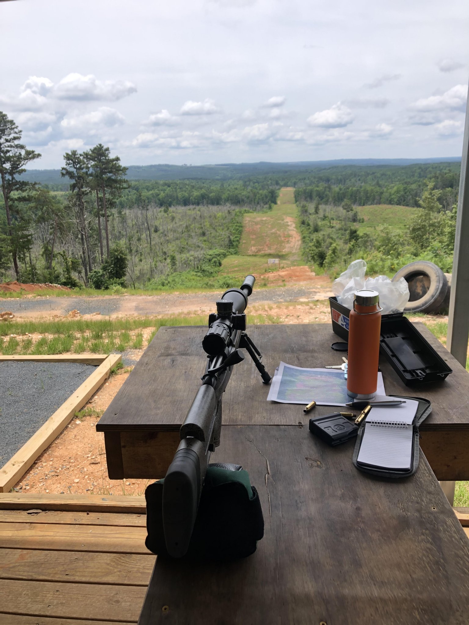

Greetings Folks, first post here so thank you for your help and bear with me please!
I have a B14 HMR 6.5 topped with a SWFA SS HD 5-20x50/Silencerco Omega and am now starting to get into long range shooting as I finally found a range where I can shoot out to and past 1000. I shot the rifle last weekend at the new range (my first time ever shooting past 600) and was able to bang steel at 1000 with the help of my ballistic app and some hail marry wind guessing. All in all I really enjoyed getting the rifle out to 1000 and started doing some research on ballistics, rifle set up, etc as I work to develop my skills. The rifle shoots hornady 140 gr american BTHP American gunner sub moa all day. When I purchased the rifle it came with a case of this ammo and have not even tried anything else as this ammo is on the less expensive side of the Hornady line and has always shot sub moa.
Perhaps the experts here can help me out with some setup and cleaning questions that I have:
1. Now that I understand that rifle cant can affect shots at long range, I ordered a bubble level from SWFA. Can anyone recommend a video or advice on how to properly install said bubble level? I am guessing that it is not as easy as just screwing it on the rifle....I have not found anything too useful on youtube so far with regard to this.....
2. After firing over 200 rounds last weekend I sat down to clean the rifle and used a newly purchased .264cal/6.5mm hoppes boresnake. I have used boresnakes on my other guns for years and hence purchased one to use just for this rifle. To my shock and surprise the bore snake was way too tight for the rifle and got fairly stuck in the chamber as I attempted to start it through the gun. Ultimately I pulled it out and used my AR 22 cal boresnake in the interim. That said, I am super confused and would appreciate your advice or thoughts. Never had a snake not fit a gun before.
Pics of the rifle attached!
Greatly appreciate your help and look forward to learning from you guys!
