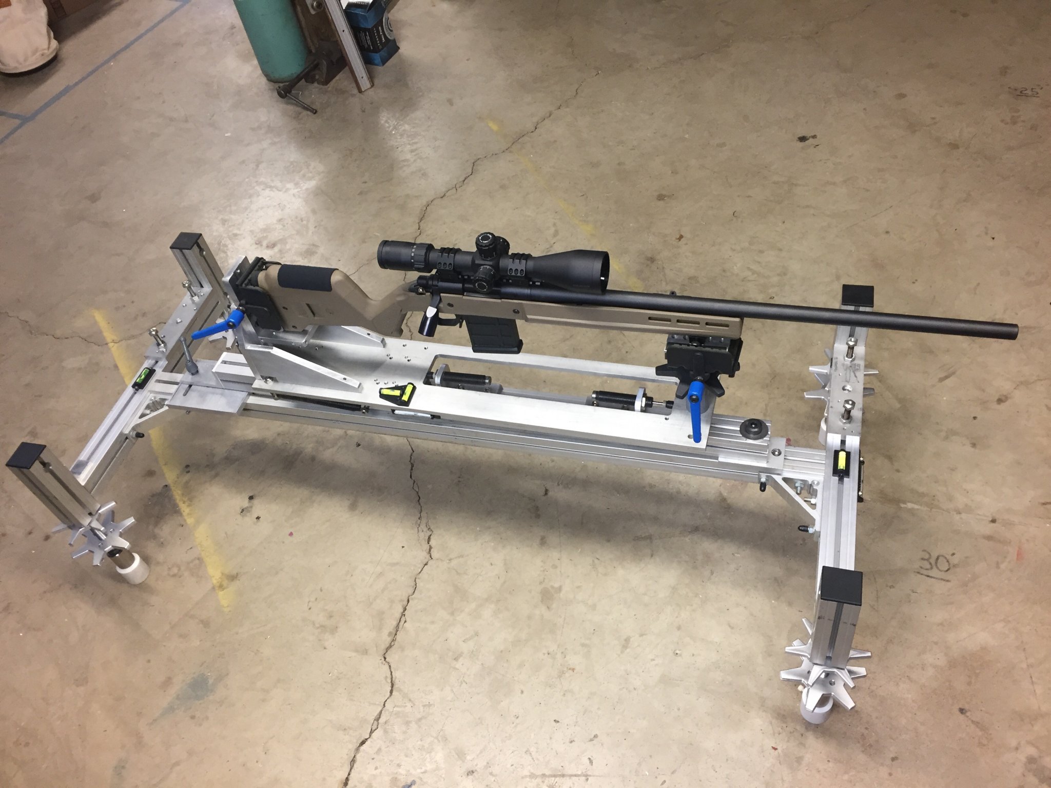

This is my precision lead sled. The Enidine shock absorber capacity handles up to 50BMG. It’s one of a kind and weighs #65 without the gun. THK 25 Series bearings, Hog Saddle Pig Clamps and 7 adjustments [(4) legs, butt clamp, fore end clamp, and angle side to side)].
