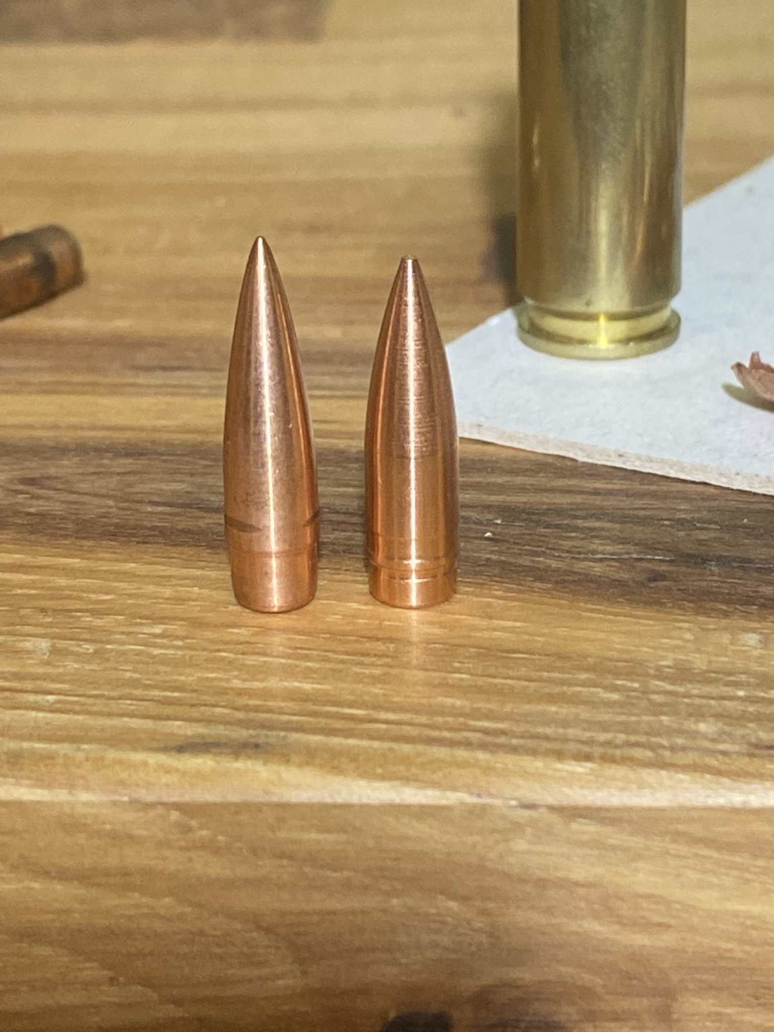

Finally, I’ll just drop this comparison here, Badlands vs CE

Finally, I’ll just drop this comparison here, Badlands vs CEView attachment 7707622
