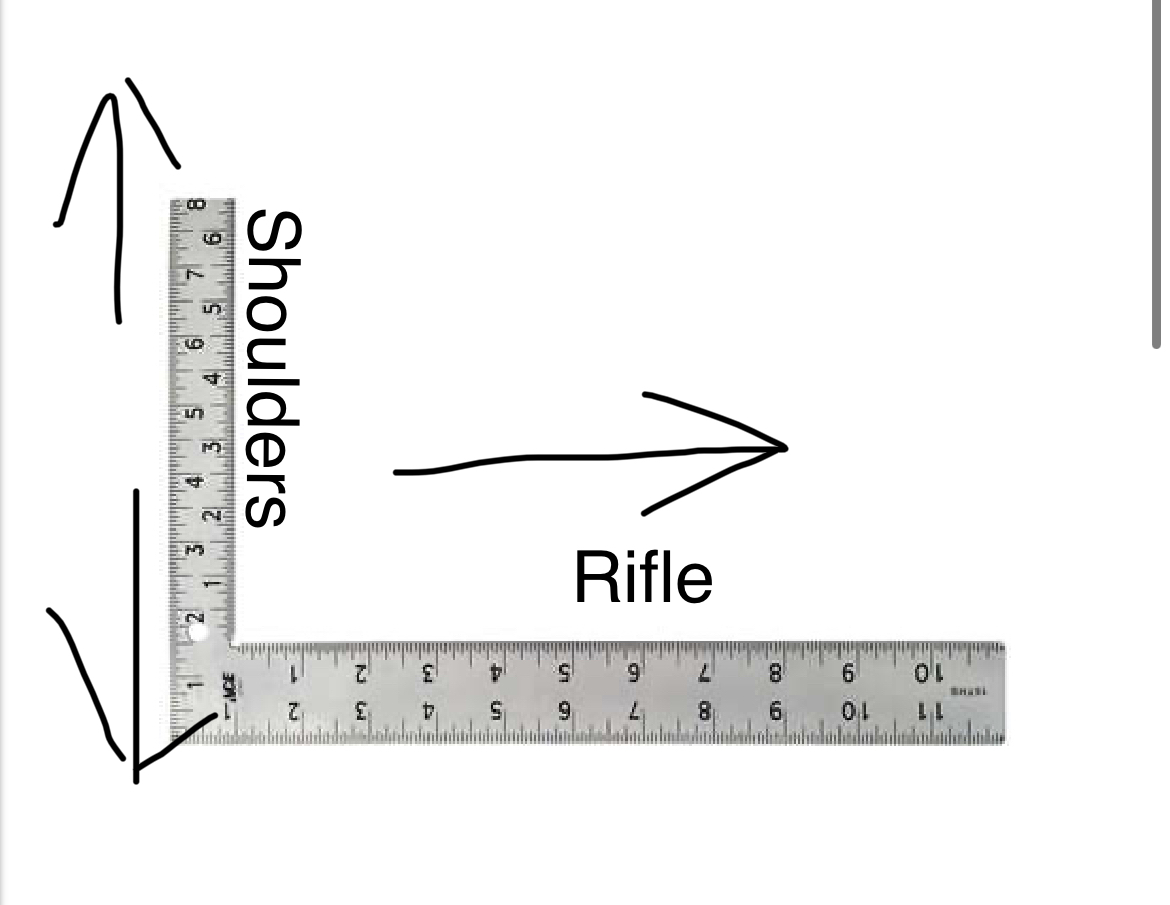

1# Try getting straight as possible behind the gun.
This means that your shoulders and elbows are 90 degrees to the rifle.
Like a square.

Already did the squared up thing
Maybe I wasn’t truly square, I guess that would mean Move my core to the left.
