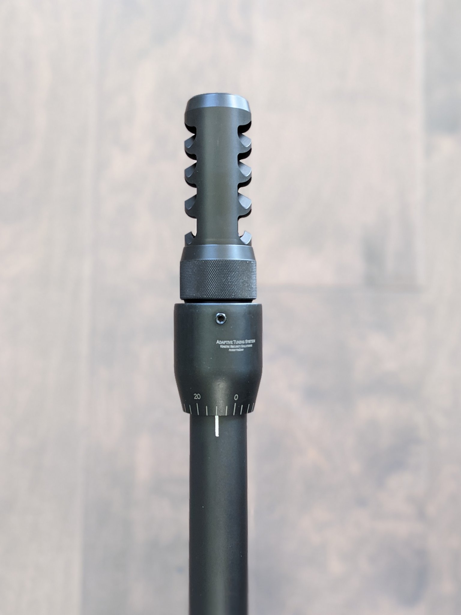

Are these things a...well thing?
Anyone use one? Opinions?
ATS_3_Sizes__44356.1597168059.1280.1280__34908.1597176765.1280.1280__91439.1613499396.jpg

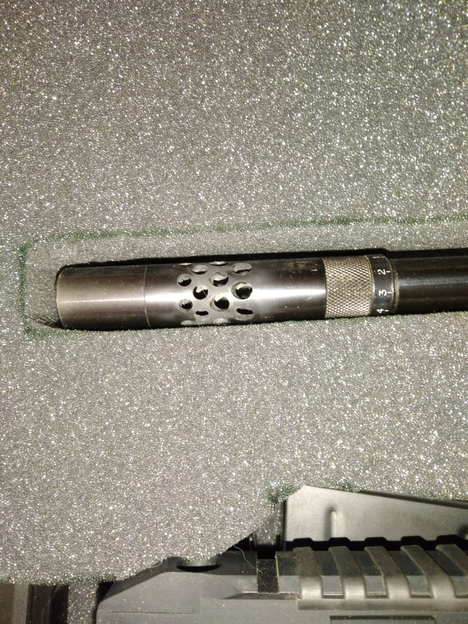

I have a 1975 model 70 270 sporter classic with the browning boss adjustable brake. Its a big help for dialing in factory ammo. Eric cortina is making a nice one now too. He has some decent vids on youtube showing how it works.
Reactions: Geno C.

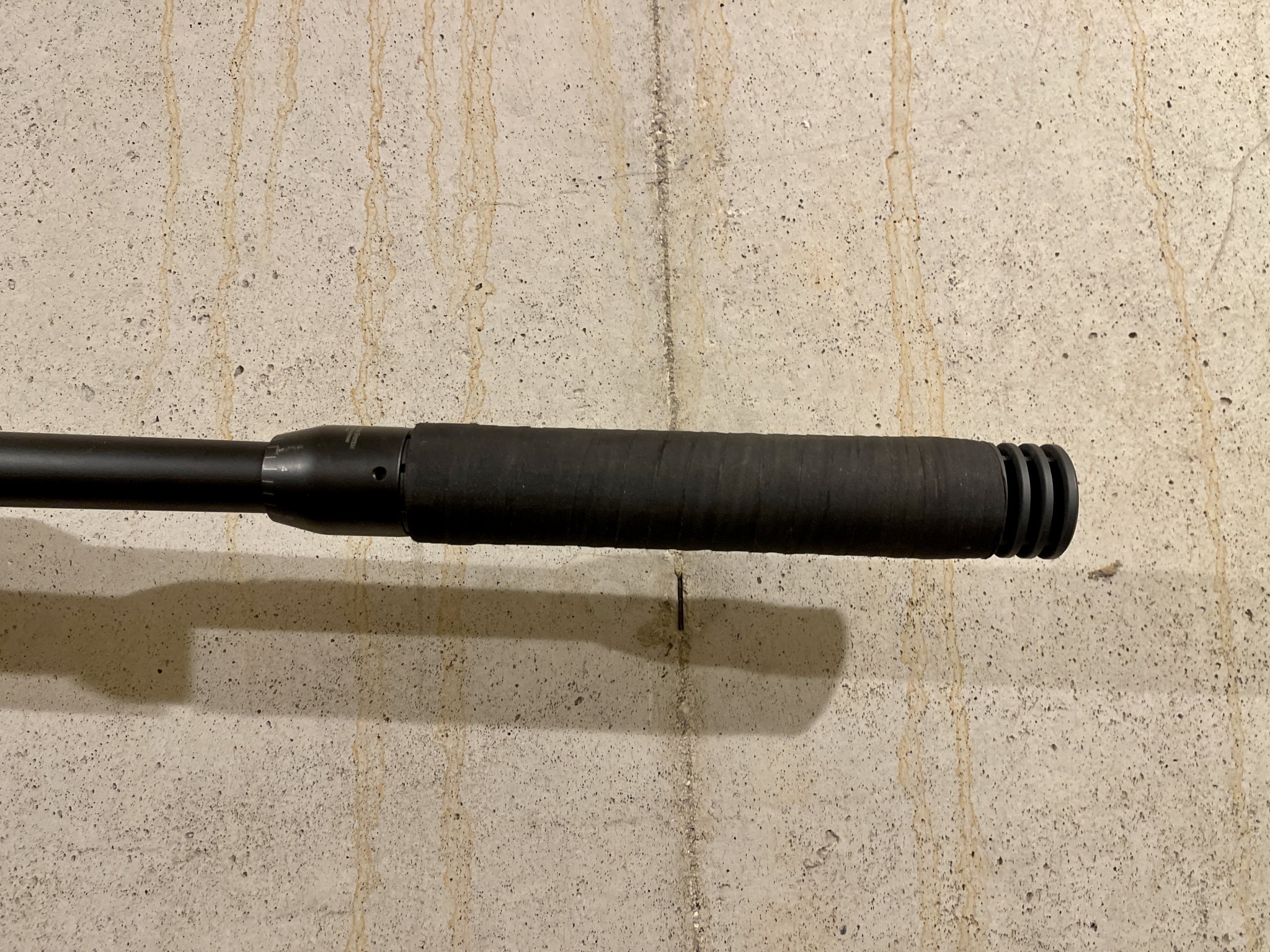

This is the without warning tmb a tuner and muzzle brake in one device. More info on the website.
www.strikewithoutwarning.com
Reactions: BU37377 and Cjwise5

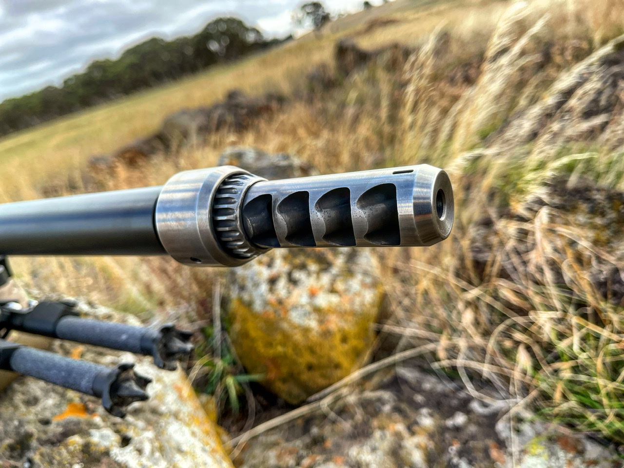

I did have some weird issues at a range a few years back which I'm returning to this year, so I'll certainly be testing that theory out again to get some data.
I have a theory a tuner only effectively work on one "issue". Seating depth tolerance or powder charge tolerance. I'm yet to gather enough data to confirm or debunk it, however I'm my short findings so far, it seems reasonable (but not provable). If you have a bad velo node, and a bad seating depth node, you will not get to the true potential of the same load with tweaked seating depth, or tweaked powder charge. It does help however.
