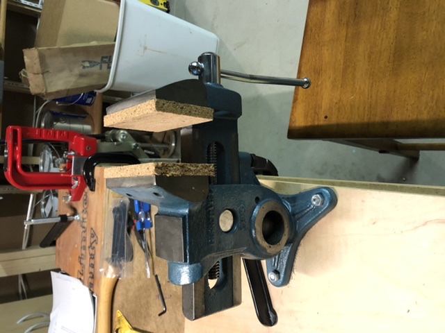

I know this thread is a bit old but I stumbled on a pretty good solution. After fighting skidding, tipping gun vises I bought a Shop Fox Parrot vise for about $50 and bolted it to a square piece of plywood that I just camp to the edge of my work bench. The vise flips so the jaws can orient both vertical and horizontal and it pivots freely until you tighten it down. That makes it really easy to work at a virility of angles. I stick adhesive-backed cork board to the jaws to keep from marring stock or receiver finish. I think it is a good compromise between the stability of a fixed vise and the mobility of one of the gun vises.
