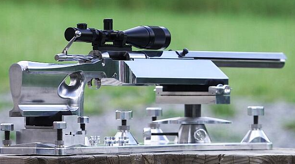

    Heavy Gun Bench rest gets nuts. At least that one has the weight in the shape of a stock.
    The rail guns they don't even bother.
