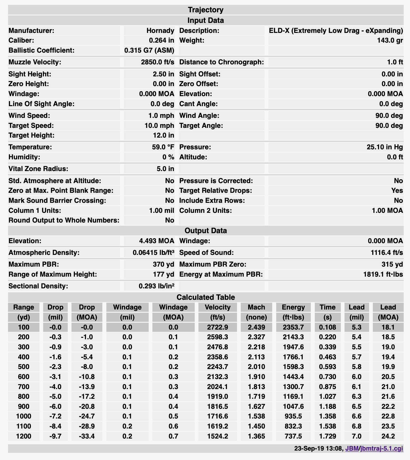

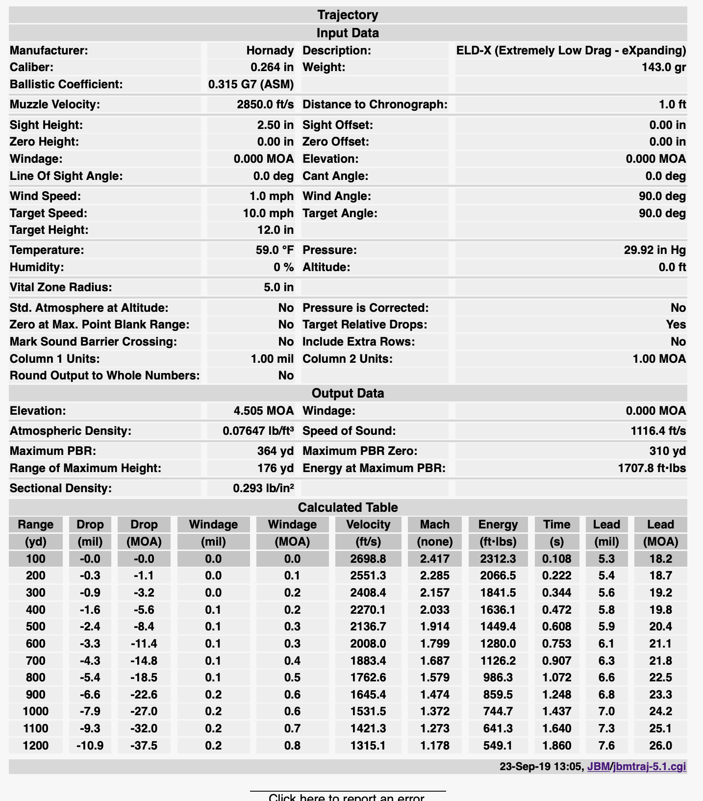

Chew on this if you want to visualize your dope and the what changes in location have,
look at 200-yard data for not only multiple calibers but multiple locations, compared your 200-yard dope with your 800-yard dope and see how it changes, that tells a big part of the tale
Both 200 and 300 are the same
