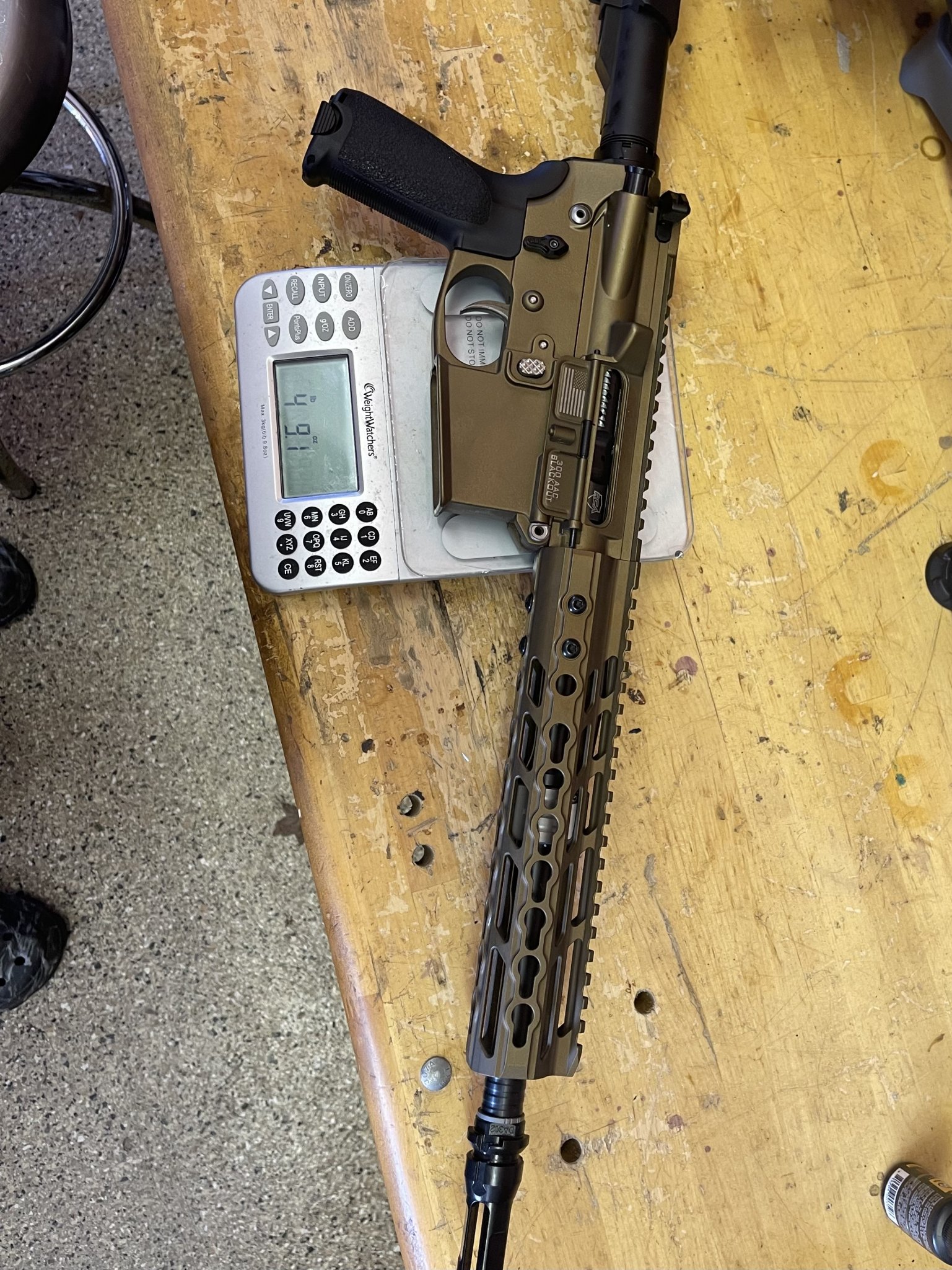

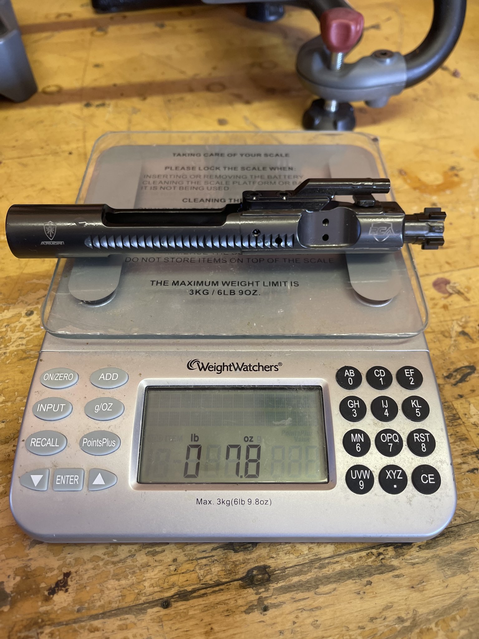

    Wondering how things shaked out with your testing? I have a similar set up as you Faxon 10.5,RCA titanium BGC,SLR adj Ti gas block JP Scs buffer system. Have the riflespeed on a MK12 build I just got done with I’m curious how things shaked out and what buffer weight you are using? Any info or guidance will be appreciated.
    I was using the Odin Works adjustable buffer. I'm now using a different system, the Unrivaled two-stage dead blow competition buffer system. Functions perfectly with supers. I don't use the Hornady subs in it since they don't feed correctly. Bought a Sig Spear LT in 300 blackout for that. Expensive solution.
    I still have the Odin buffer, can weigh it and report back.
