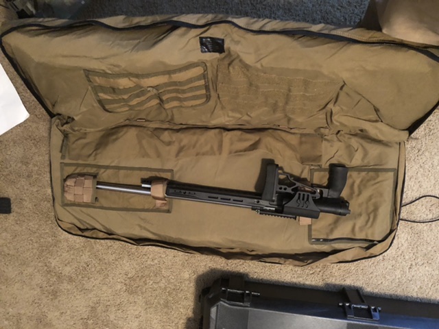

I flipped my XLR folder around for a match where I had to sling the rifle and climb in ladder cages. Hint, look for one that will lock when folded. The XLR will bounce around but got the job done. I kept it a right folder as it was easy to fix in smaller gun cases. Also, I have to keep the origin bolt back or out.
Ha that's actually pretty awesome, I didn't know that the XLR folder could be flipped around. Seems it's just the stock itself that doesn't have a recess for the bolt. Does the folder install fully and locked in either orientation (Left vs right side)? Or did you have to do something like thread lock it in place on the right side?
Yes, being a tube style stock there is no recess for the bolt. It’s kinda hard to explain in words but I’ll try: the male end of the folder are actually two pieces, threads and folder body, with tension screws. This allow you to thread the folder to any orientation then tighten the screws to lock it in place. Plus you have the set screw in the chassis that helps.

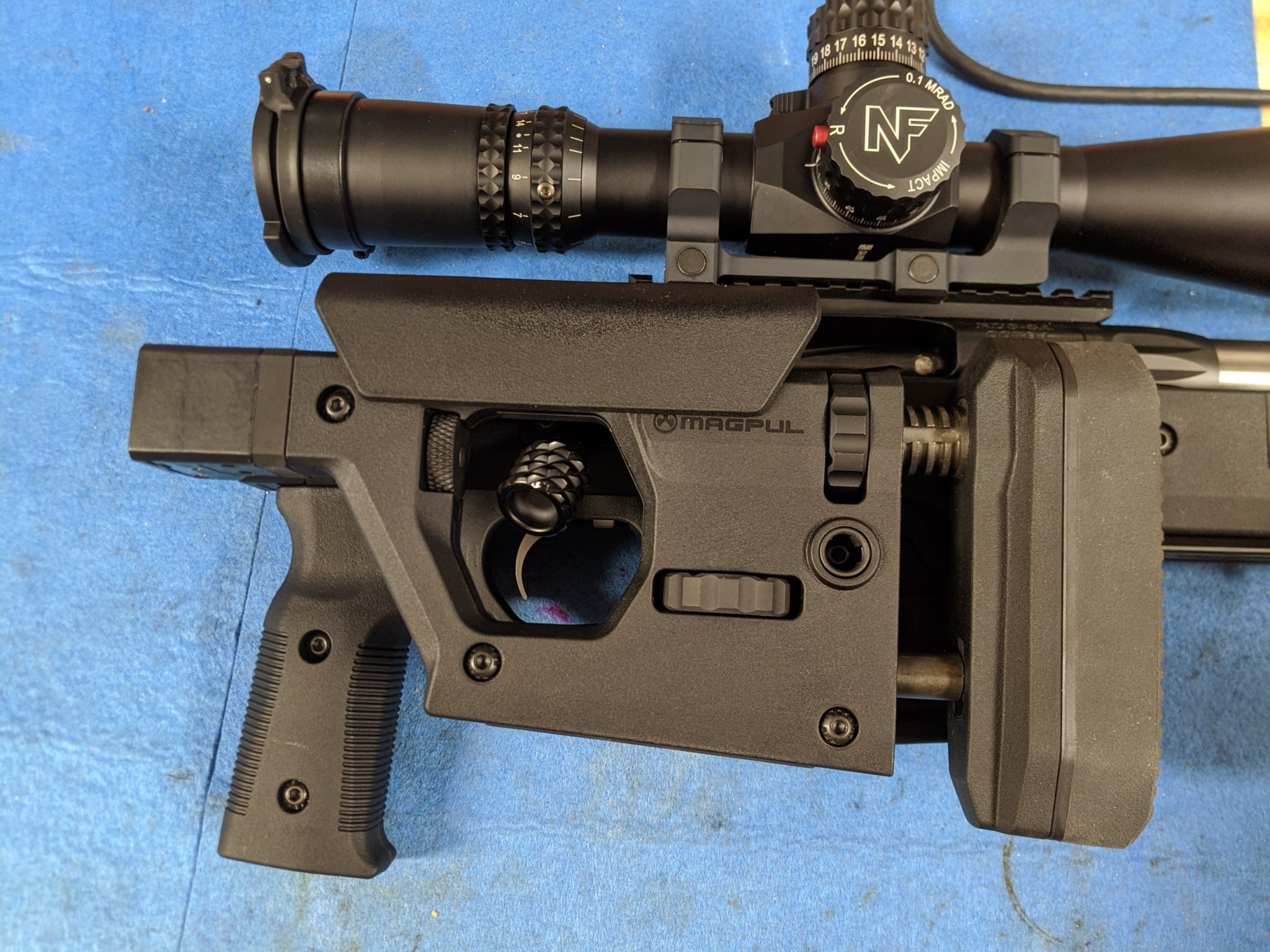

Thanks guys, I had totally forgotten about the Magpul and the Christensen is a new one to me to check out. Still curious if anyone has experience with the Origin's swept handle and the right side folding options?
Yep - the 700 Pro buttstock clears the Origin bolt handle:
